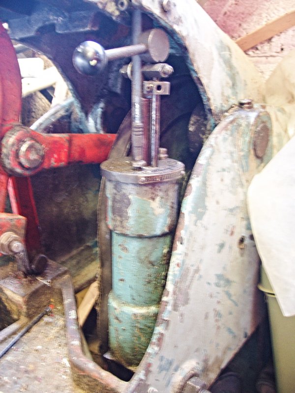

    I've just gotten round to fixing up the Q&S power hacksaw I've had lying around in my workshop for some time since I purchased it as a scrap item from my former employment.
    After fabricating a new motor bedplate it's now resplendent with a single phase motor, new pulley & v belt.
    However, after lowering the blade onto the worKipiece & starting the saw, the hydraulic feed cylinder is jacking the saws frame upwards away from cutting & no matter where I position the the feed operating handle it refuses to lower whilst the motor is running.
    Anybody had experience of this make of saw or better still the operating instructions.
    Thanks in anticipation
    RonA

    I might be really silly here, but are you sure the saw is going the right way? From memory, it should be cutting on the backstroke. Is it single or three phase? Also, that lever twists as well as going up and down doesn't it? again, if memory is working, twisting it sets the rate of drop and up or down ie either up or down. Doubtless someone with better memory than me will be along shortly. Lovely bit of kit when you've got it running properly.

    The thought the motor might be running the wrong way had occurred to me, however the motor shaft/pulley is driving clockwise (as most motors) & in turn driving the first pulley on the saw the same way. Perhaps somebody could confirm this is correct?
    The motor is single phase (as mentioned in my post) & you are right in your comments about the adjustment of feed rate (I have adjusted this from full up to full down, to no good effect) As you mention it is a good solid piece of kit & despite being in use for several decades it is still in good working order (hydraulics excepted). A good purchase for £40 I thought.

    How does the lift setup work? Julian's suggestion sounds like a simple test to start with. Just turn it by hand counter-clockwise for a while and see what happens.

    I've just found a video on YouTube of an identical model in operation & it seems to have a small lever on the lift mechanism that is missing on mine. Will make up a lever (it seems to just screw in) & see what effect that has.

    I made up a little lever, which turns out to be for increasing & decreasing the feed on blade (it fits in the small hole visible in the collar round the shaft, top of the hydraulic lifter, just visible in the photo). However, despite fitting the missing lever & trying every combination of feed setting & hydraulic lift lever, the saw still starts to lift away from the workpiece on commencing cutting. Anybody got any further thoughts/experience on this make of saw. Failing that looks like I'm going to have to remove the cylinder to find out what's going on inside. It has stood a very long time unused so the oil inside may not be in the best of condition.

    I've just had another thought. I'm sure that when those saws went down, eventually something knocks that lever back up so it starts going up again. Looking at the picture, is that an adjusting screw, and can that little metal block be adjusted down away from the cam? It's a bit hard to describe but I have a feeling there may be an adjustment which has either slipped or been adjusted so far that it's constantly in the oops I'm at the bottom and ought to go up position, if that makes any more sense...again!

    You're right there is a vertical (adjustable) knurled rod which, as you say, trips the feed lever, to make the frame go back up. However, it is currently screwed right out of the way, so I don't think that is problem. I've a feeling it's going to need a strip down & clean out of the hydraulic feed cylinder to sort it out. Unless somebody whose used one of these saws can point me at something else

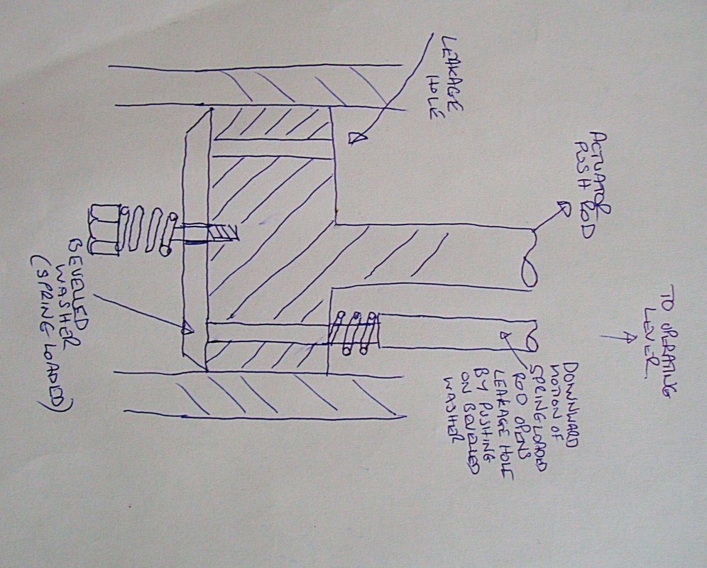

    The good news is that the saw is now working as it should.
    However, it necessitated taking the handraulic cylinder apart to find out what was really going on.
    The problem turned out to be that the beveled washer on the bottom of the piston was not opening when the lever was operated to lower the saw frame. I've added a little diagram to illustrate how it all works. The small spring load rod which pushes the beveled washer & allows hydraulic fluid to leave through the piston (allowing the piston to lower) was not doing so, hence the saw arm was being pushed upward all the time. The operating rod screws onto the operating lever at the other end & had been screwed up to much( by whom remains a mystery, perhaps that why they decided to sell it for scrap) , resulting in the operating lever not opening the beveled washer. Now after a simple adjustment the rod is pushed in far enough & the saw frame descends as it's supposed to do.
    Many thanks for all those who contributed suggestions, it was a culmination of the excellent help which led me to the final resolving of the problem.

    If that damper diagram is correct, just use an engine oil in there. You have a good amount of control over flow, and engine oil, (something like a 10/40), works fine in similar setups I have here.
