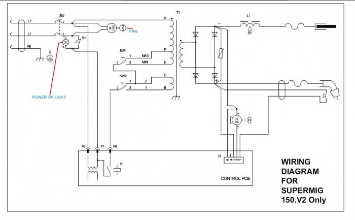

Hi, just dug out my old welder & I'm new to the forum.
The wire feed does not seem to work, relay clicks over & the motor spins a tiny bit as if the motor is siezed!
I managed to make the motor run for a bit & adjusted the feed speed, then next time I tried it was back to not working!
Attached the motor to a 12v battery & it runs fine. Changed the wires to the torch for new ones & it's still the same.
Little bit baffled. If anyone has got a wiring diagram or some advice that would be much appreciated!
Cheers
Craig
