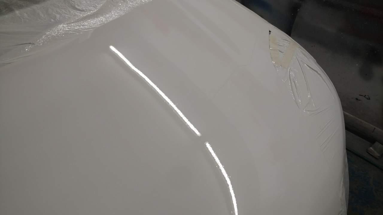

Hi guys, need some help with this one!
Think I may have sprayed 2k direct gloss (un-hardened) thinking it was polyester basecoat... I thinned it 1:1.... I never use 2k DG or coloured 2k, I reckon my paint supplier give me the wrong tin.
Very strong smelling, burns your nose when you take a whiff compared to ordinary polyester basecoat, that is why I'm thinking they gave me 2k DG....

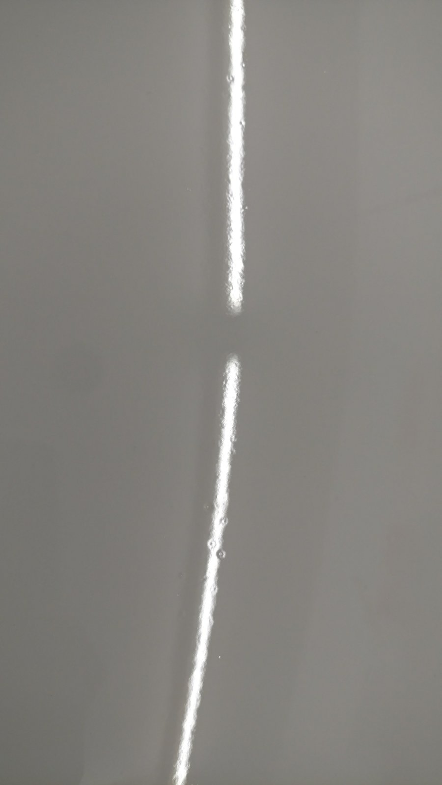

The issue I got now (after spraying the lacquer) is 1000s of dotted craters, looks like dust but obviously not dust got to be some sort of chemical reaction.
Its dawning on me now that when I sprayed the base, it did not go dull like I usually get with basecoat flashing off.
Cheers for any help, I know I'll probably have to take it all off and start again.
