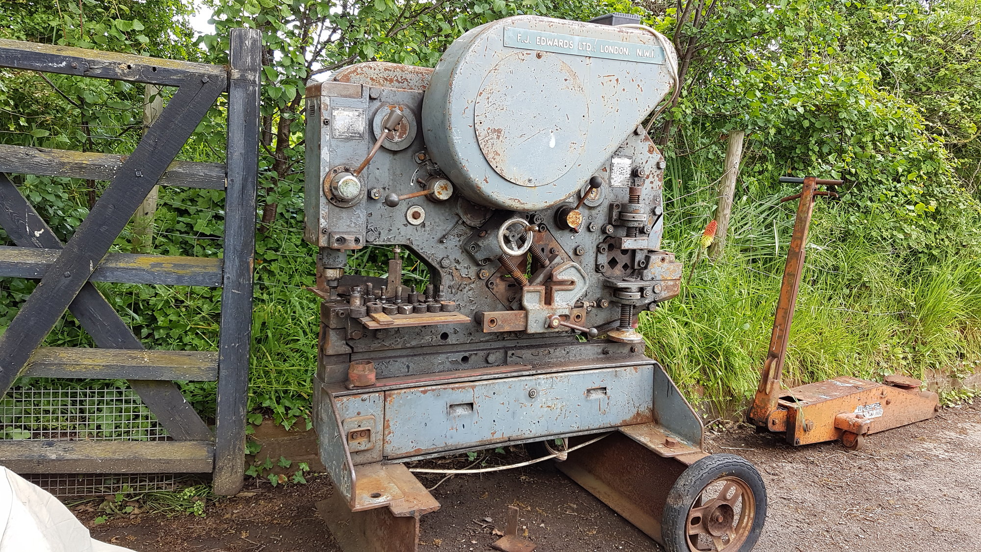

Only used Pels, Gika and Kingsland, If it is seriously cheap and single phase I would take a chance on it, you’ll get your money back no problem if you go to sell it further down the line (easier if it’s single phase), ironwokers are a bit like lathes and mills, they command higher money if they are well tooled, if you don’t buy it you may regret it...Anybody had any first hand experience of these ? Particularly the P50 model ?
Ive seen one for sale at a good price including the press brake attachment .
I believe they are American made , and look pretty useful on the you tube videos ive seen
I guess thats the million dollar question (no pun intended). Ill have a look to see who supports them in the uk.Is the tooling easy enough to source?
https://www.msmpunchpro.co.uk/piranha-toolingI guess thats the million dollar question (no pun intended). Ill have a look to see who supports them in the uk.

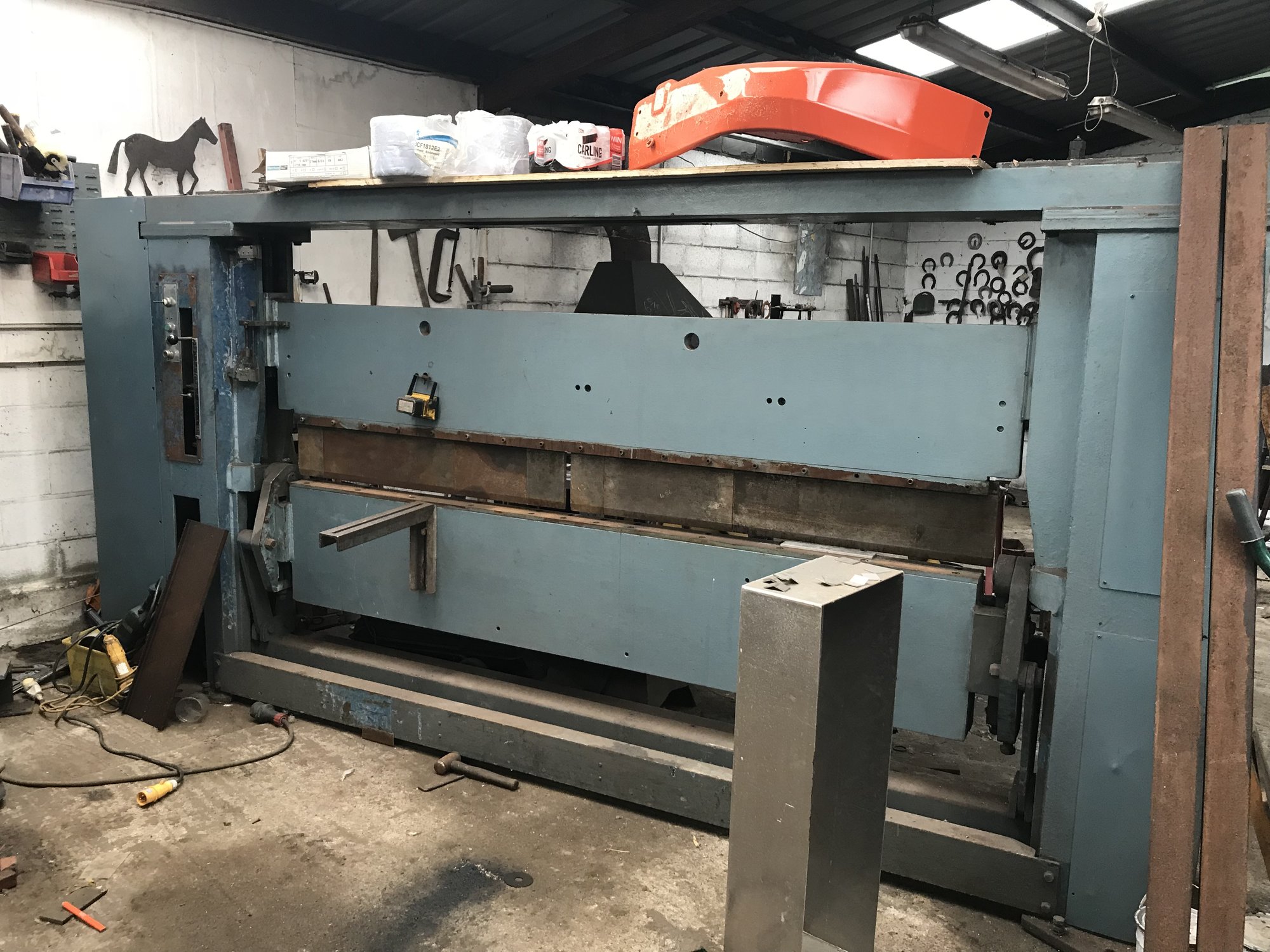

What do you call a full size pressbrake?
Main reliability problems are caused by the safety guard electrics.
My big edwards split a hydraulic pump, though it was a forty something year old aluminium body dowty pump.
Theres a 200 ton pearson on ebay which ive got the horn for but the dismantling and moving costs from cornwall will be terrifying!

I’ve got this for sale currently. It’s a keetona Hydroform.
⅛” over 100”Hi Brad, what will that do capacity wise ?
Thickness/ length etc
