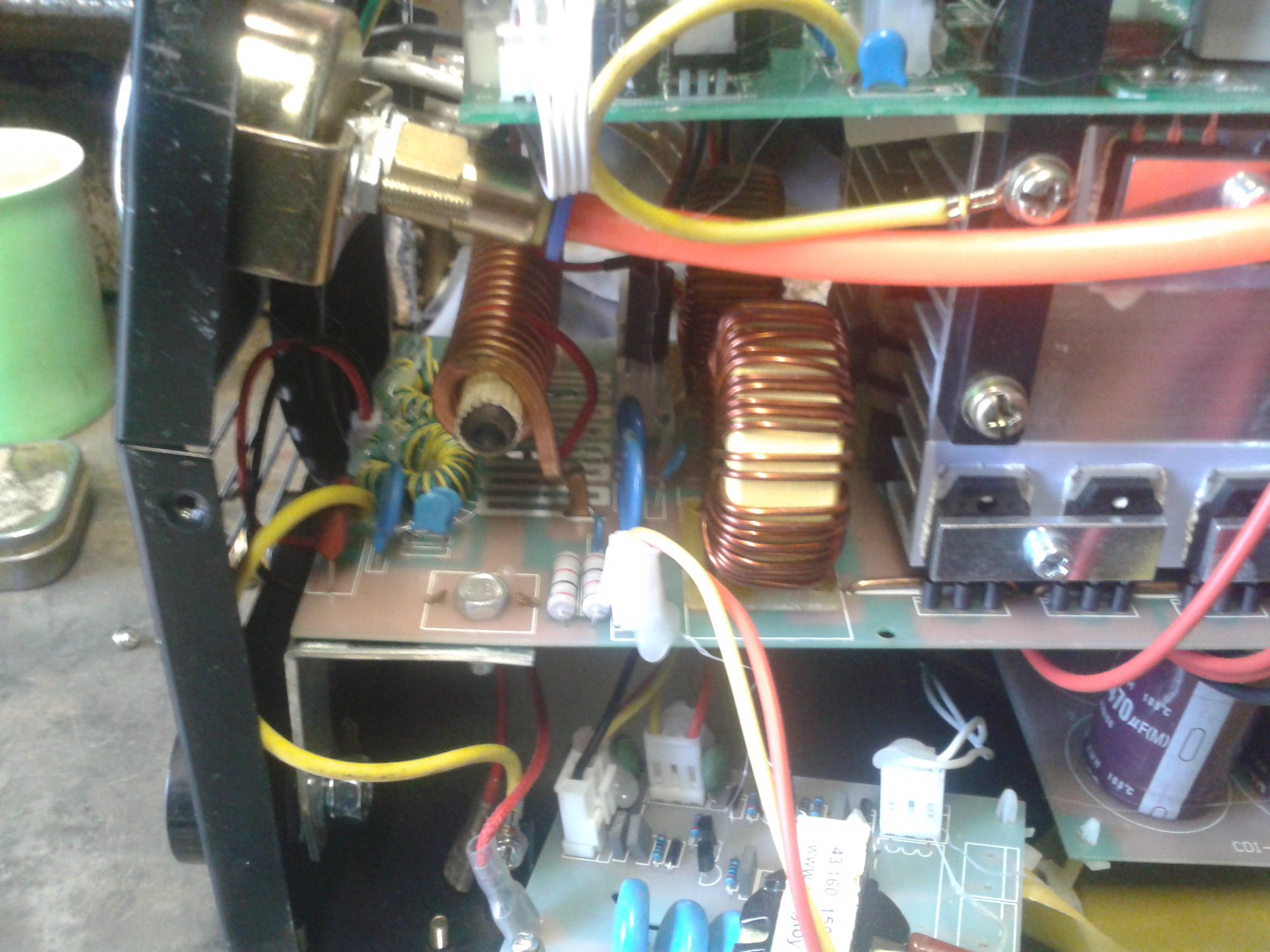

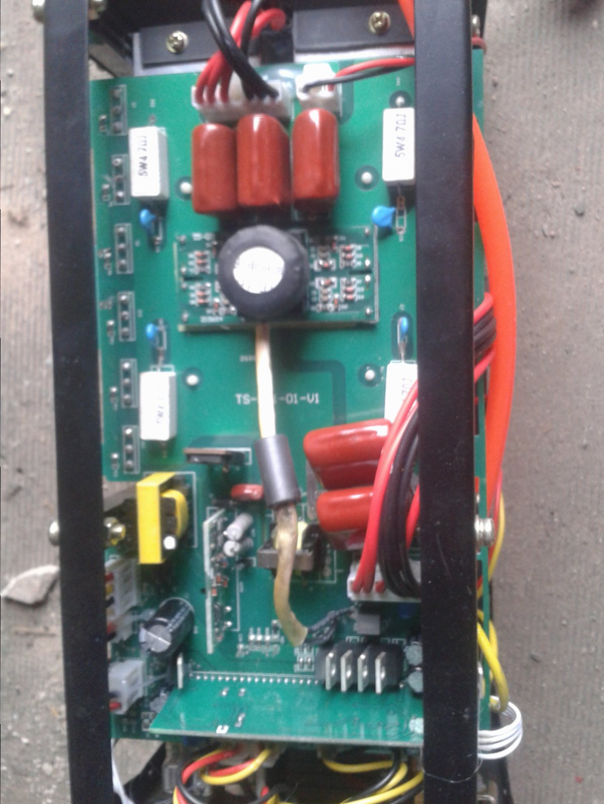

and here's what the inside looks like
it doesnt really show it in that picture but it looks like every cable connector is held together with glue from a hot glue gun.

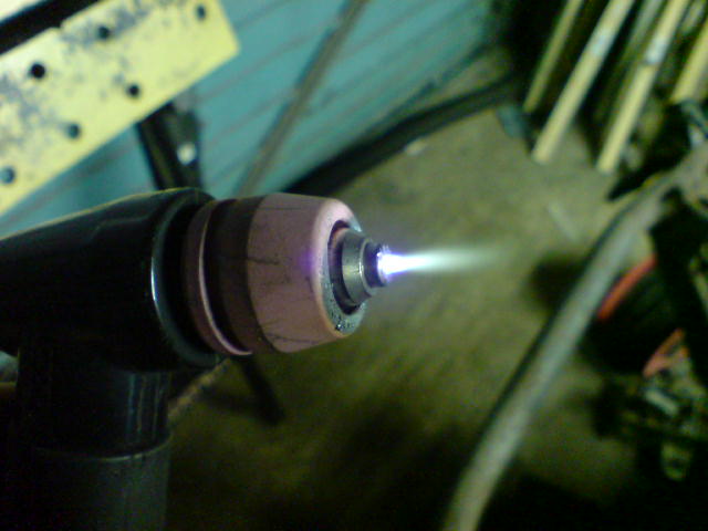

and this is the pilot arc in operation
and the torch supplied is an AG60 torch, so consumables are readily available (on ebay at least).
it seems to work fine at 35A from a 13A plug, but blows fuses at 40A, so I started play with it set to 35amps. I did try with air pressures from 50psi to 70psi and found it was miles better at 50psi. at 70psi, its like the plasma was blown out and it would only work intermitantly, so reducing the pressure seemed to make it work better too. at 70psi it was struggling to cut 4mm thick steel but at 50psi it was cutting through 6mm steel.
I only really planned to get it for use for cutting metal upto 3mm thick, including rough cutting 0.9mm sheet steel before final trimming with some snips. the standard nozzle is 1.2mm wide for use upto 60 amps, so I've ordered some 0.9mm nozzles for upto 40 amps, so may produce a better cut on thinner section metal, but only time will tell.

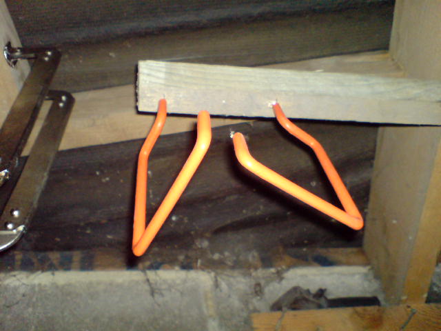

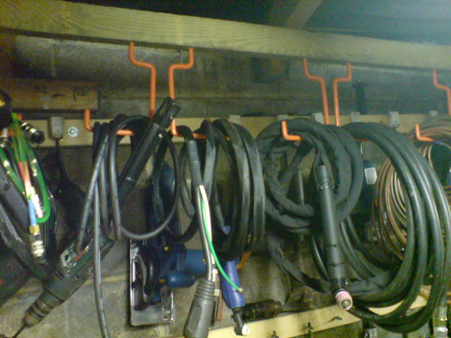

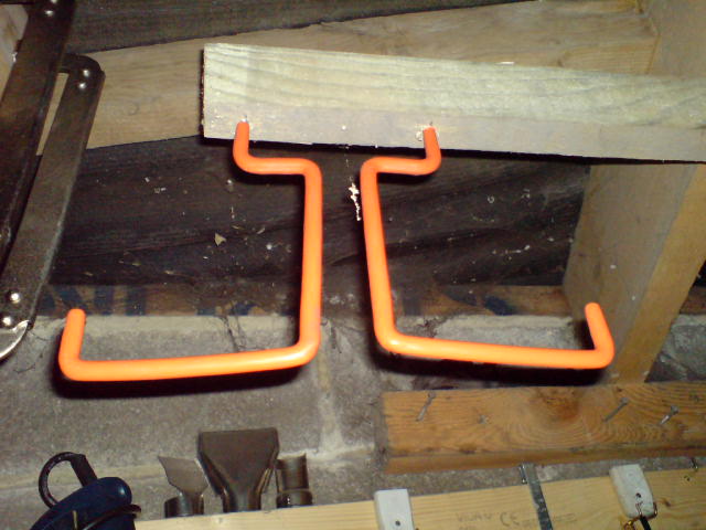

slightly off topic, but I was getting fed up with the number of hoses and cables I have, so I ended up screwing some large hooks into a beam in the roof of my garage, now they are easy to get to without getting tangled up. wish I'd done that years ago.
