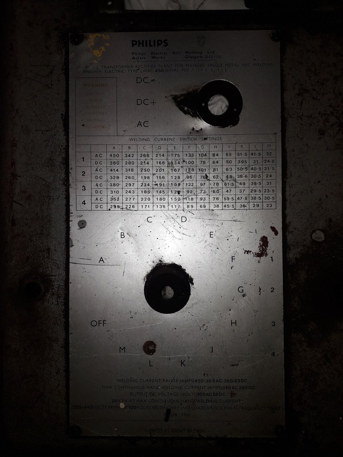

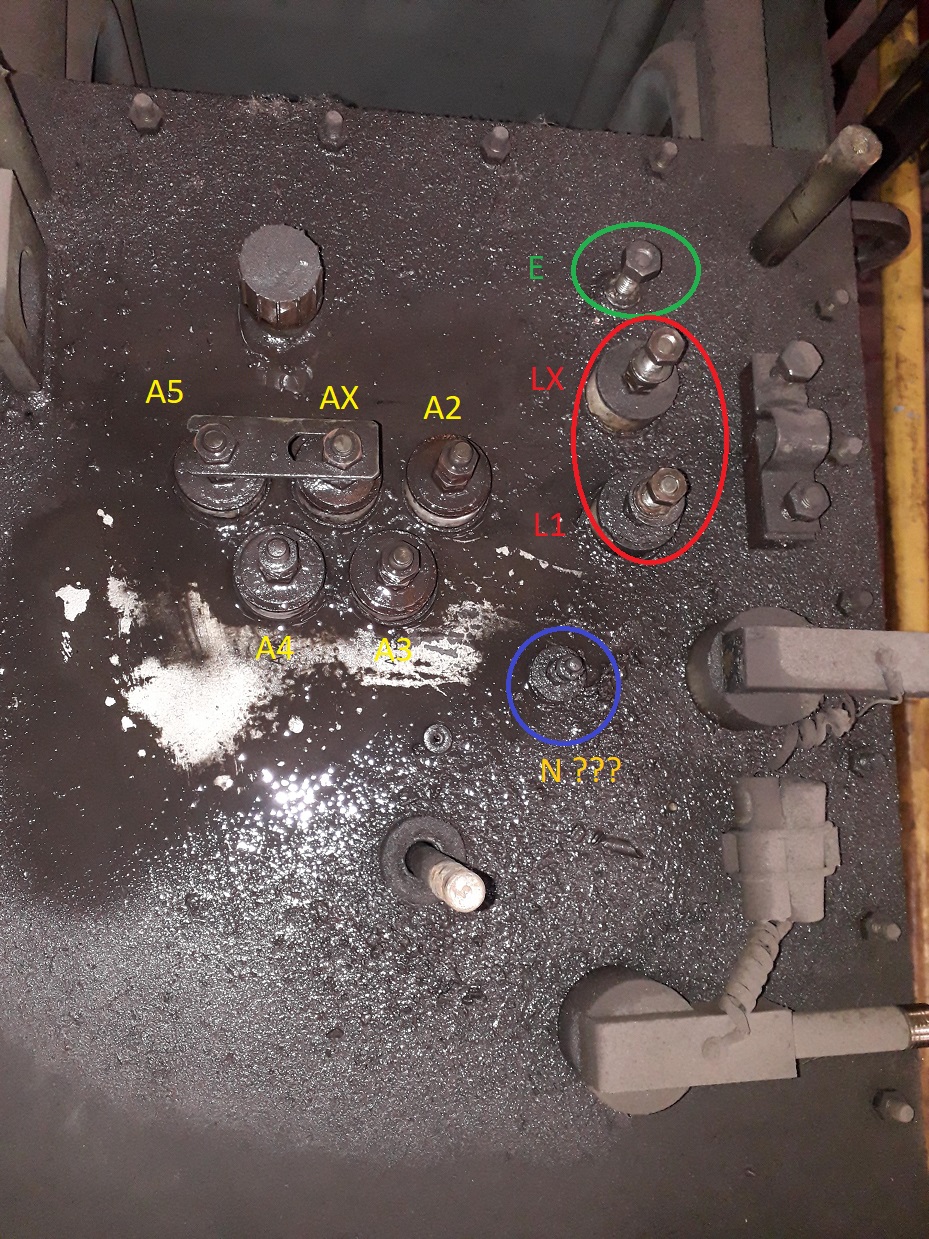

Hi Guys,
This thing must've been used building the Titanic it's so old, See attached Pics.
Does anyone know the function of the 'AX, A2, A3, A4, A5 selectors??
and
I'm assuming that L1 and LX are for running it off two phases of a three phase power supply, but does the presence of the pin circled in blue mean that it'll run on a single phase 240(32A) supply??
Any help greatly appreciated, I'm told that before the power cable was removed (it had been cut through by accident) the welder was working fine.
