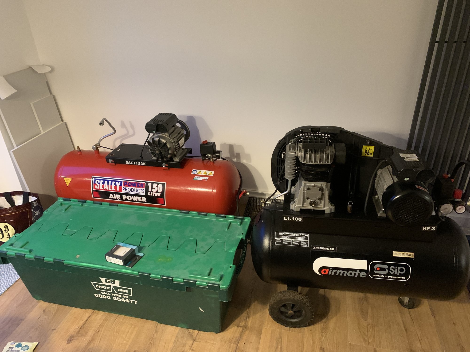

so... I’m on a domestic electricity supply and so far I have a nice Fiac 14CFM 3hp belt-driven compressor at 14CFM (not FAD), filling a 150 litre tank. Being a bit on the small side, I’m topping this up with a second 14CFM pump and motor that will kick in at a lower pressure.
Both air supplies will be plumbed into 22mm copper pipe, via a PCL 100 whip hose and will eventually be displacing 28CFM (somewhere around 18-20CFM FAD), feeding a generic Chinese blast cabinet like this:

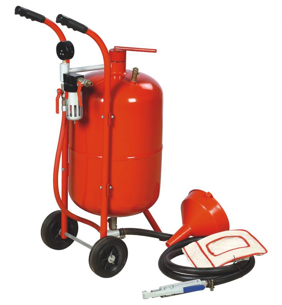

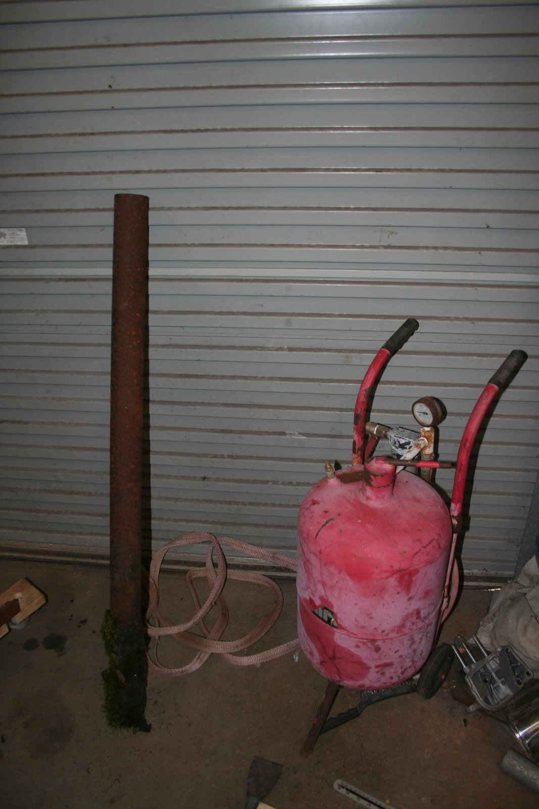

then - I revisit the gun... and my questions start:
1) would it be best, given my small setup to stick with the suction setup above or instead move to useing an eBay pressure pot like this?
Obviously, I’d be binning the standard valve and would use the 3mm tungsten nozzle shovelled into the pipe with a jubilee clamp.
2) if so, is it best to go for 10litres or 20?
3) if I do go for a pot, and wish to keep the foot pedal - is that possible.
4) again if I go for the pot, where would the metering valve come in? Does it go on the bottom of the pot - and if so, is it a case of letting the media build up into the cabinet and emptying it regularly or is there a way of recirculating it?
5) again with the pot, is the t-shaped off the shelf metering valve still a good idea, or would I be better following brightspark’s lovely clemco-copy flat-valve? (I do have a small lathe and can cast aluminium too).
