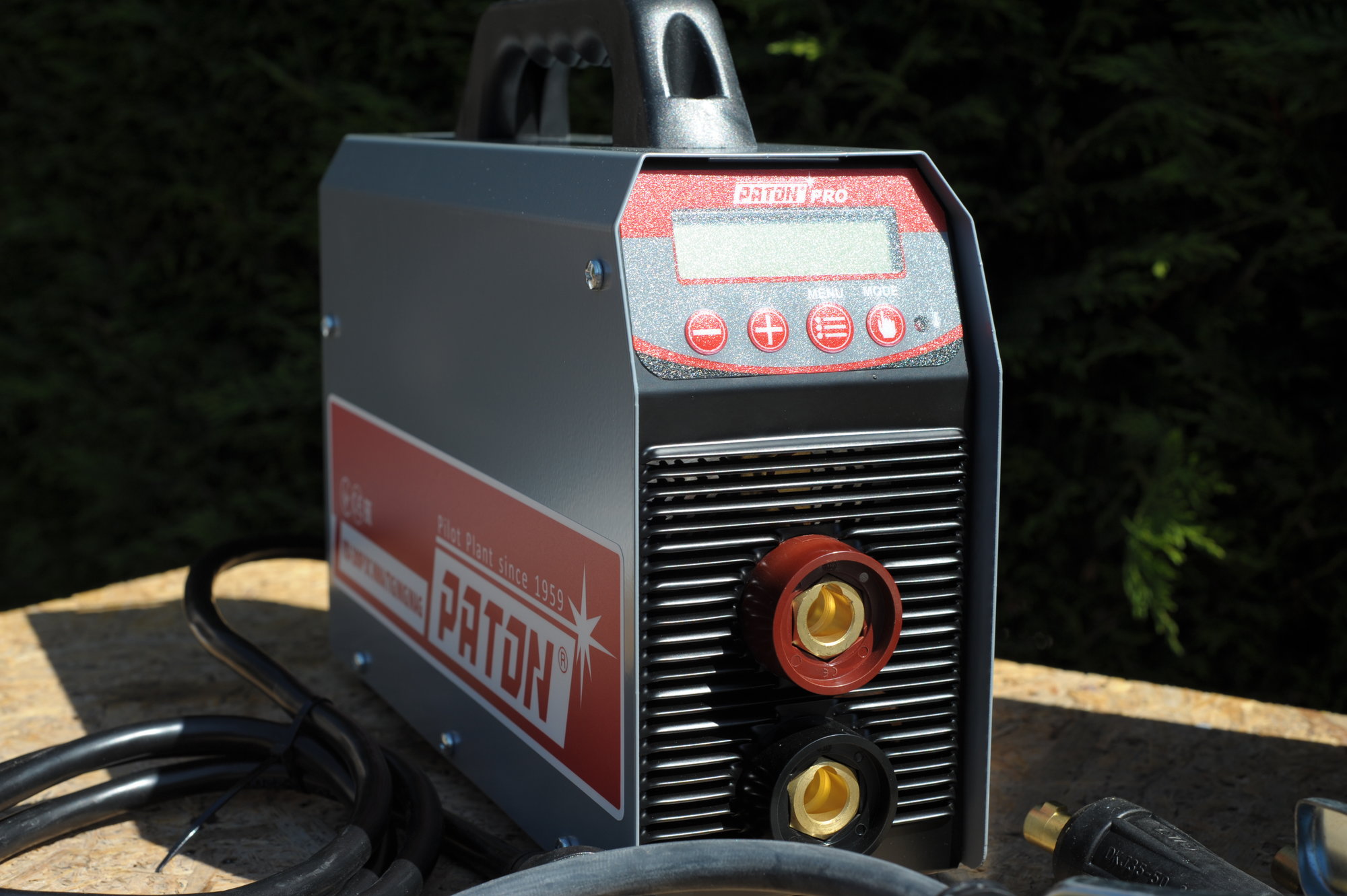

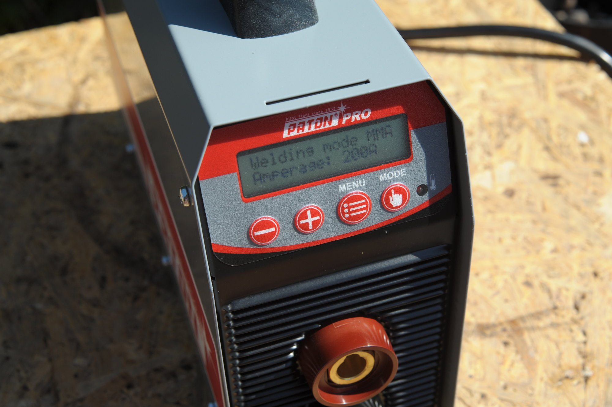

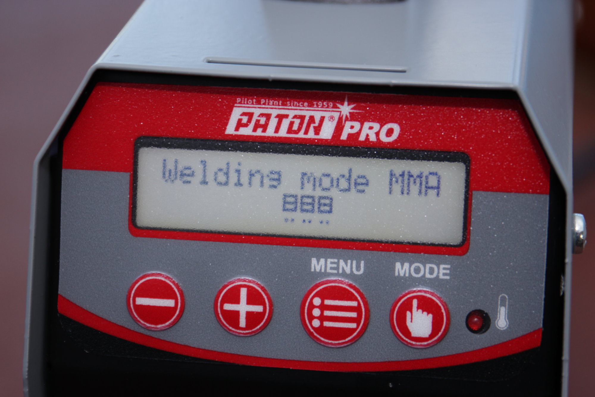

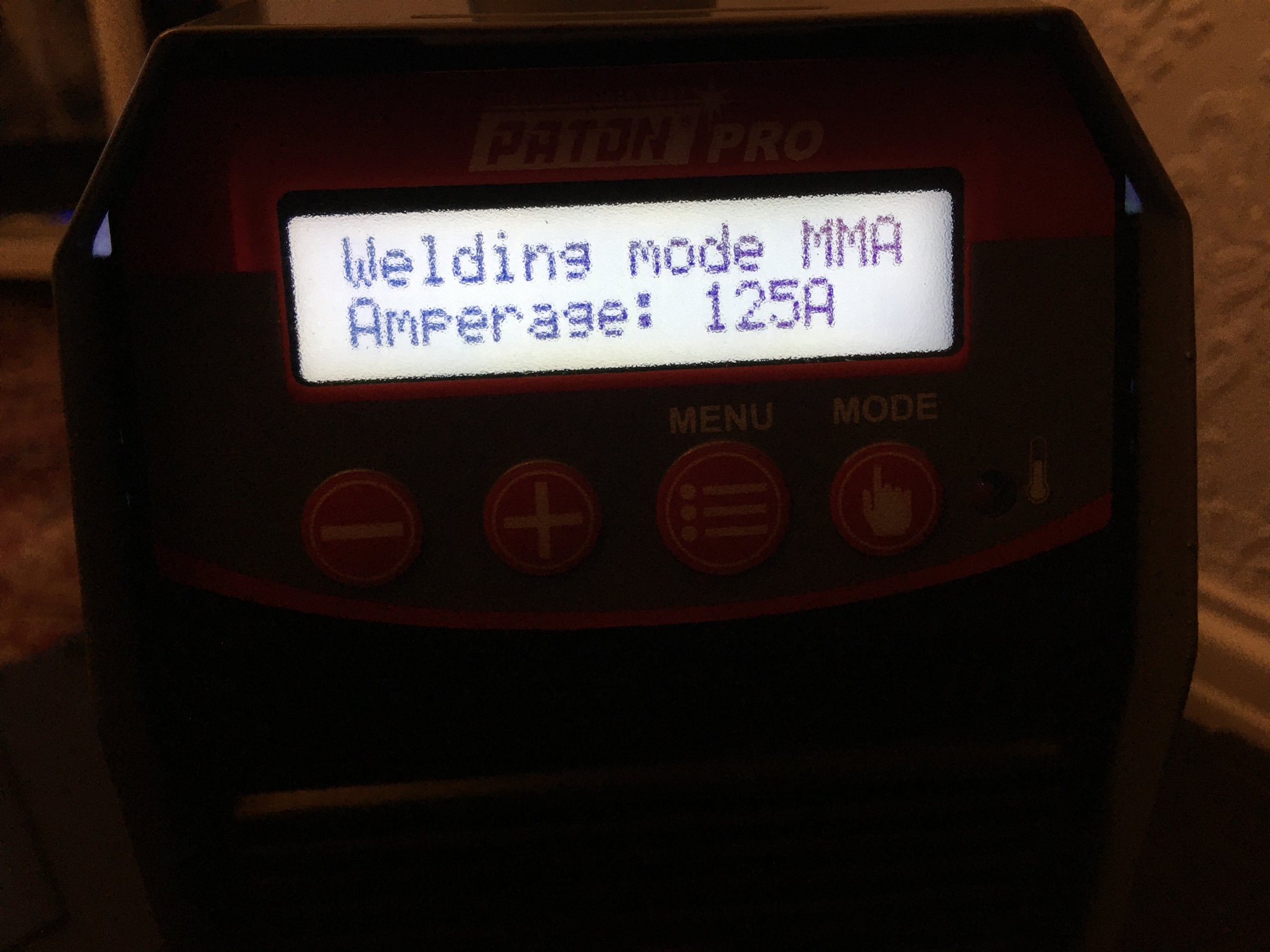

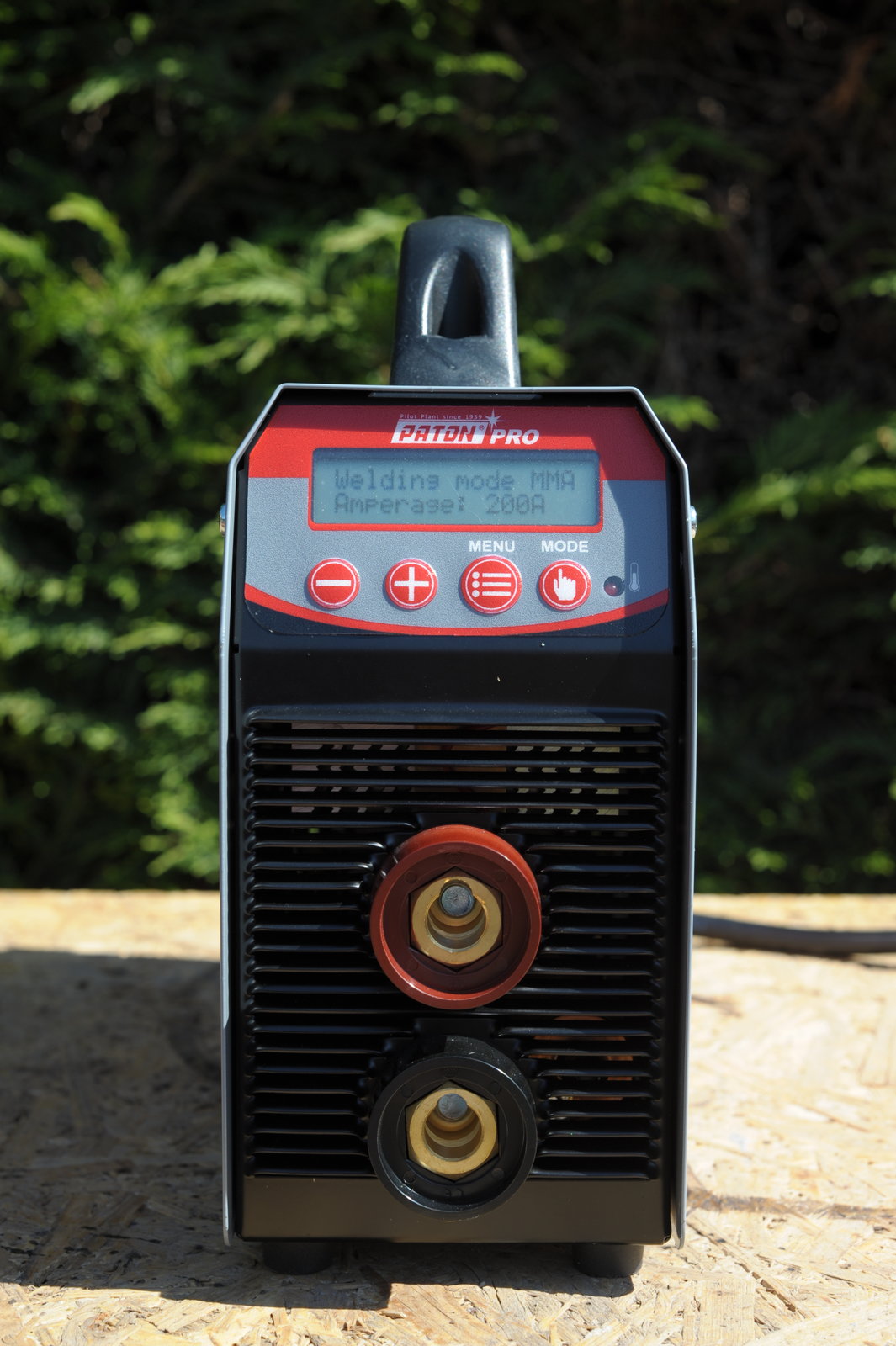

There is something 'odd' about the 'Menu' button. It doesn't work initially - pressing it once does not do anything. However, if you press it for seven seconds the screen flicks to strange characters/another language (maybe?). Then if you press the 'Menu' button for another seven seconds it flicks back to normal. And then (finally!) when you press the 'Menu' button works with one press and you can access the options for MMA - arc force, hot start, pulse, etc. If you switch it off and back on you have to do it all again.
Weird!
You hold the menu button down for seven secs to gain access, that is correct. The characters displayed are the short abbreviations for the settings you are changing. I will upload the English manual for you.There is something 'odd' about the 'Menu' button. It doesn't work initially - pressing it once does not do anything. However, if you press it for seven seconds the screen flicks to strange characters/another language (maybe?). Then if you press the 'Menu' button for another seven seconds it flicks back to normal. And then (finally!) when you press the 'Menu' button works with one press and you can access the options for MMA - arc force, hot start, pulse, etc. If you switch it off and back on you have to do it all again.
Weird!
I don't have a machine with LCD display, mine is an early one with seven segment LED. My menu button doesn't show the bug you have found.@HughF thanks! Seven seconds - good to have it confirmed.
I could be getting it wrong but I think there could be a slight bug in the menu operation. If you don't hold the 'Menu' button down long enough it gets 'stuck'. It hasn't crashed or anything; but you have to press and hold the 'Menu' button for longer to get out of the glitch. It just seems a bit picky about how long that button needs to be held down - or maybe it's me!
