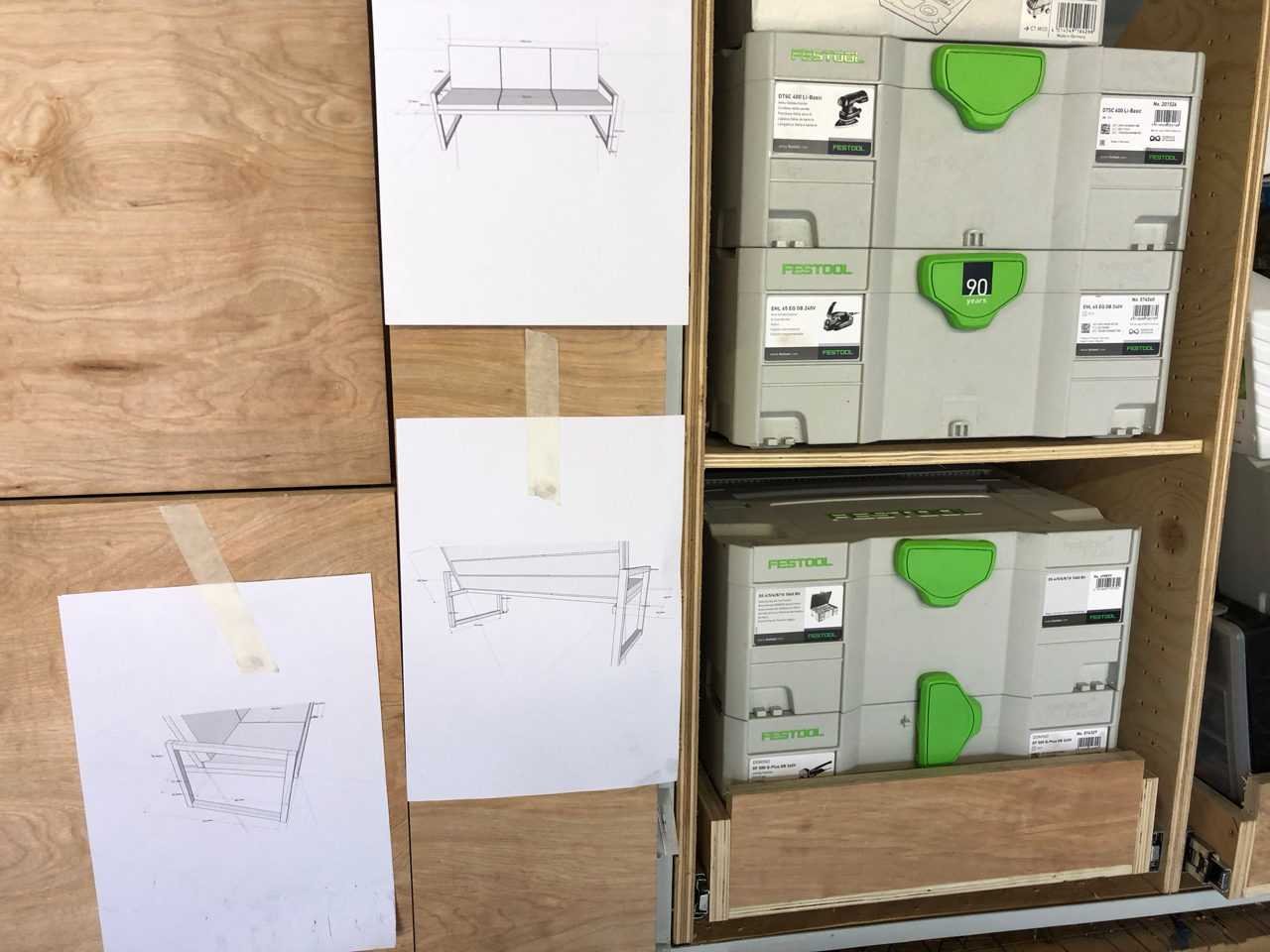

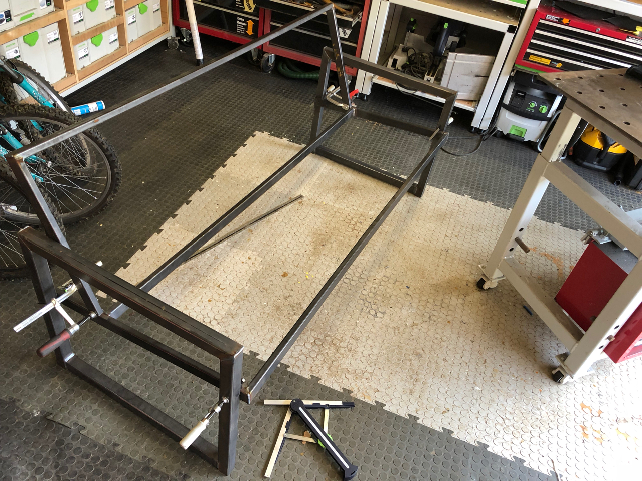

    I worked out a sketchUp of a 3 seater based on the cushion sizes we ordered using 40x40 square for the sides and 40x20 for the seat and back. Metal order for metal hub came to £65 for enough steel to make a 3 seater, 2 seater and chair. I had today to myself so thought I would crack on.
    Actually printed the design to stop me making it up, was determined to stick to it for once:laughing:

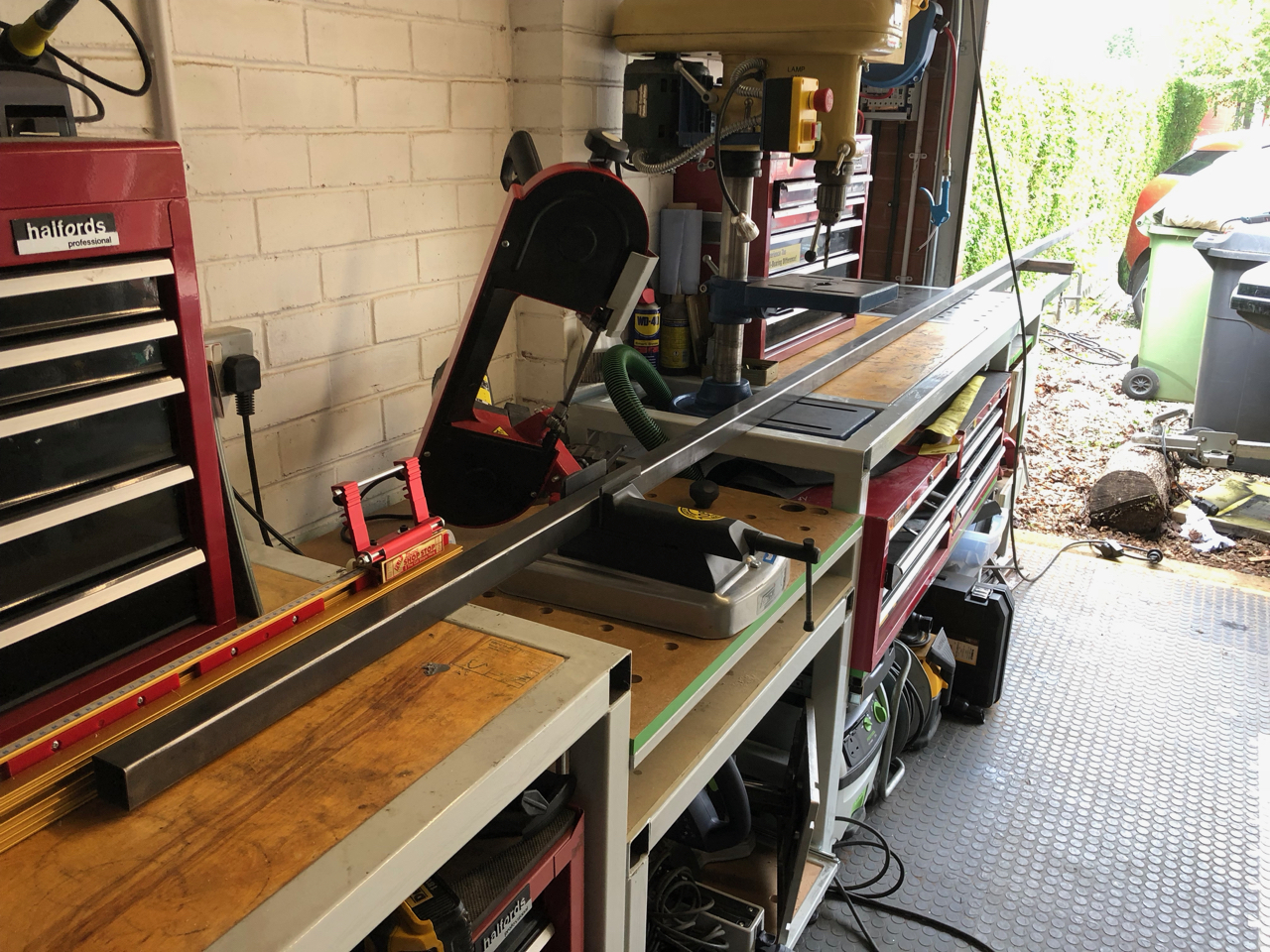

    Cutting up using my new Flip stop fence proved very useful for repeat cuts

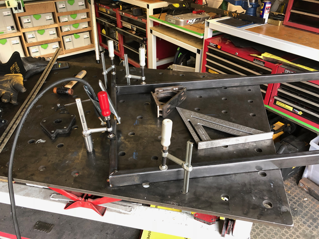

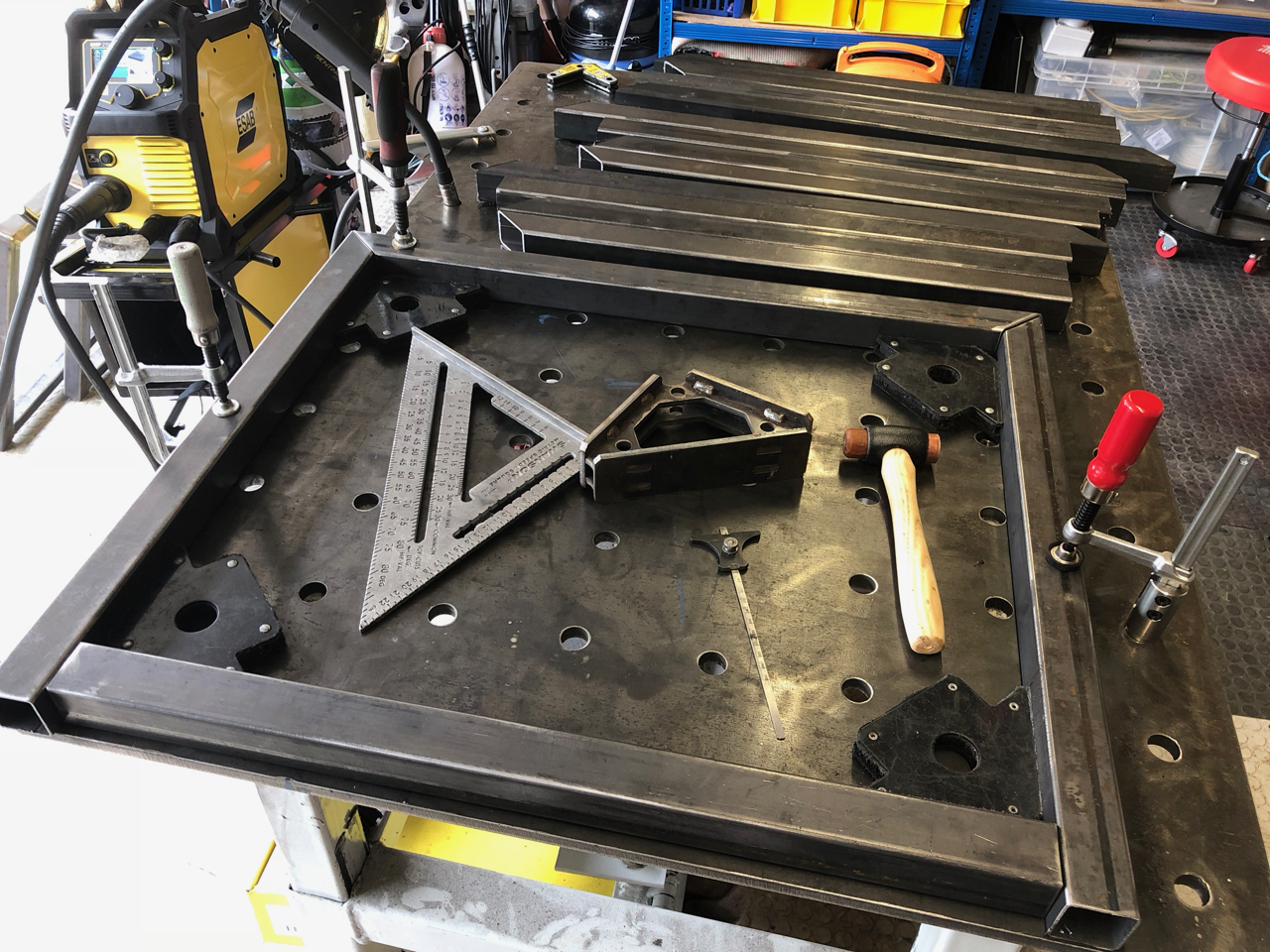

    Got x6 sides, 3 seater base and back all welded up

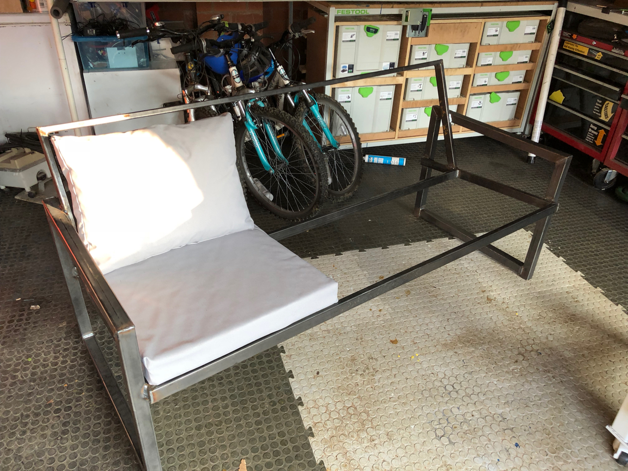

    I did play with the angle of the back a bit
    then welded it all up and tested the cushions

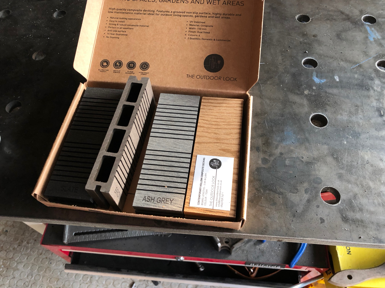

    I'm going to use composite decking for the seat and back, looking for something low maintenance
    next job flatten all the outside welds on the 3 seater and add a mid brace to the base and back then make the 2 seater and chair. Mrs RDR still deciding on the colour for the metal if she doesn't make her mind up soon it will be black or Festool grey :laughing:

    Certainly looks the business :thumbup:
    If it was mine I would put some sacrificial pads on the bases, they would prevent damage to the paint when moved around and probably wood on the arm rests...but that's just me and we all differ with designs.

    For the base the legs protrude 10mm and will have plastic inserts in when finished so hopefully won't rock and the base shouldn't get scuffed up on the patio. Great minds think alike re the arm rests :laughing: I suggested to Mrs RDR some wood on top of the arms rounded over, the jury is out though as she wants to see how it turns out first - it would be an easy addition and personally I have an idea for some kind of wider arm/table with cup holder that slips on the arms when entertaining.

    Looks good, have you thought about square mesh for the back and seat? I guess the benefit of the composite material is you could sit on it without cushions if needed.

    @armalites we want to be able to use them occasionally without getting the cushions out hence the idea behind the composite decking. I like doing jobs like this for Mrs RDR it scores major brownie points and justifies my tool purchases :laughing: I want a lathe next so if I can keep this build under £300 it obviously justifies at least £2k on a lathe when you offset it against the retail of her chosen design :laughing:

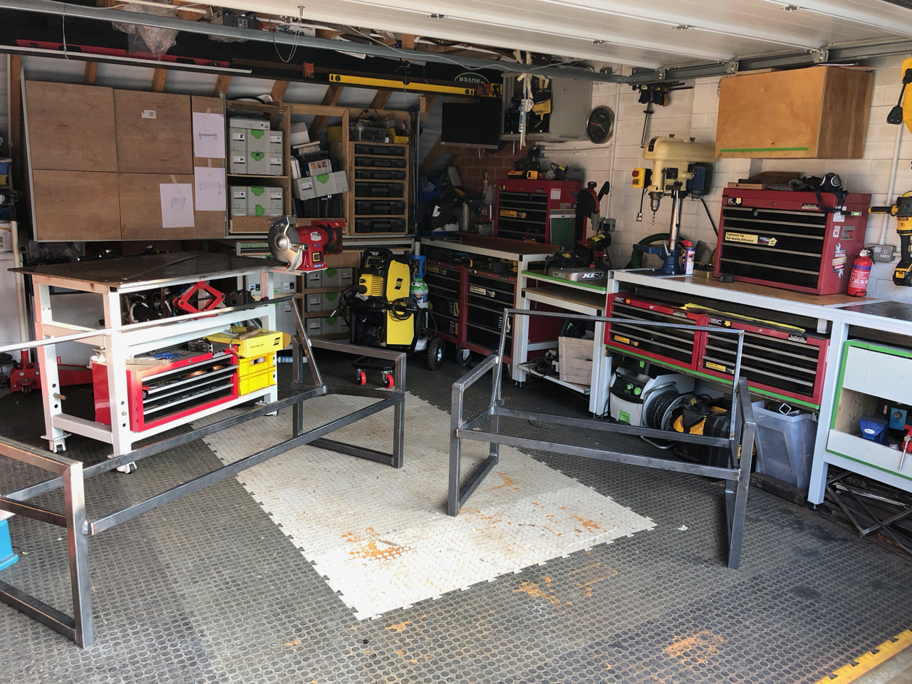

    Had an hour today, managed to get the two seater welded up, realised when cutting the back i had miscalculated the steel and will be short for the single chair by 2m :doh: know a place in Sheffield ill be passing tomorrow that might be open.
