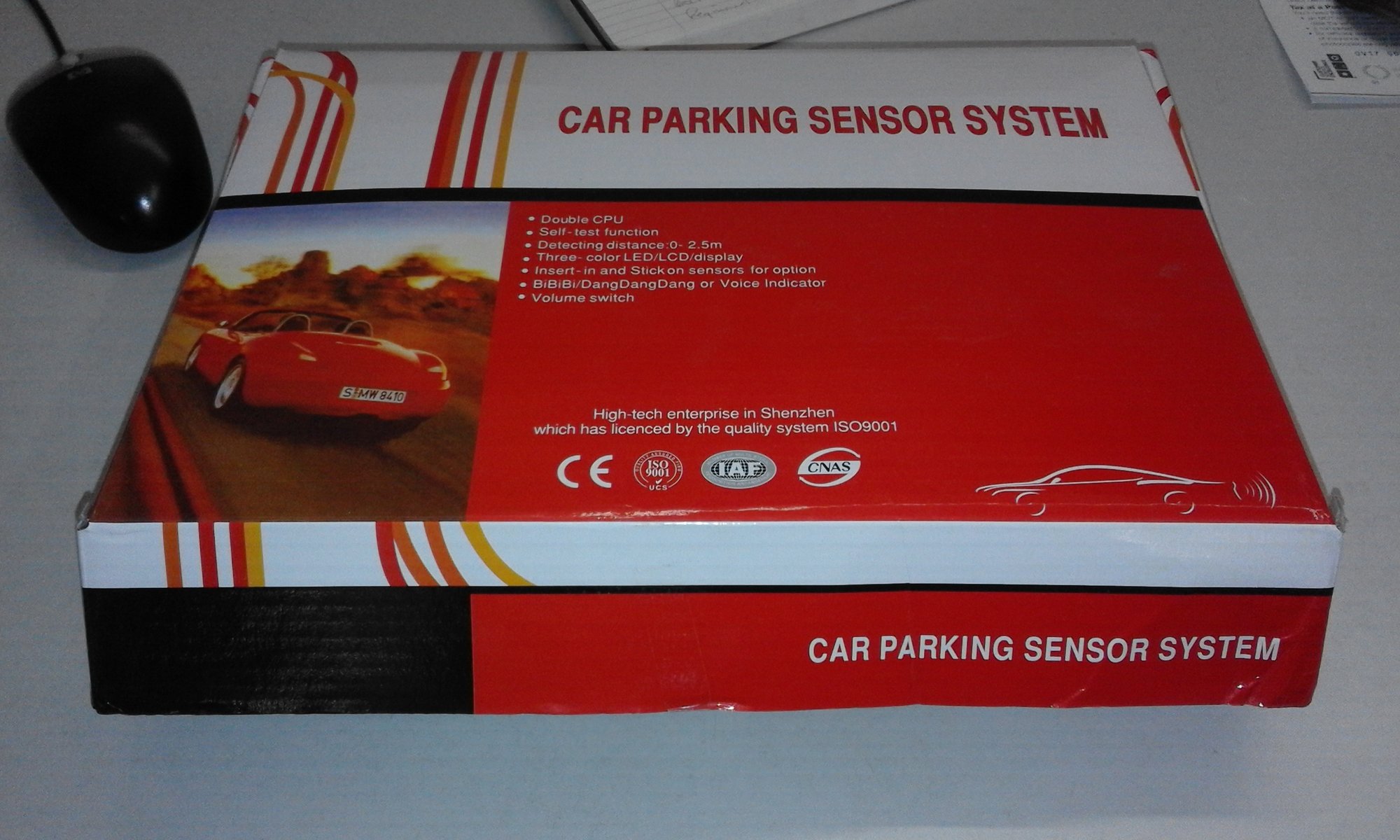

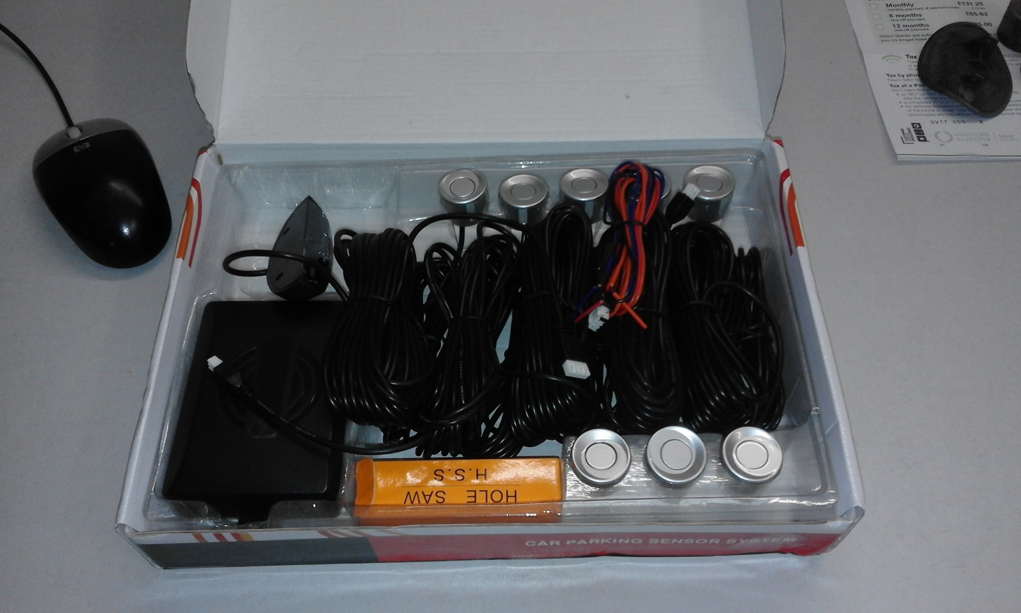

Quick ebay search has the answer-
Wiring:
Red wire to the ACC/ignition
Yellow wire to reversing lamp positive
Blue wire to foot brake lamp positive
Black wire to ground
From https://www.ebay.co.uk/itm/Silver-F...king-Kit-LED-Buzzer-Alarm-Switch/273783257002
