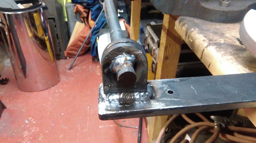

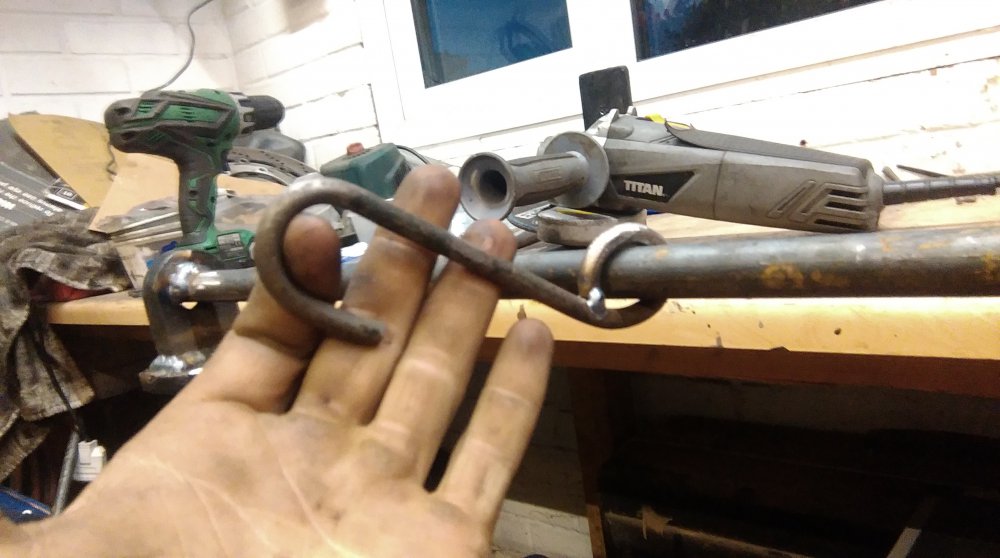

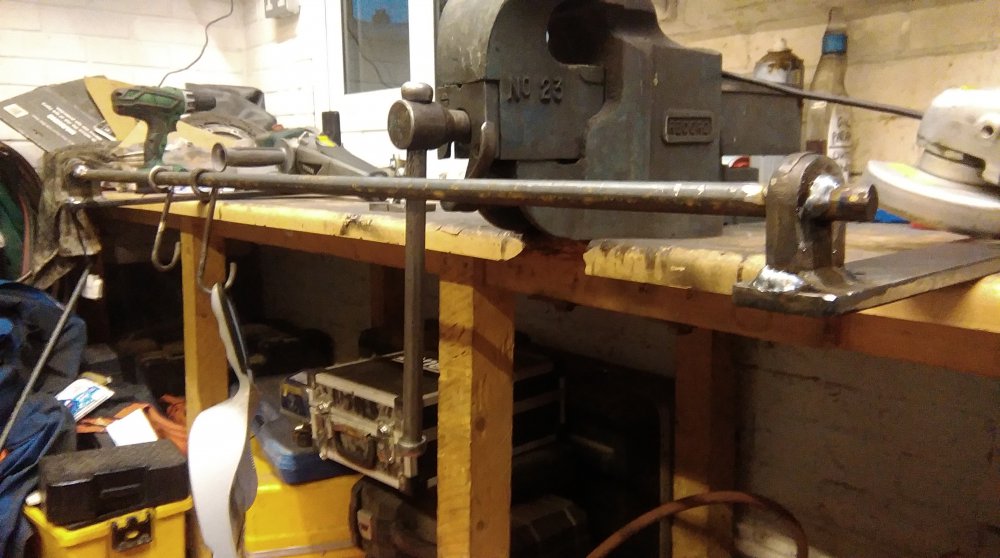

Well I ended up finishing this off for a guy at work. It's to go in his house and I just couldn't let the peigion poo be left ive tried to educate him but he is not interested probably because im 20 years younger ,so I took it home ground the welds out and welded it up and made him a jig for the hooks.

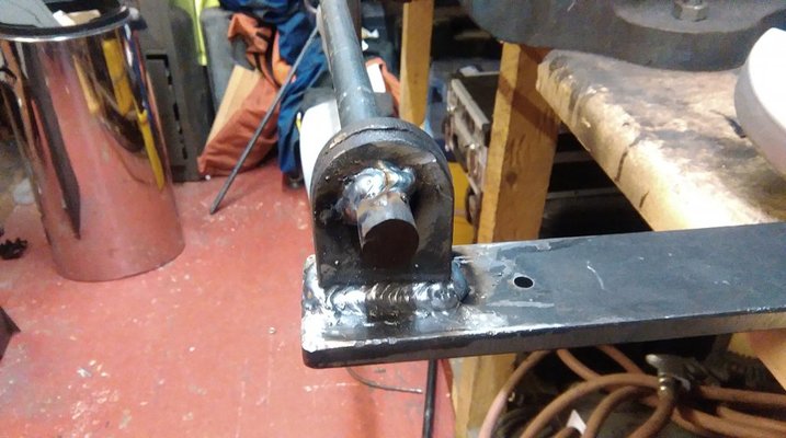

The welds look a bit cold but the poor 120 (now cleaned and welding like a trooper) isn't made for such heavy gauge. I chamfered the joins and built up the weld with one last wide pass to cover it and make it tidy.
