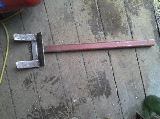

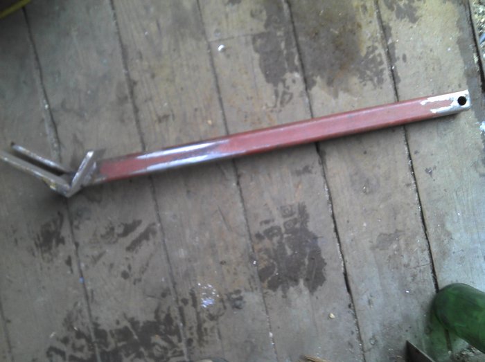

Simple to knock one up heres mine i made ages ago 600mm long 90mm between the forks,make these long enough to get under the whole board,if i need any more omffff i slip a pole over the end,comes also handy for upping floorboards to
We made one like the one shown with a bit more on the back like a rocker to give more leverage. It was at a factory where we repaired a fair few pallets and it did a good job. The pallet nails are very tenacious so if you rush they split the boards anyway. We had some pallets in once made from dark wood and I salvaged some boards from them which when sanded were just like (probably were) mahogany.
