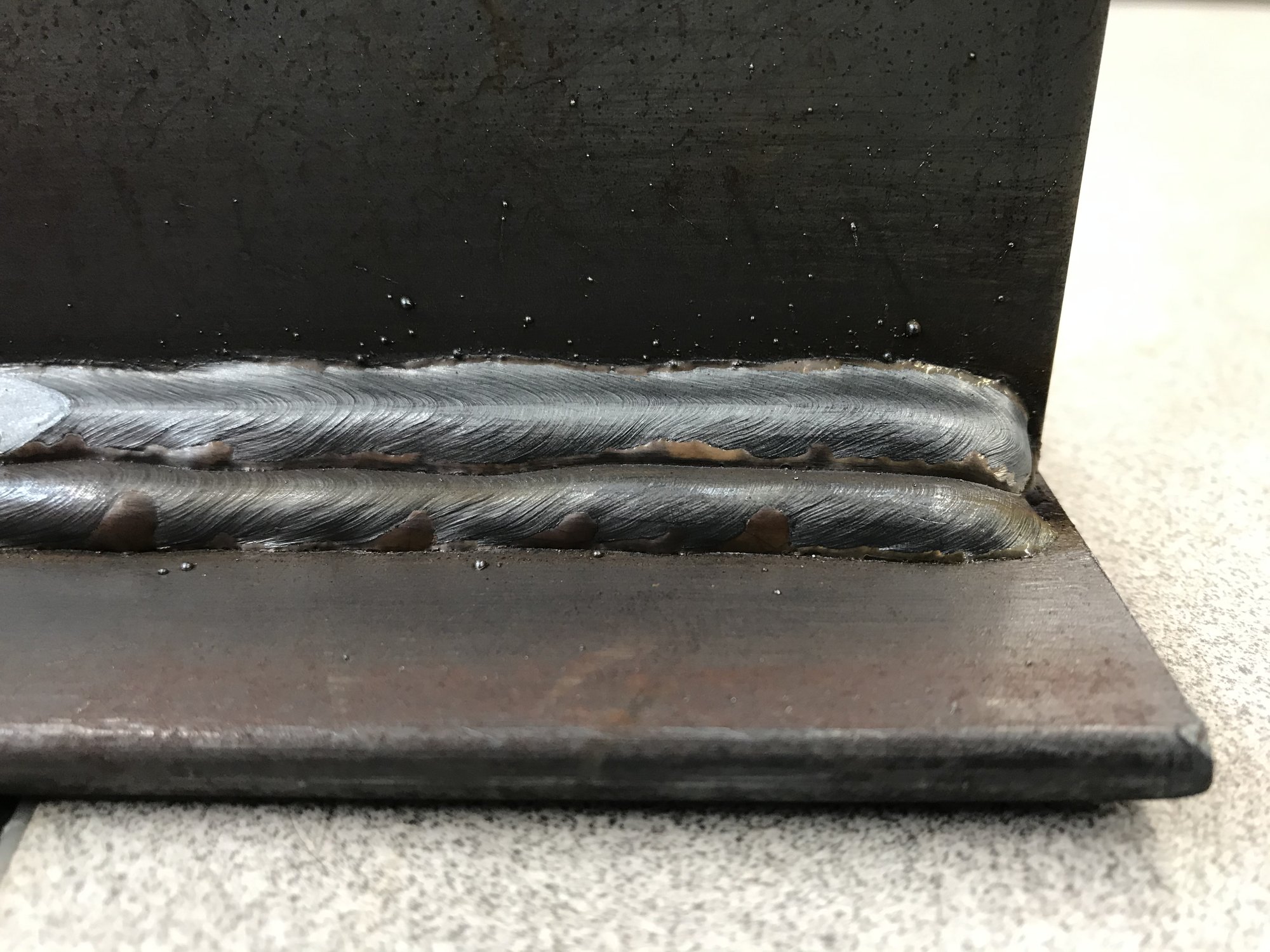

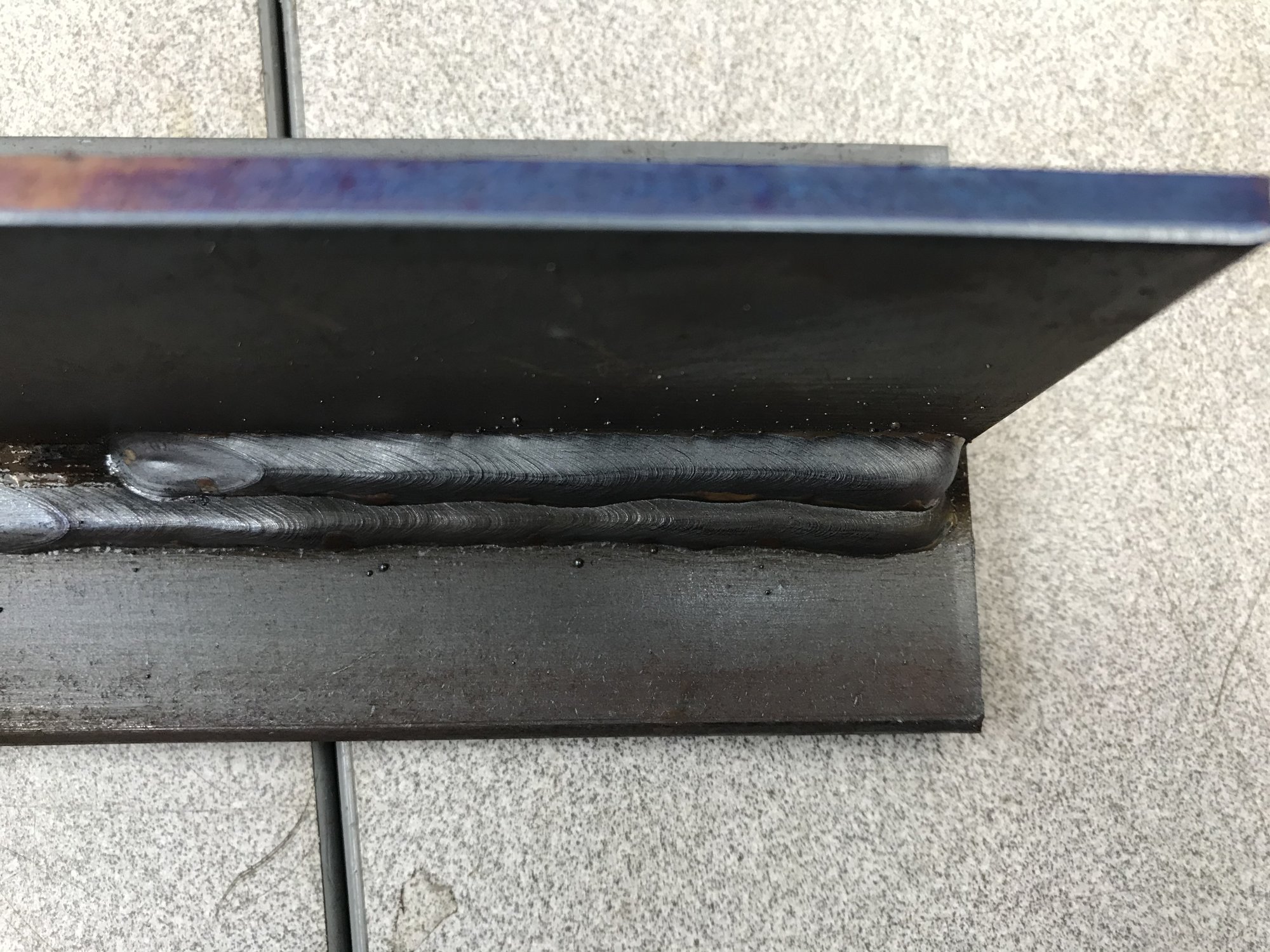

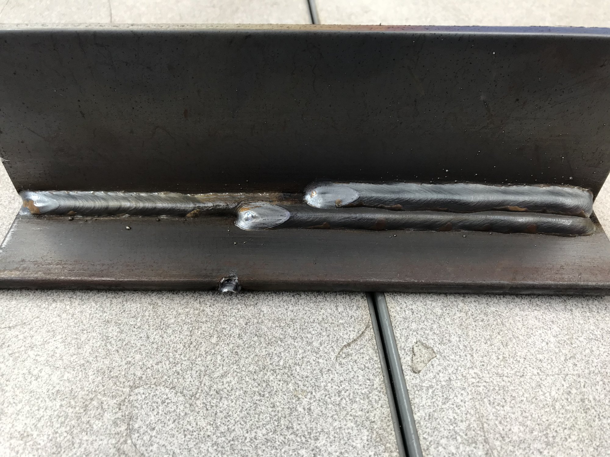

    Hi guys,
    below are photos of an overhead T Fillet multi run on 6mm steel that I attempted last week. You’ll see that the second and third run are stopped some way short of completion, the reason for this was so I could show a friend what they look like at each stage. However, it looked much better in ‘real life’, or so I thought. I think it looks horrendous in these pics.
    Tips / advice, please?

    Id say not enough amps

    What transfer mode was you in making those runs? They look very smooth, and the way they have sagged suggests the puddle is too fluid, which would suggest too much voltage or amps too high. More likely the voltage is too high.

    I thought the puddle looked a bit long and was wondering about torch angle.

    Thanks for this, much appreciated. I was using a Lincoln 405 and settings were 6.14 amps(?) and 21.3 wire speed (readings from the digital set up?)....

    cut a section across it , and have a look inside , out of curiosity ,,
    cant do any harm , polish it and etch it .

  12. Not a bad attempt, as has been said they look a bit “saggy”, turn the volts down a bit, maybe the wire feed/amps as well to suit and see if you could travel a bit quicker, but overall not bad at all, you’re heading in the right direction

    Thank you. I wanted to go faster but I kind of had that mental block of thinking excessive speed would result in no penetration.
  15. Going too slowly will reduce fusion/penetration into the parent material

    Don't be afraid because it's overhead, keep it hot, I'd do it as hot as a down hand fillet, maintain the correct angles, lay narrow welds, run a cutting disc along the toe of each weld and remove any silicon or foreign matter that can become entrapped and prevent fusion, on the 2nd pass, overlap the root by half, the 3rd pass may require some manipulation to eliminate /fill any notch between the capping passes;
    I'd be hard pressed to recall any time when I've had to lay a multi-run on 6mn plate
