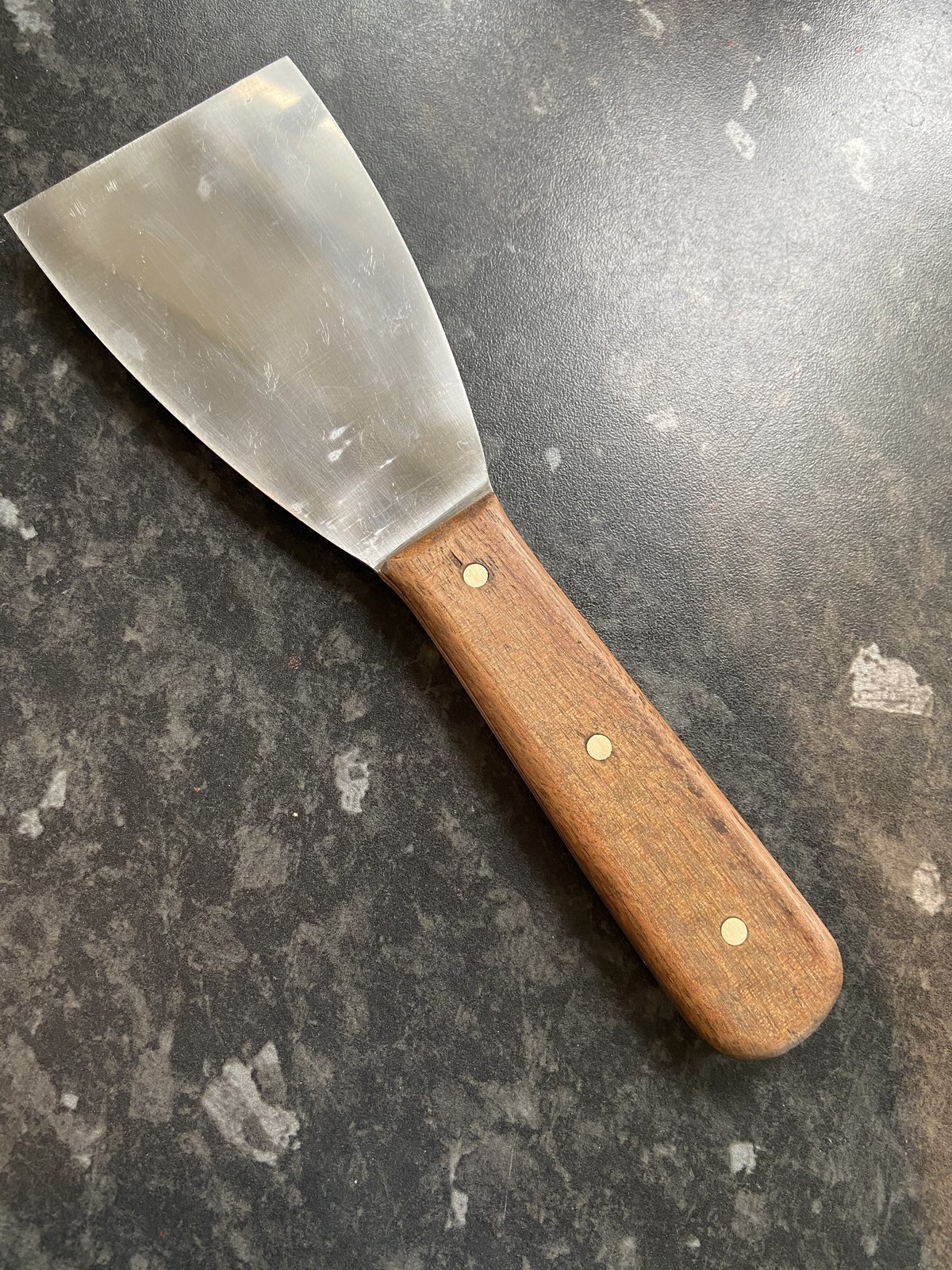

Rain stopped fence painting so I had some work shop time and made this scraper, Ive got loads of SS blanks.

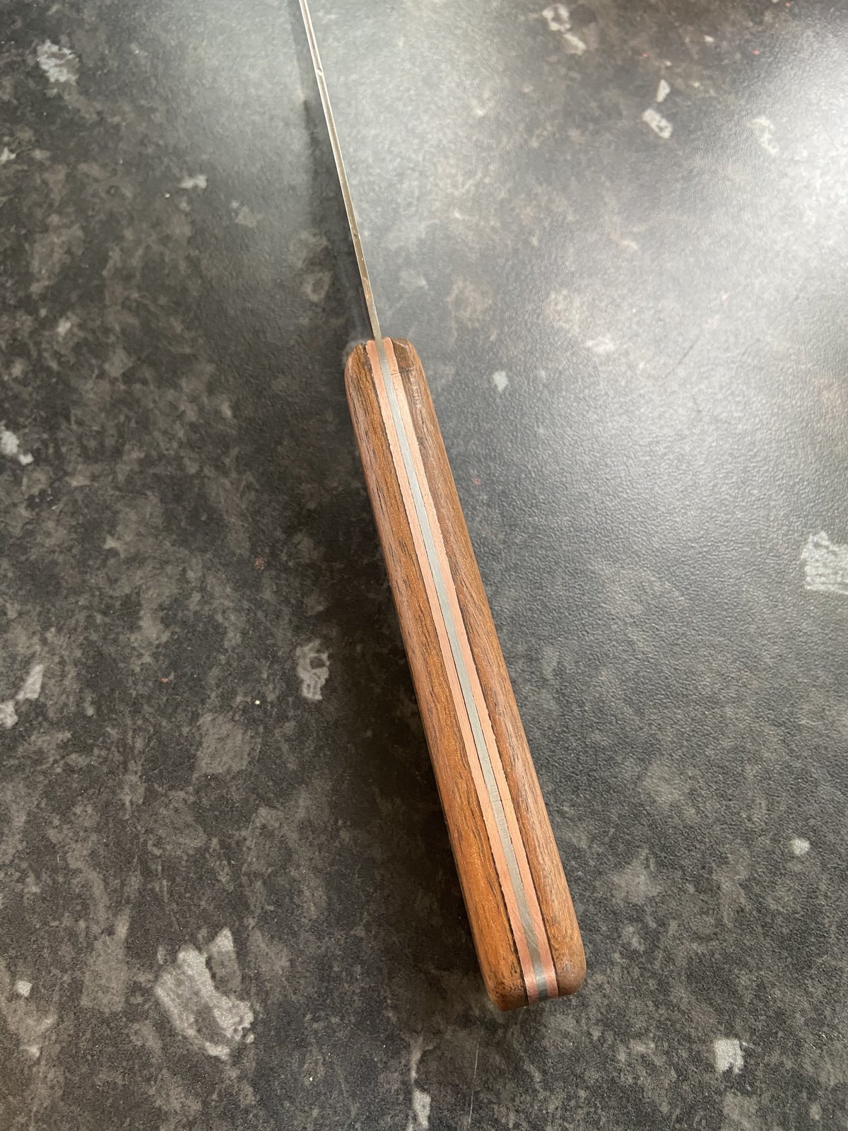

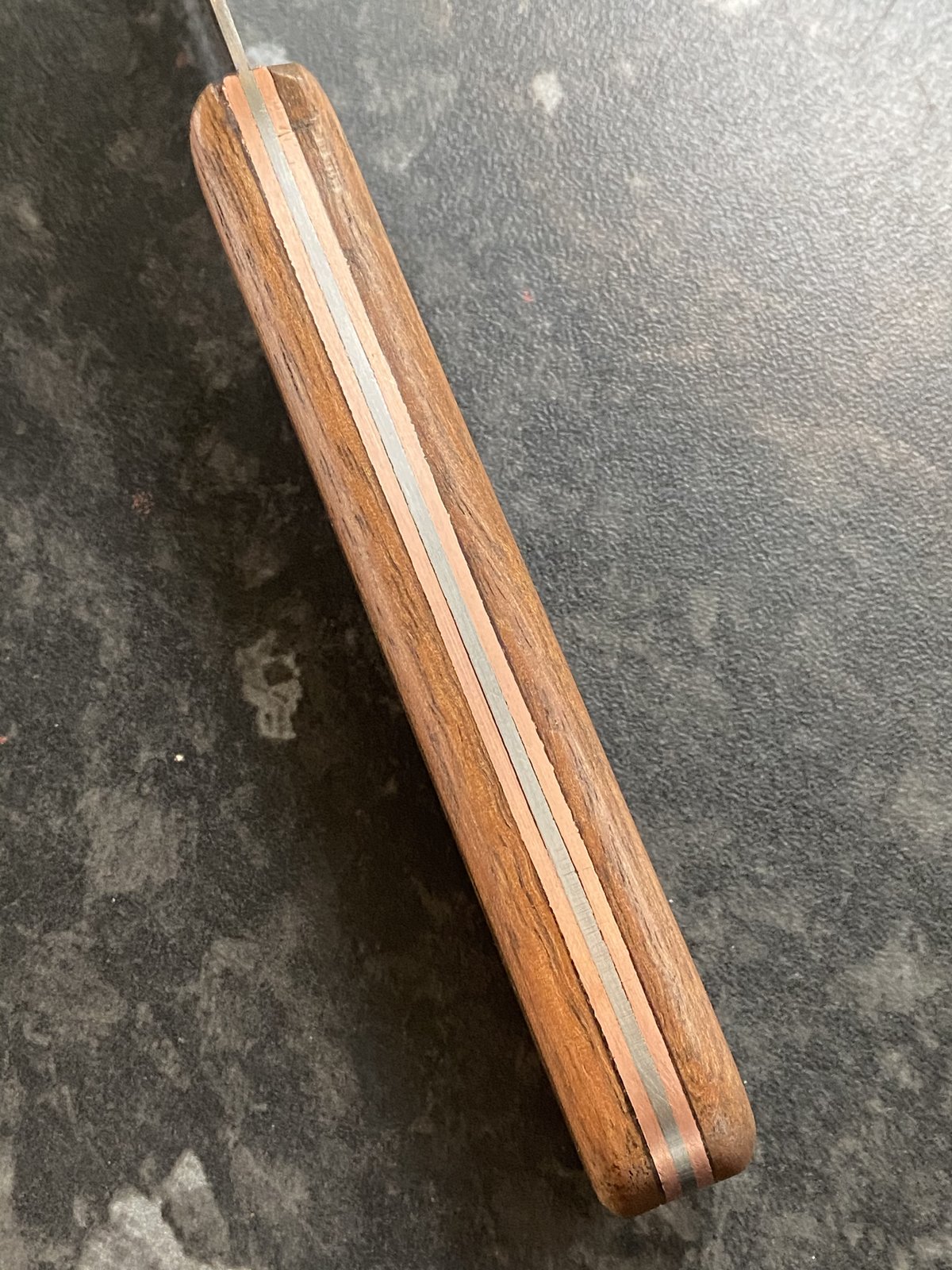

Used the milling machine to mill some teak slats from a broken chair to 6mm. Machined some brass pins to 4mm, cut some copper sheet. Some blood sweat and tears. All glued together with pound shop epoxy. Finished with dark wood stain and a couple of coats of wax
It’s not as easy as they make it look on TV. Next time I’ll do a few things different to make it a bit easier. It’s not perfect but I’m happy for my first go at laminated handles
