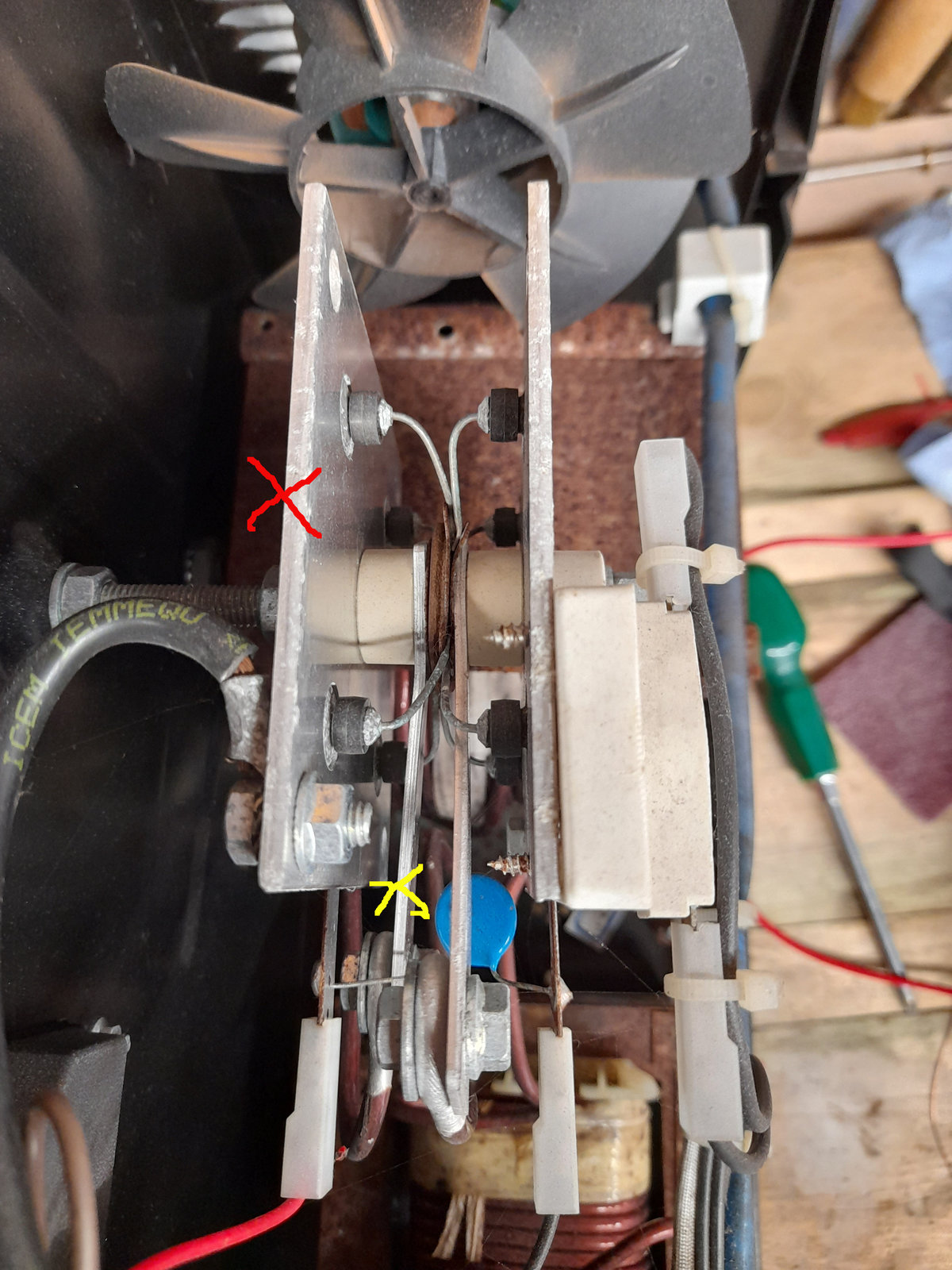

  11. gjkathome New Member
    Messages:
    14
    Location:
    London, UK
    I've opened the welder but I don't see anything quite like the crimped connected discussed in the thread above. I have measured the OCV at two points as indicated photo.
    I got 16.4 volts at the red cross, 21 volts at the yellow. I have no idea what the mechanism in this photo actually does.
    If it is something wrong with the bridge rectifier what do I do?
    Thanks.
  12. a111r Member
    Messages:
    889
    Location:
    London
    That's the half-wave bridge rectifier. You can see 8 diodes on the two alloy heat sink plates.
    If your meter has a diode test function, you can test them individually, easily, in-situ.
    They will conduct one way, giving a reading around 0.5, whilst the other way they should give no reading at all with no conduction.
    I think you will have the crimps, on the wire from the yellow X (the DC -ve).
    Take another side-on photo?

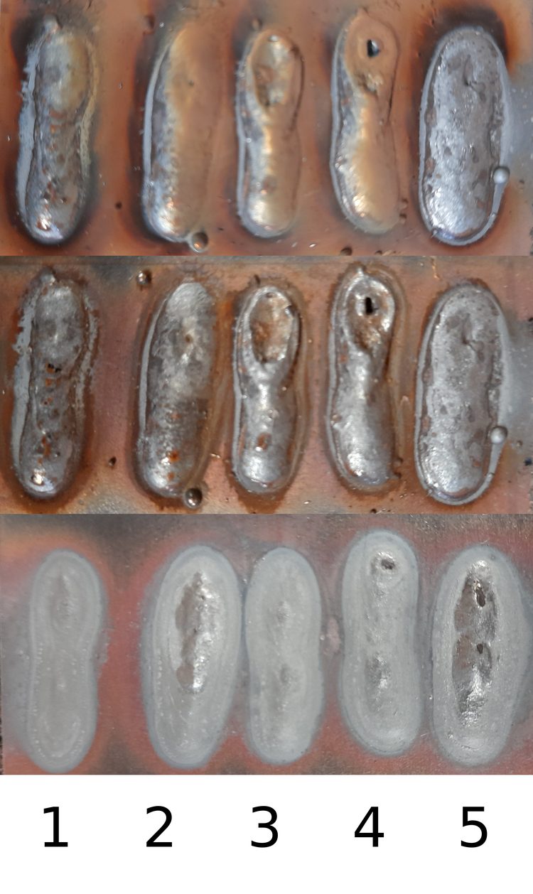

    Right, first the apology. Having now learnt how to use my multi-meter properly I think the voltages are OK.
    1 Min 19.7v
    2 Min 23.0v
    1 Max 27.4v
    2 Max 33.8v
    So, sorry for introducing red herrings. Still, at least I have now tested the diodes (0.46 in each case) and have checked various connections. I also know that the manual I have has the middle two settings swapped.
    The images below are my efforts on 1.5mm mild steel, with settings 1 Max (27.4 volts) and wire speed as follows:
    1 5
    2 5.5
    3 6
    4 6.5
    5 7
    I was using 86% argon and 14% CO2.
    Top image is as it looked when I finished. Second is with some of the brown sooty stuff rubbed off. Third is from underneath (flipped so the numbers correspond correctly).
    I have not been getting the sizzling bacon sound as well as I did with earlier attempts. More like a sizzle with the occasional loud pop. I wonder if the wire feed is not consistent?
    a111r likes this.
  14. a111r Member
    Messages:
    889
    Location:
    London
    The machine's OK then. 1 and 2 are the best.
    Did you try using setting 2 Min for that thickness?

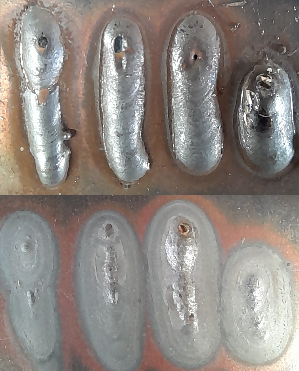

    London, UK
    Thanks everyone for your input. Here are some images using the 2 min setting (23v). Wire feed settings are, from left to right 4.5, 5, 5.5, 6. I think 6 my have been too high as I seemed to keep welding the wire to the tip.
    a111r likes this.
  18. They are all too hot, you are burning right through the plate. Penetration is something completely different
    Nick DV likes this.
  19. Munkul
    Munkul Jack of some trades, Master of none
    Messages:
    3,145
    Location:
    Cumbria
    turn the wire feed up.
    I'm getting sick of saying this.
    Wire speed = amps = penetration
    volts do not equal penetration!!!
    tom2207, backpurge and Nick DV like this.
