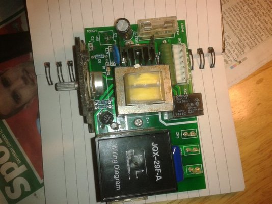

    My powercraft no gas welder stopped working. When I opened the top the wire had run out. I replaced the wire and the welder still did not work. I found a loose wire in the torch handle and the machine came to life but the wire feed won't work. I disconnected the motor and it works on a battery. The motor works and the drive wheel moves. When it's reconnected no wire feed. I am no expert on repairs could anyone give me any advice on how to proceed?

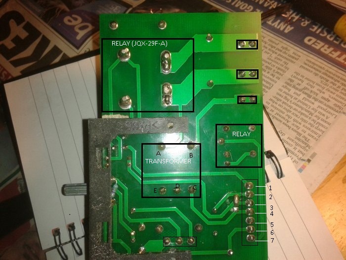

    Can you post a (nice clear) pic of the pcb as then will try and advise what and where to check

    Does it look like this PCB ?

    Hi Mike Thanks for the response. The picture is of the same board as mine. The machine now comes on and will arc but the motor will not go to feed the wire. No voltage to the motor. The motor works when I put a battery across it. I have AC voltage on the panel which seems to go to the yellow transformer (one leg) I am not tech so I am now lost as to were to go now. I would be grateful for any help

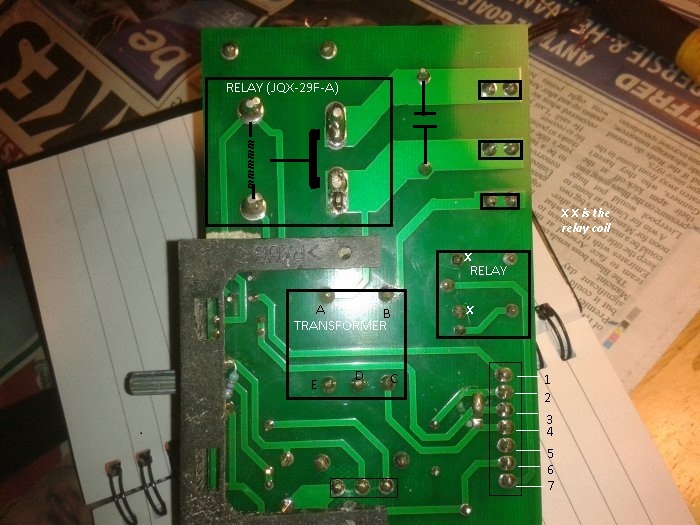

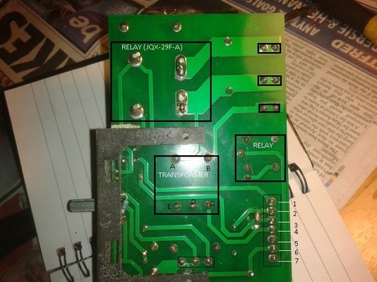

    Looking at the under side of the pcb I believe that the AC 240 goes in to the transformer on pins A and B and then the low AC voltage out is on pins C and D or E not sure which as the track must be on the other side. If you meter between A and B do you get 240 Volts AC ? If yes then meter for 15 to 30 Volts AC at C and D or E.
    Which pins do the motor connect to ?
    Can you get a fuller pic (than mine) of the pcb.

    Thanks for that. I assume that I am measuring right. I have now checked that I have 240 volt ac on the transformer. If I check the two outer pins on the other side I get about 30 volt ac. Were do I go from here?

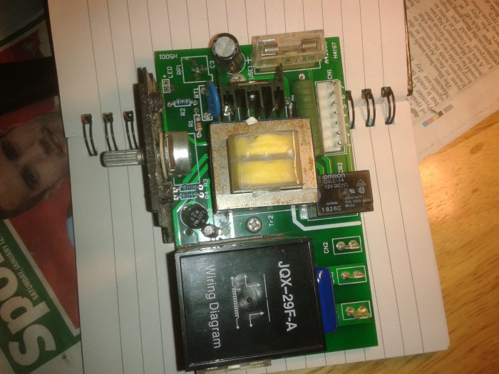

    Right so you have the LOW AC voltage (the 30 volts) onto the board. This now gets changed to DC. The black round thing on left side of board viewed from component side (It's a bridge rectifier) If you look at it, it has a " + " and a " -" and two squiggly lines. The squiggly lines indicate the AC IN to it (from the 30vAC) the device then changes it to DC and it comes out on the + and - pins. Check to see if you have the AC in (meter set to AC) if yes then check for the DC out (meter set to DC volts ).

    I assume its the one marked D2 on the board. I don't appear to have any voltage readings. Should it at least have a reading if I am getting a reading at the transformer. Does that mean that it needs to be replaced If so were would I get such a thing to fit in it's place

  15. mike 109444
    mike 109444 Member
    Messages:
    4,146
    uk Bristol
    You should see the 30v AC at the inputs to that device (D2) at the very least, unless the output from the transformer goes through one of the relays in which case you might need to operate the trigger at the same time (not easy to do by your self!)
    Remember I am only working this out form the pics I have posted as I don't have a better image. It really needs a pic of both sides with that black plastic (?) frame removed as this is a double sided pcb the tracks start on one side and may continue on the other making it difficult to work out what is connected to what.
    Do you hear any "click" from the pcb when the trigger is pulled ? and again which pins do the motor connect to ????

    Yes I hear a click when trigger is pulled. The pins 6& 7 go to the motor. I will try to measure again and press the trigger. Once again thanks for your assistance

    If you meter on the two pins marked "X X" (meter set on DC volts) do you get 12 Volts ?
    Also what is the numbers on that relay G??? 14 as the pic is not clear enough

    Have now rechecked the voltage on D2. I have AC on one side and DC on the other when the trigger is pressed

    Right so do you have 12Vdc at the relay as asked in post 18 ?
