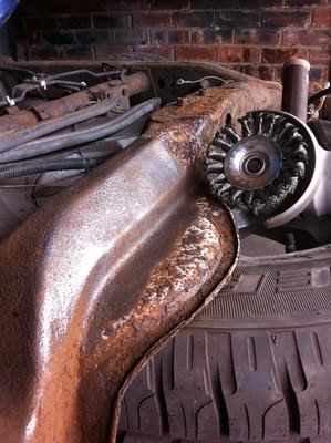

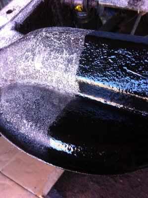

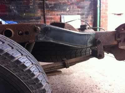

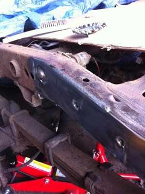

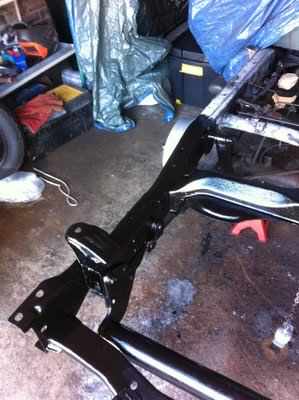

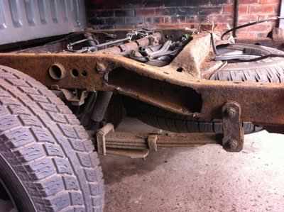

Hi folks , thought I'd add my rusted chassis repair off my nissan navara that I repaired.
I cleaned back to solid metal then Infilled hole with 3mm plate, once welded I overplated to strengthen.
This process was repeated on drivers side Also to keep it even. Once fully welded I then cleaned off the rest of the rusted chassis and painted with por15
