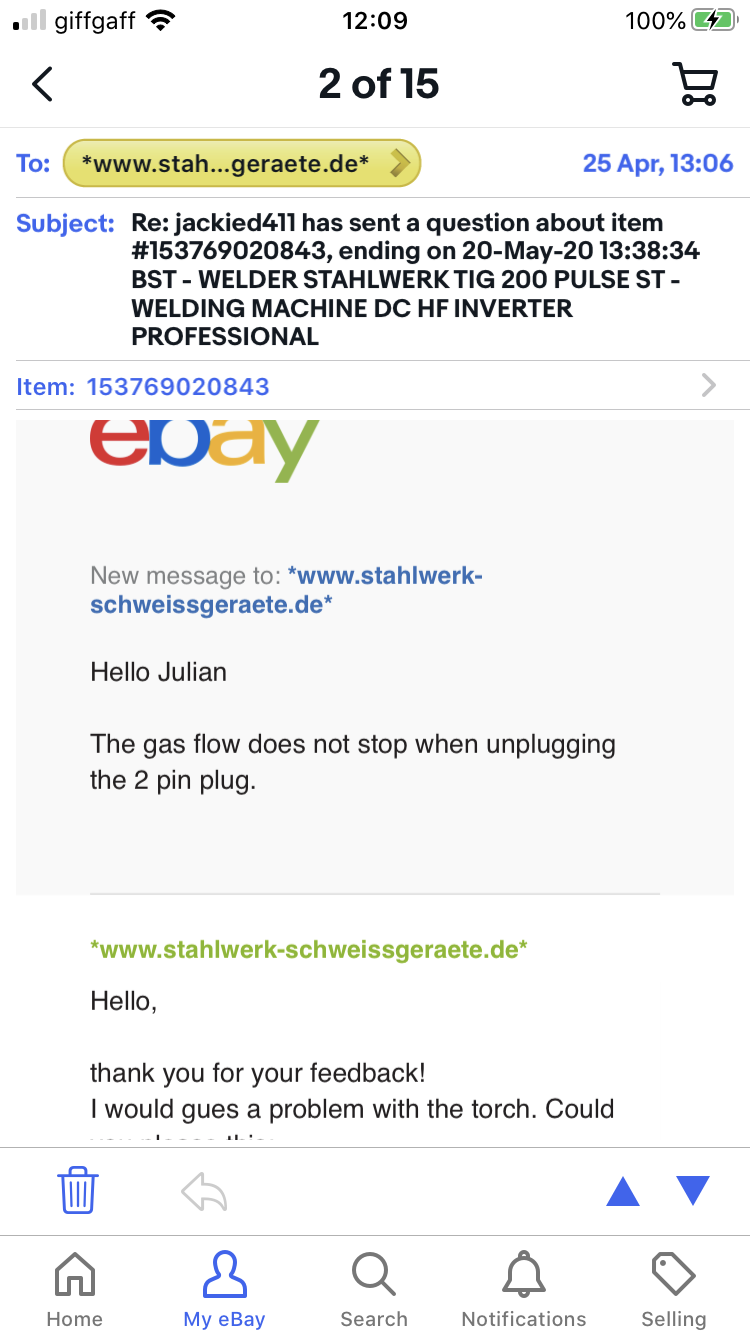

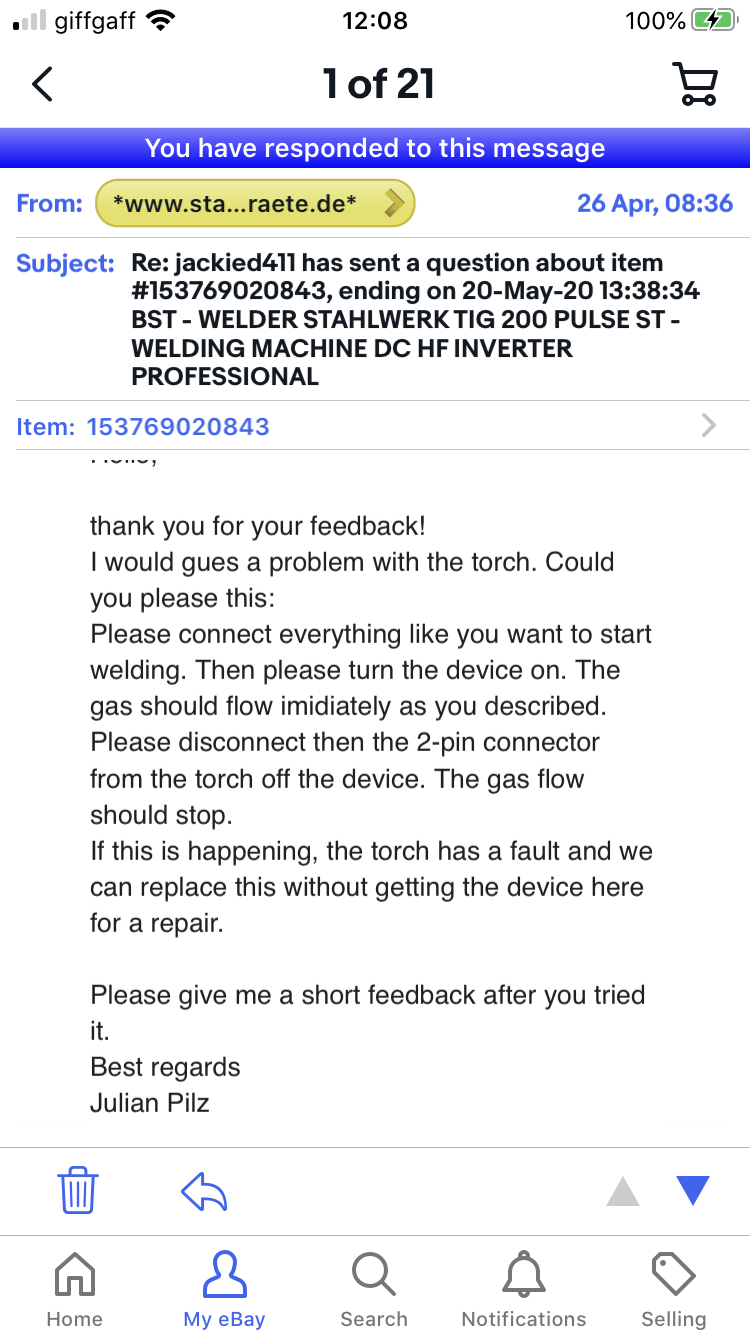

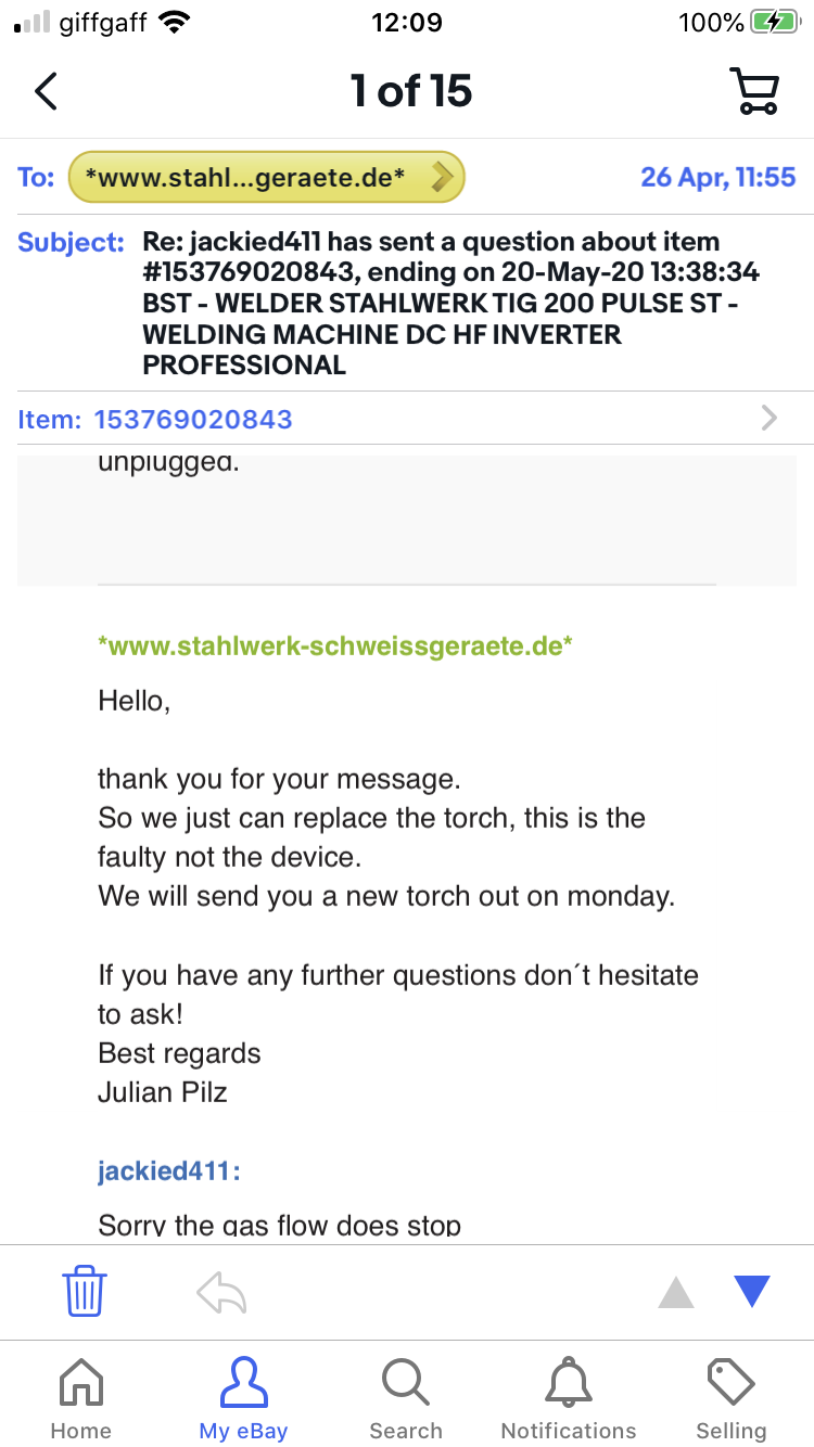

New Stahlwerk tig purchased, after a couple of passes without filler to test it stopped initiating arc and the cup constantly has gas flowing out. This is not right is it and probably not something I should attempt to fix on a 1 day old welder?
