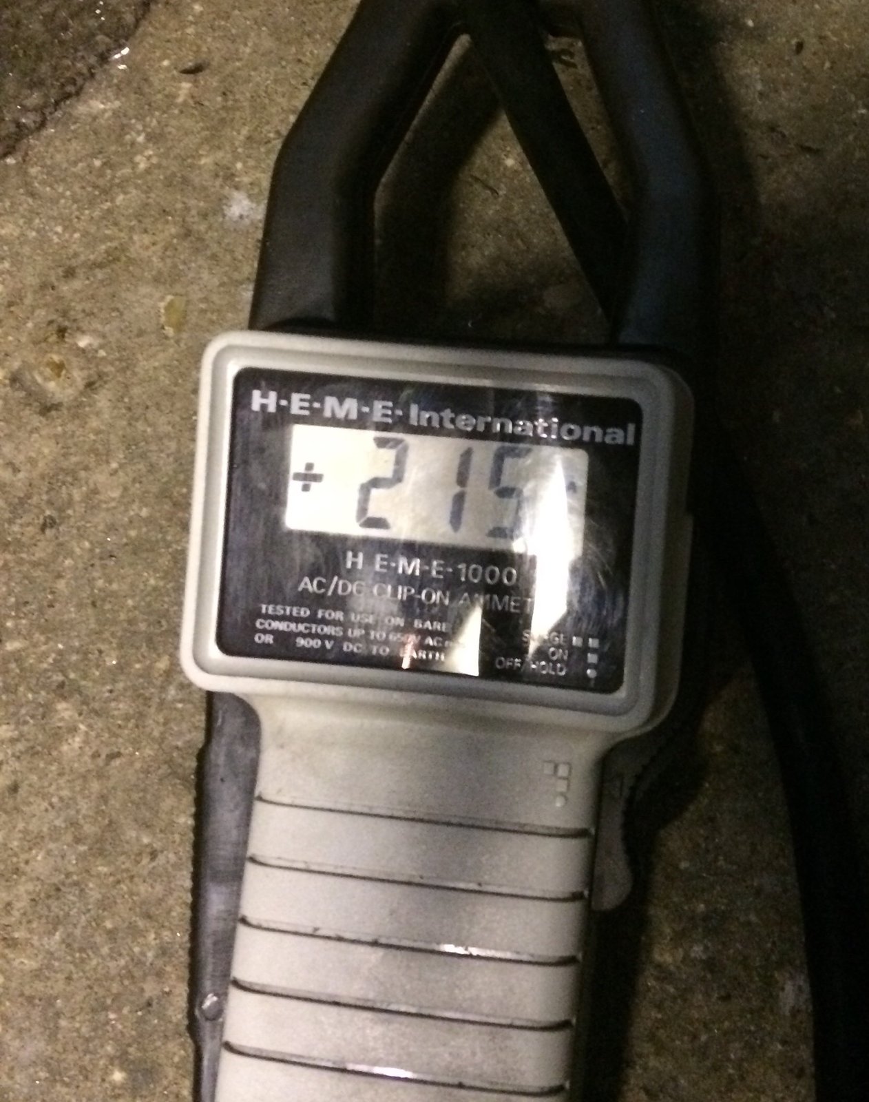

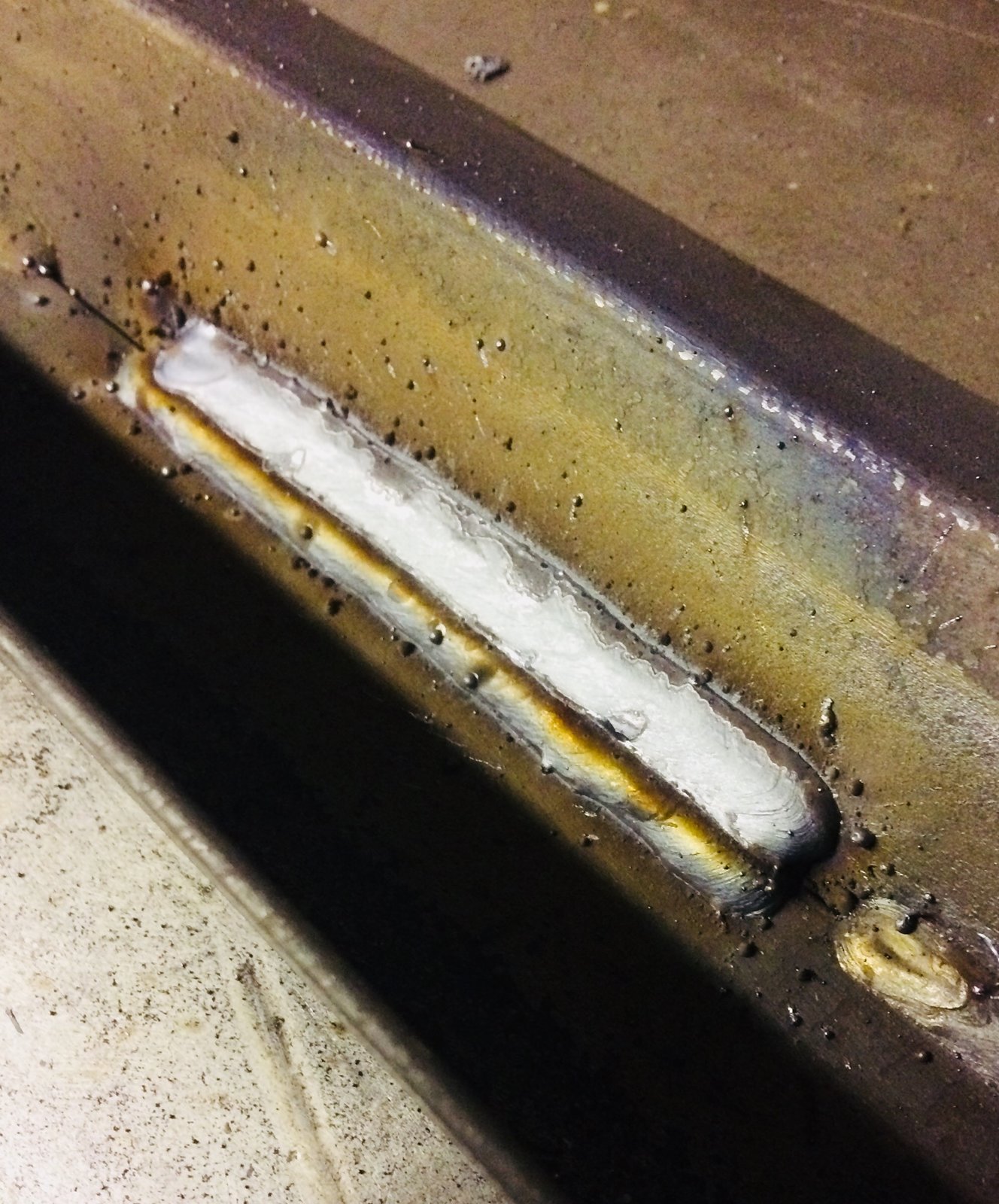

    Got some gas today and chopped up some 3mm wall angle for a half hour play. Never owned a Mig before but it was a nice deal on a decent machine so I took the plunge. I’m not gonna get into loads of pics of poxy Mig runs the forum is full of those but I am quite surprised with what it says and what it actually does.
    I had ambitions of fitting a 20amp c type breaker dedicated supply for it. At the mo I have a 16B. Which has never let me down maxing my tigs out. However after today a 16C is all I need I can use the thing in 7 out of 8 voltage settings appropriate wire speed and it’s tripped it twice on surge. On setting 6 it holds out strong.
    Now the really strange part.

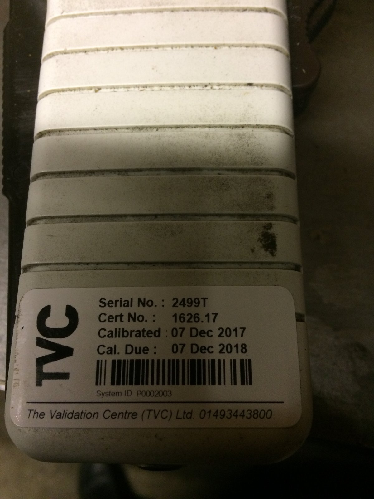

    13amp plug/16amp breaker I popped on my trusted newly calibrated amp meter. Voltage setting 7 out of 8 wire speed 2/3 of the way round and asked the Mrs to photograph my amp meter. So it’s not maxed out, it’s a 195 Mig. It’s running on a 13amp plug and the meter is calibrated a month ago to a 4amp error at 1000 amps. Explain this one to me.

    It’s just inrush current and is transient.
    Your meter must be faster than the trip time on the breaker.

    Sorry just realised this was on the output.
  4. Richard.
    Richard. Forum Supporter
    Messages:
    18,351
    Location:
    Cambridgeshire
    Yes that’s dc current been recorded while I’m welding
    She said it peaked at 220.

    I understand this but when people ask this question run a transformer Mig on a 13amp plug/16 amp breaker etc the usual reply is 150-160 max which is what I was expected. Over 200 I never thought I’d get that.
    Yes current is a strange thing but that’s a grossly underestimated machine. Not even maxed out yet thumping way above it’s 195 rate. I’ll have a go at measuring voltage tomorrow mate.

    Well measuring welding voltage and current from an inspection and a wps point of veiw used to be a daily job for me hence the up to date calibration on my meters. I’ve never seen arc voltage fluctuations of a few volts unless the machine has been faulty. 0.5 of a volt yes but never any more and I’ve put my terminals across more than I can remember. I’m not a leccy techy but from my experience the voltage should be solid. Easy enough to test. I’ve done it enough times.
