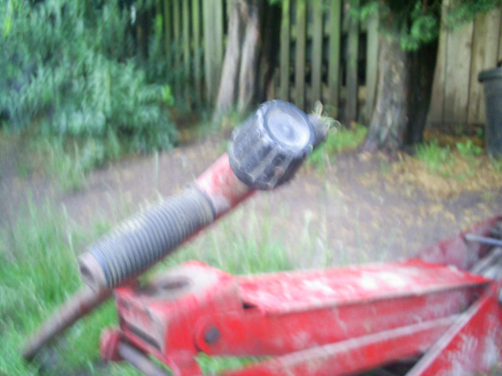

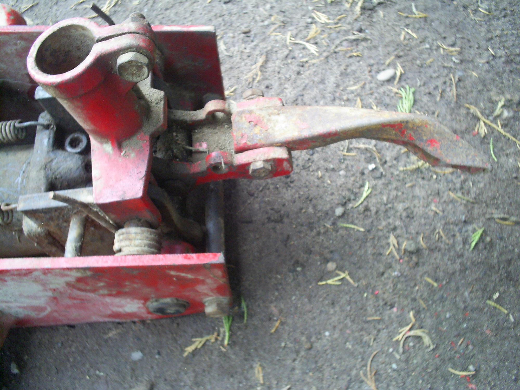

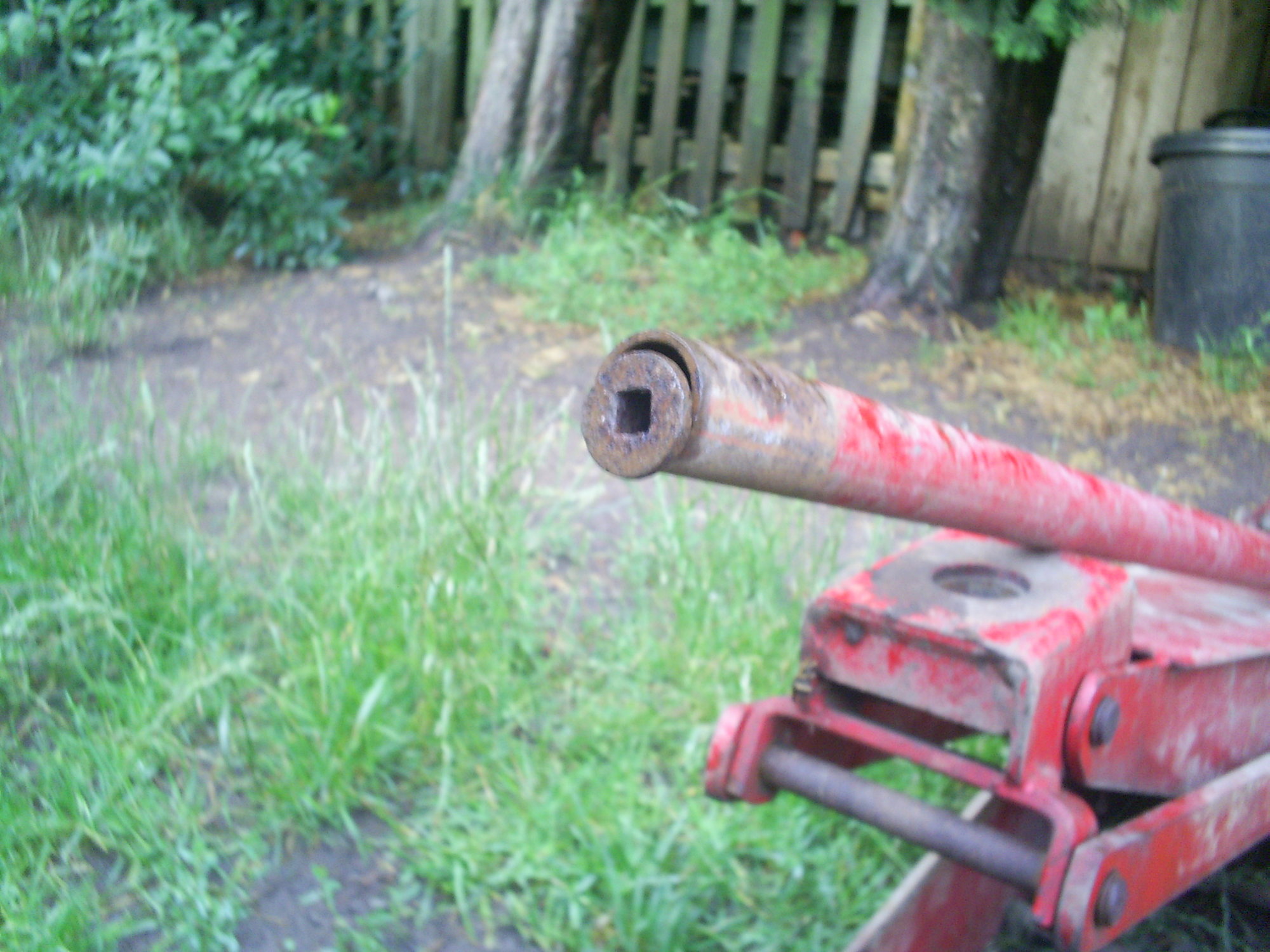

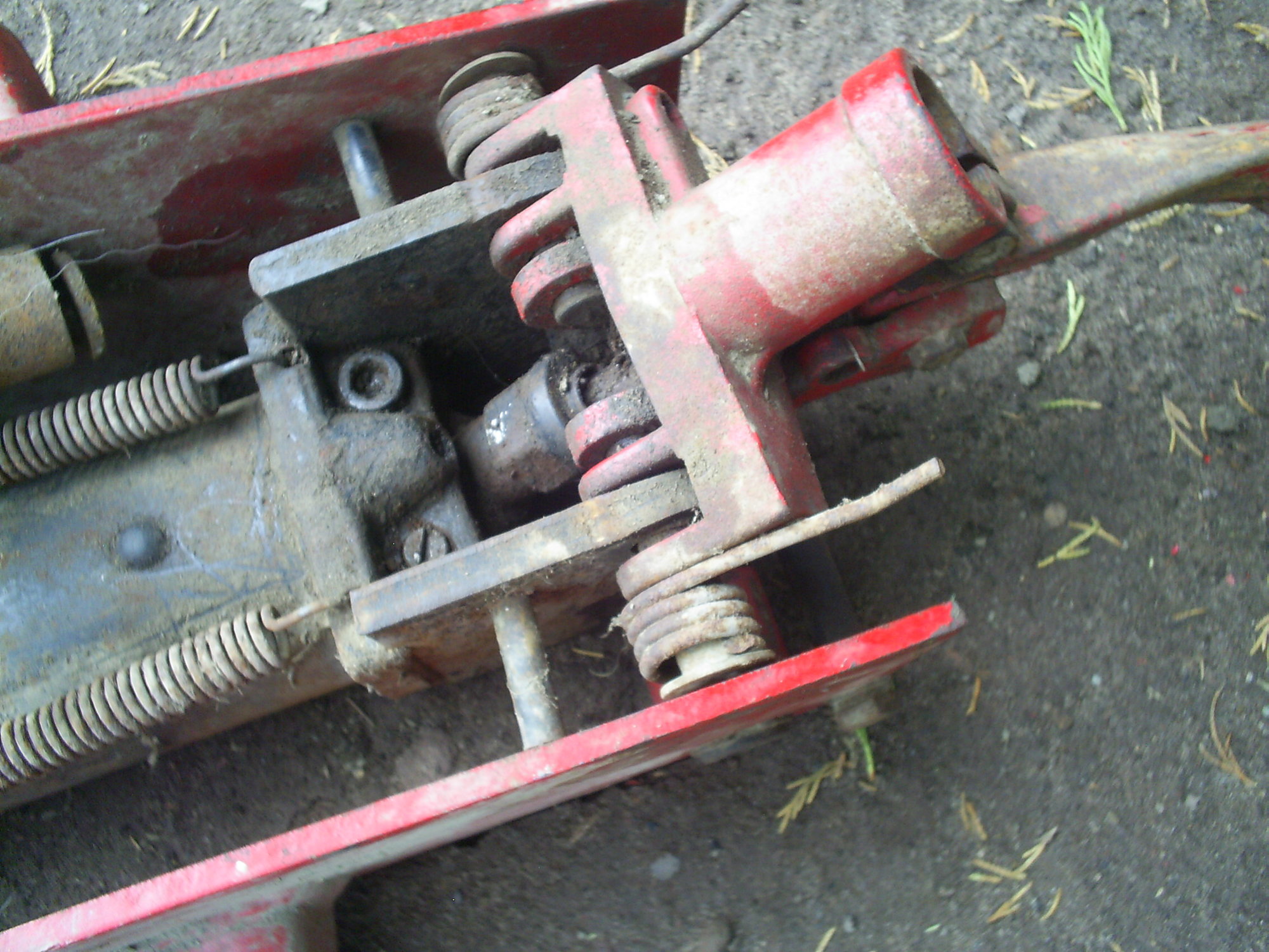

    Got this at auction. Jacks up with the what I think is a foot operated lever but there is no way of getting it to lower from what I can make out. The saddle where the jack arm fits is not connected to the pump and its return springs are snapped. The handle has a square hole on its lower end and is rotated by the knob on its top. But there is nothing for it to connect to at the actual hyd bit! I think perhaps the hyd unit has been fitted to replace the original but am damned to see how to lower it. There are two plugs on the top one with a allen head and the other a flat blade head. Took the flat blade off but nothing happened and under it is something akin to a carb jet type plug. I have tried completely lowering the foot pedal and standing on the lifting arm but no joy there. Any thoughts?
    OOPS I have lost the first few photos of the jack so I will retake them tomorrow. It is 45inches long and 16inches across the rear castors.

    Usually a case of turning the handle to the right or left, Show some pictures of where the handle slots in.

    From the photos, that looks similar to a Clarke high lift jack I have. On mine, the foot pedal is for initial lifting to height and the handle for lifting the load, twisting the black knob anticlockwise lowers. The square hole on the handle end should locate over a square shaft inside the pump handle socket and the handle tube is held in position with a clamp bolt. The square shaft is connected to a release valve via a universal joint beneath the pump handle socket.
    Mine chewed a seal up and Clarke don't keep spares so I modified it with a 10t portapower cylinder. I hope it was cheap!

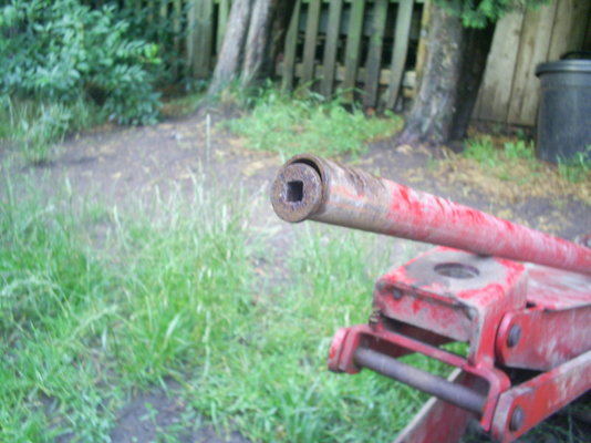

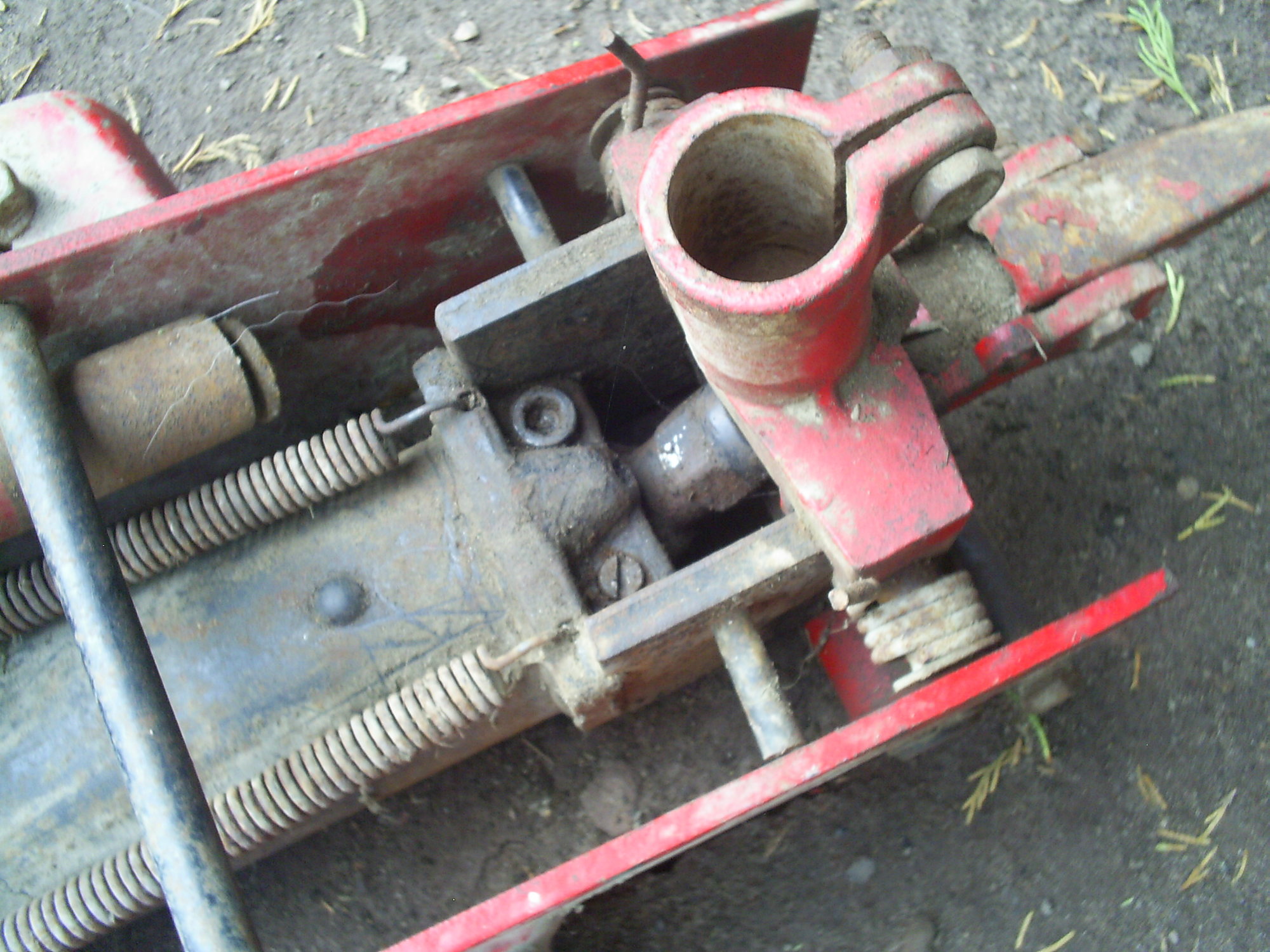

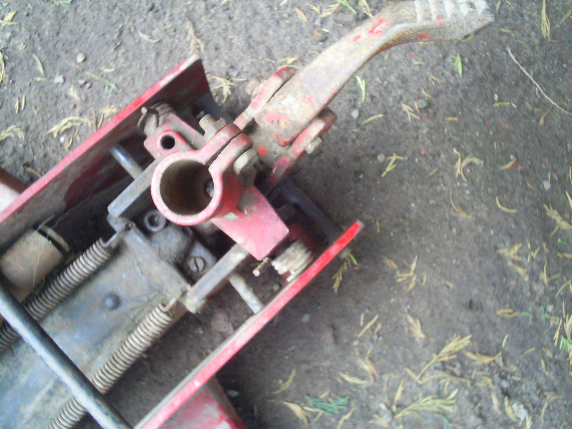

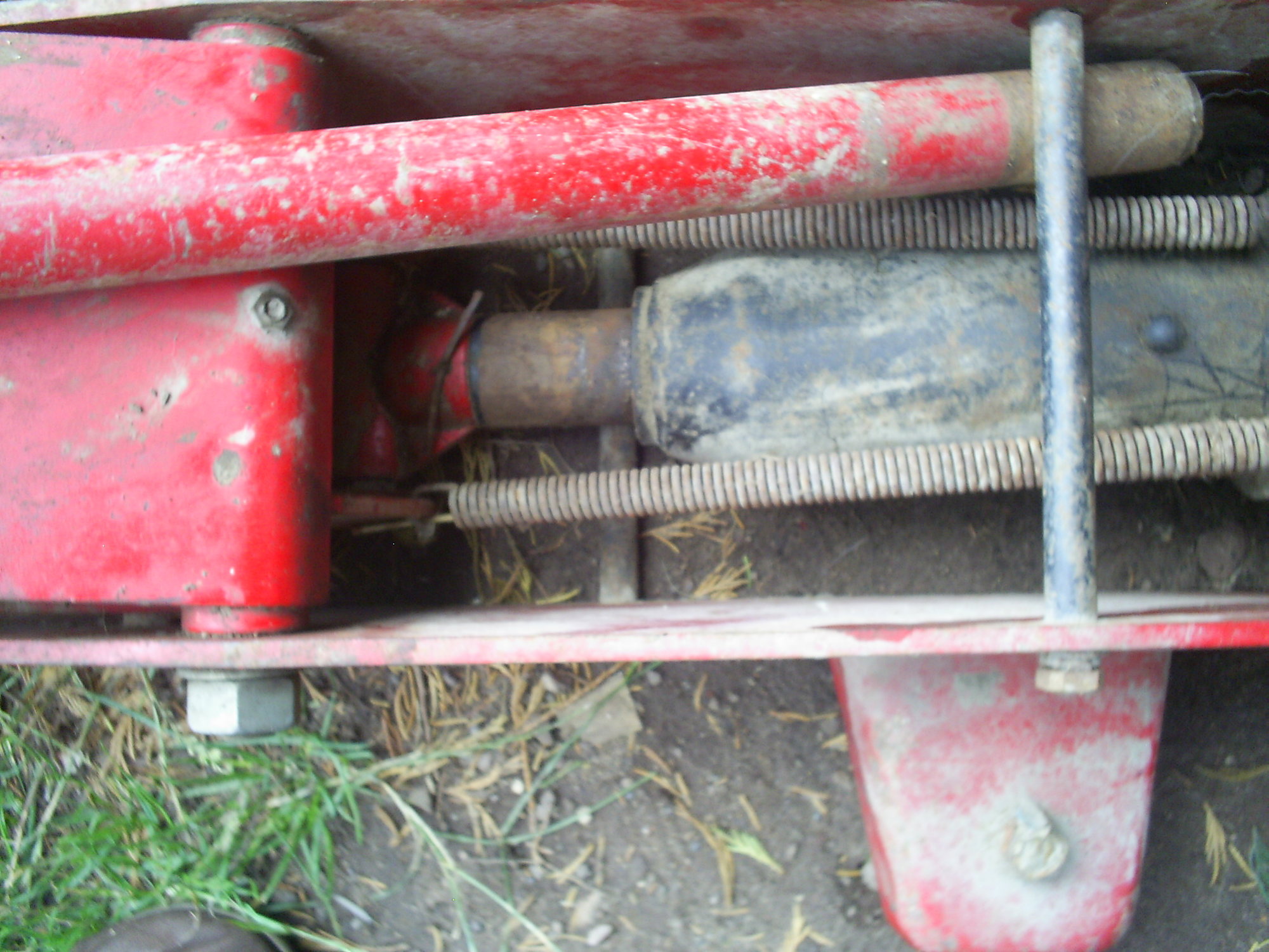

    As I mentioned in the beginning the handle has nothing to locate into regards the square hole! There is a hole in the handle connector with the clamp but nothing that would be coming from the pump to act as a release mechanism.

    This is the part you are missing.......
    (Click to enlarge image.)
    Also looks like the handle return springs are broken and the pin they rest on. It might be this jack or similar to it... LINK

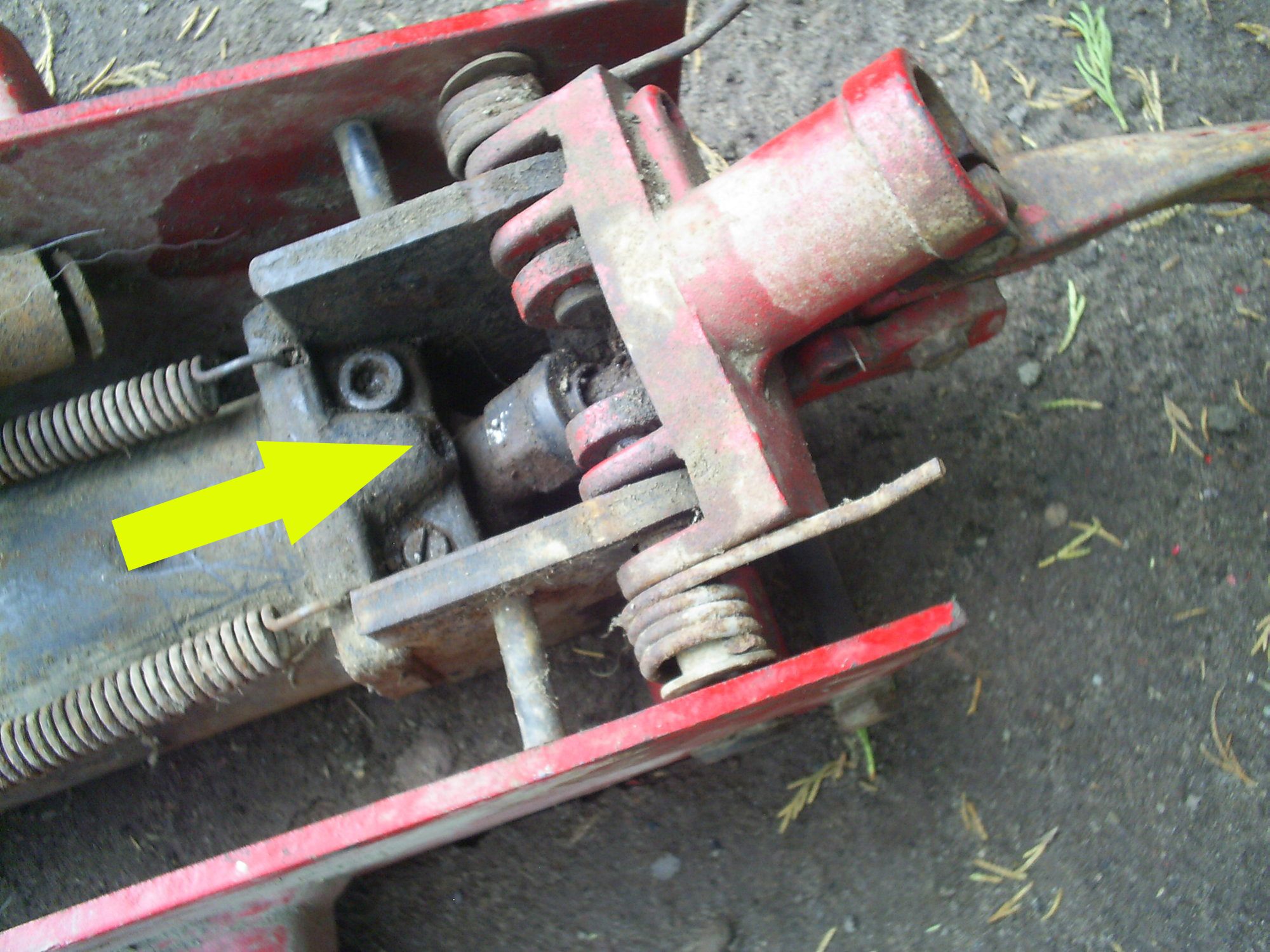

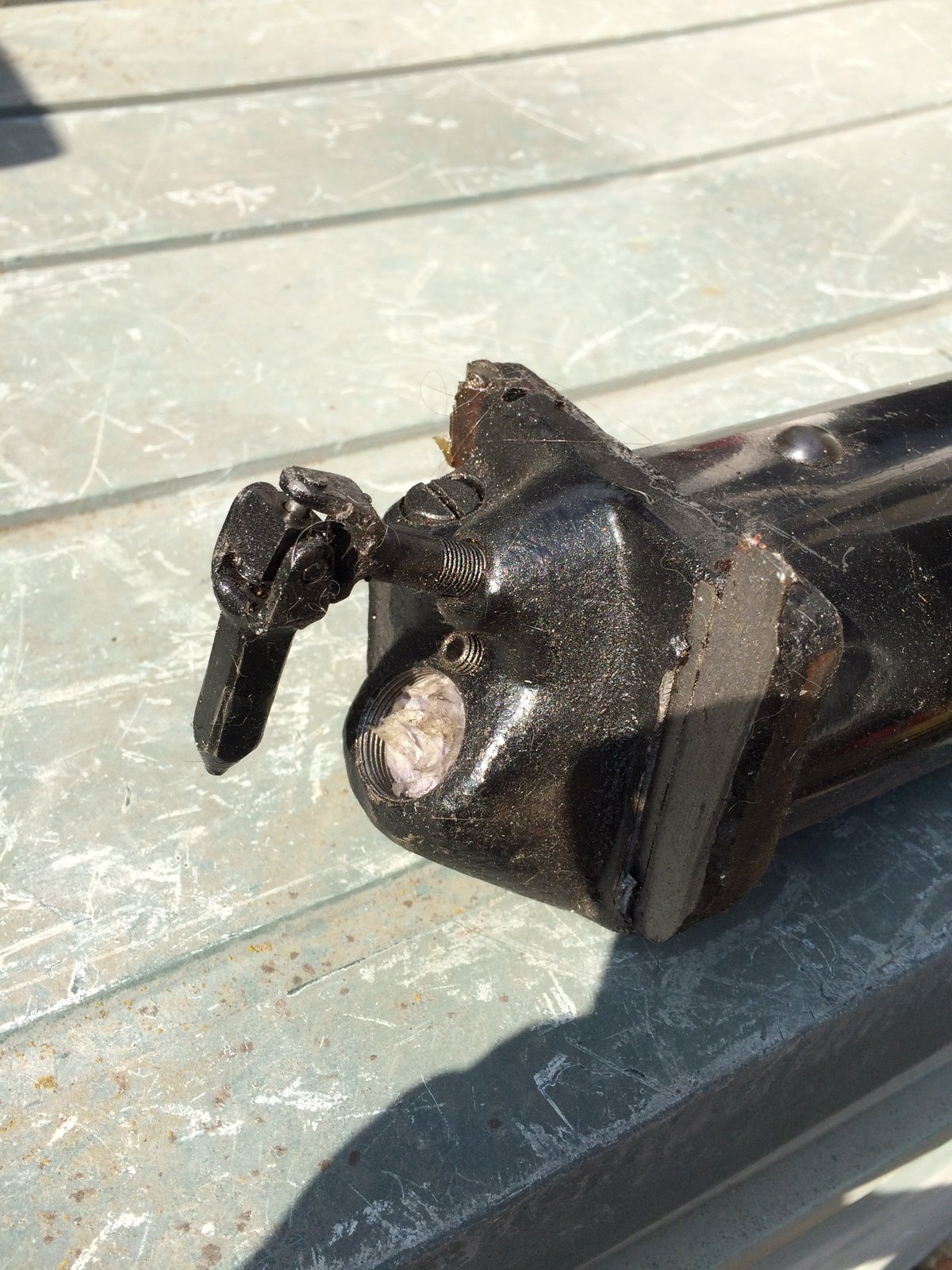

    Yes but the pump does not have the receptacle for it to go in! The only orifice is the pump one (see photo 3)which is connected to the little handle which is well bent out of shape. The springs are broken(mentioned in first posting) and the shaft there are on have a washer welded to the end to stop them from coming off and looks original. From that photo it does so I will pop down to the local in Stoke and have a look. Thanks for the link Wallace.

    Is there anything in here? My pump assembly may look different as I cut the plates off to mount the new cylinder.

    When I first looked in that area it looked flush but a prod with a stick does reveal a hole but unable to confirm what is in there. As the jack goes up I guess then that is the release and it must have sheared off. Looks like I will have to get the pump off and on the bench!

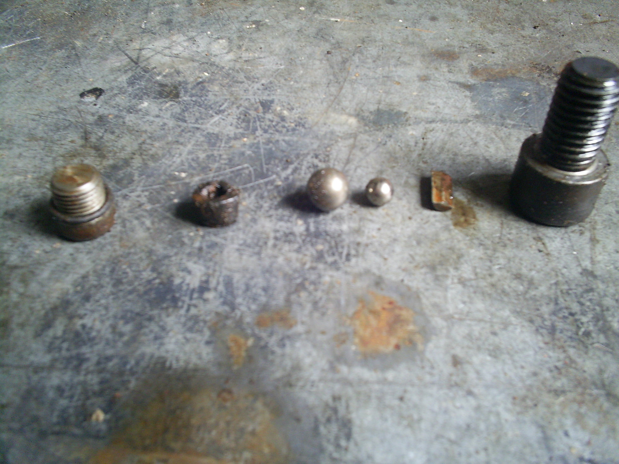

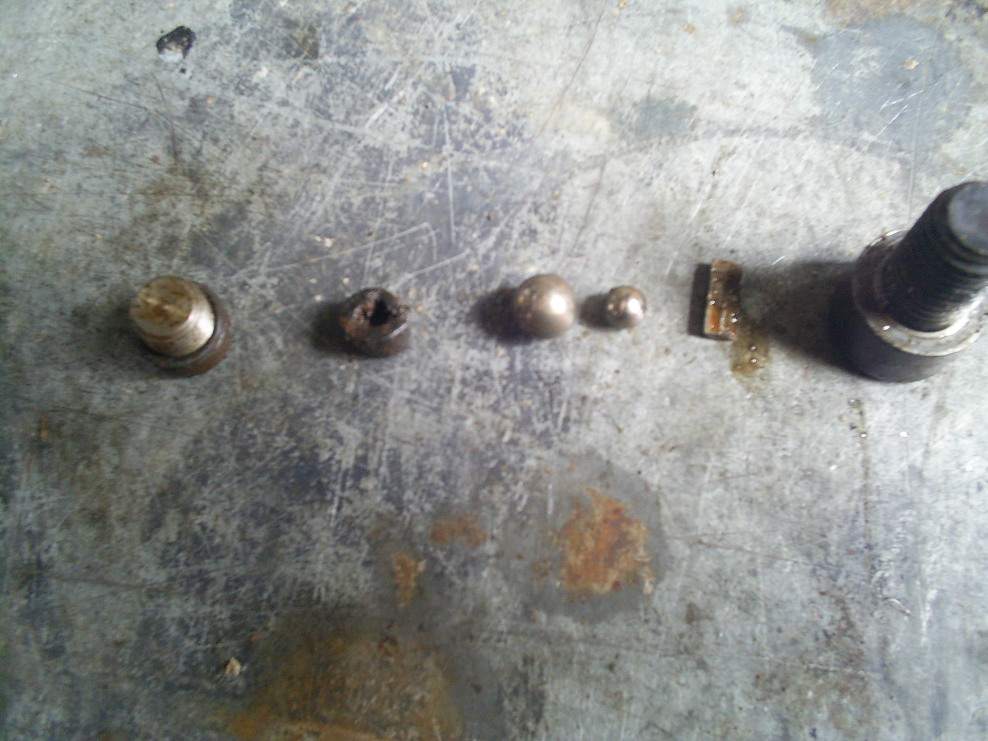

    So got the pump out of the frame of the jack, the return springs are the trickiest as they are strong in tension. On the bench it was a lot easier to inspect what is the place where the release mechanism fits. I could see what turned out to be a piece of what looks like a piece of split pin leg and a o ring of sorts stuck in the bottom. They are in the photos. Two ball bearings came out when I decided to drain the oil whilst I was on. From whence they came I know not. All ideas would be helpful. This pump does not come apart as all joins are welded!

  16. dan treg Member
    Messages:
    184
    Location:
    uk midlands
    this is effectively a non return valve sometimes there will also be springs the universal joint part rotates should push a plunger wish seats on the ball bearing this then should form a seal and hold the jack up. the universal joint is then release which unscrews and releases the pressure on the ball bearing and jack should descend slowly . looks like you have lost some parts to me
  17. p0689109 Member
    Messages:
    1,623
    Location:
    stoke on trent,england
    So the split pin looking bit is what is left of the plunger then. Makes sense now, thanks. The rubber seal was jammed in the hole sideways and why two ball bearings?
