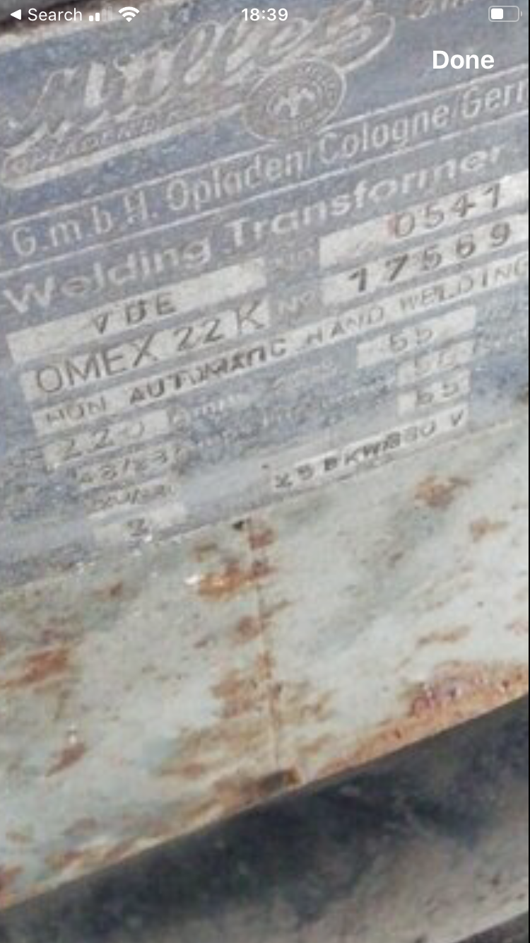

Hi has anybody any experience of muller omex arc welders , I found this heavy thing on wheels recently and it looks big /old and rusty . Was it a good welder in its day? Trying to age it also

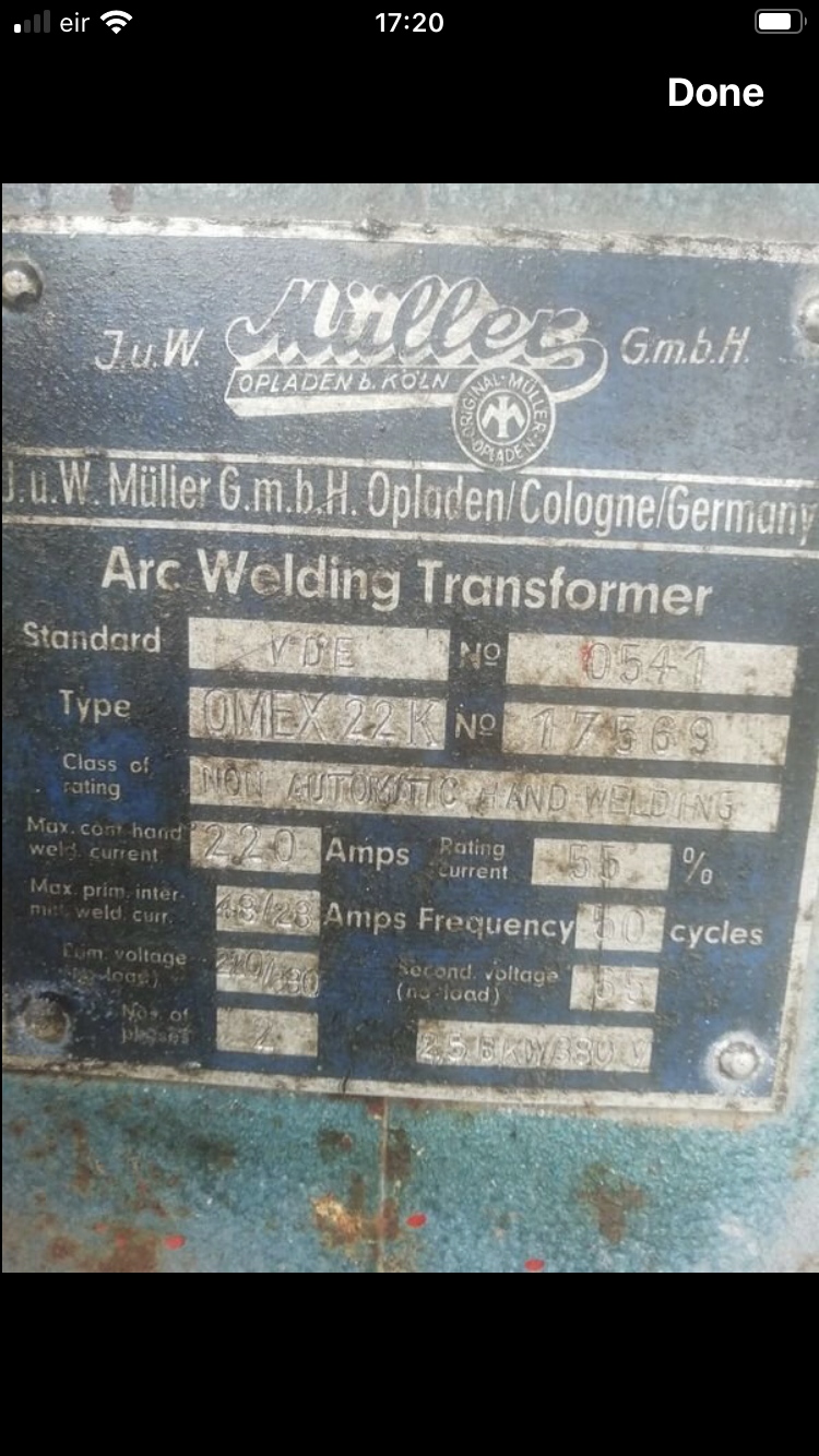

Hi , pic of plate up now . if you zoom the pic of welder the plug is that mad thing on top of it/ well the pic of plate not very clear I may post a better one tomorrow

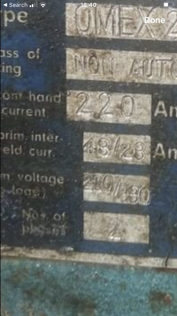

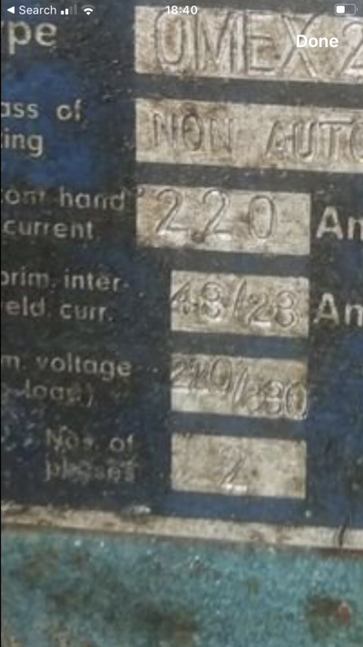

all my big welders are two phase, and need to be connected to a three phase supply, well a two phase but that is a three phase with one unused...….. don't ask me to explain, I just get a sparky mate in!
Yep this phase thing is a bit confusing to me , the plate pic a bit clearer on my phone and I’ve read it , the bottom of the plate says // no of phases 2 . Not that I know what to be doing about that, can’t find much about this muller welder online one or two cropped up in Germany
Serial number ends in 69 so that could be 1969, although the plate's design looks more 1950s.
Old, large and German, so top quality kit with probably nothing wrong with it internally.
If you've plenty of workshop space and intend welding thick plate quite often, it's worth keeping.
