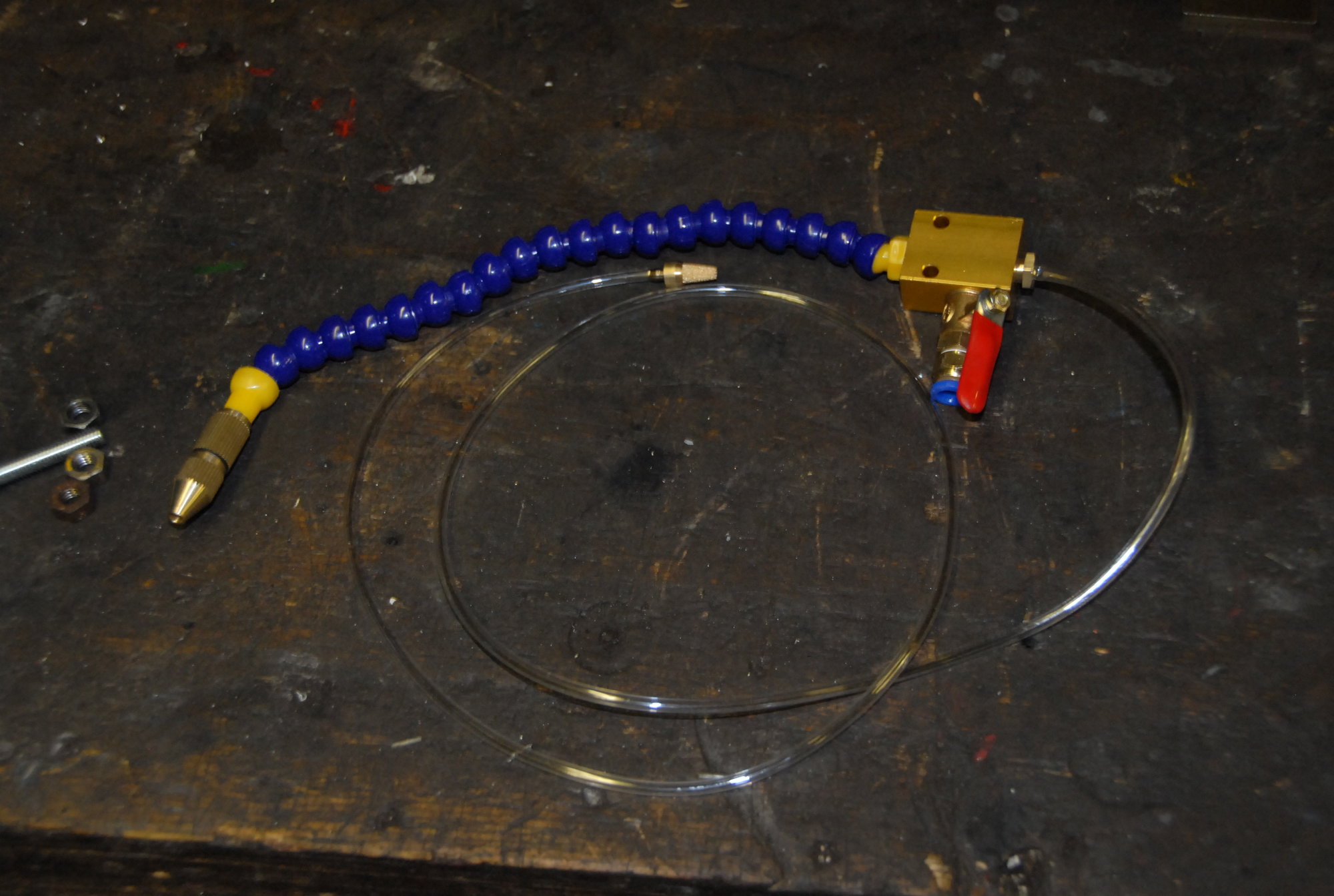

Just a quicky for those drillists that use a gutbuster or big drill for drilling holes in plant/steel etc away from the workshop, this little gadget is proving to be very useful for keeping bigger drills cool while drilling big holes. Good for blacksmith drills , big hole saws or any cold cutting etc. Knocked up this mobile suds pump with a B&Q pump up weed killer sprayer gadget and a mag mounted coolant hose ass , hose and everything supplied fitted the mag mount.
