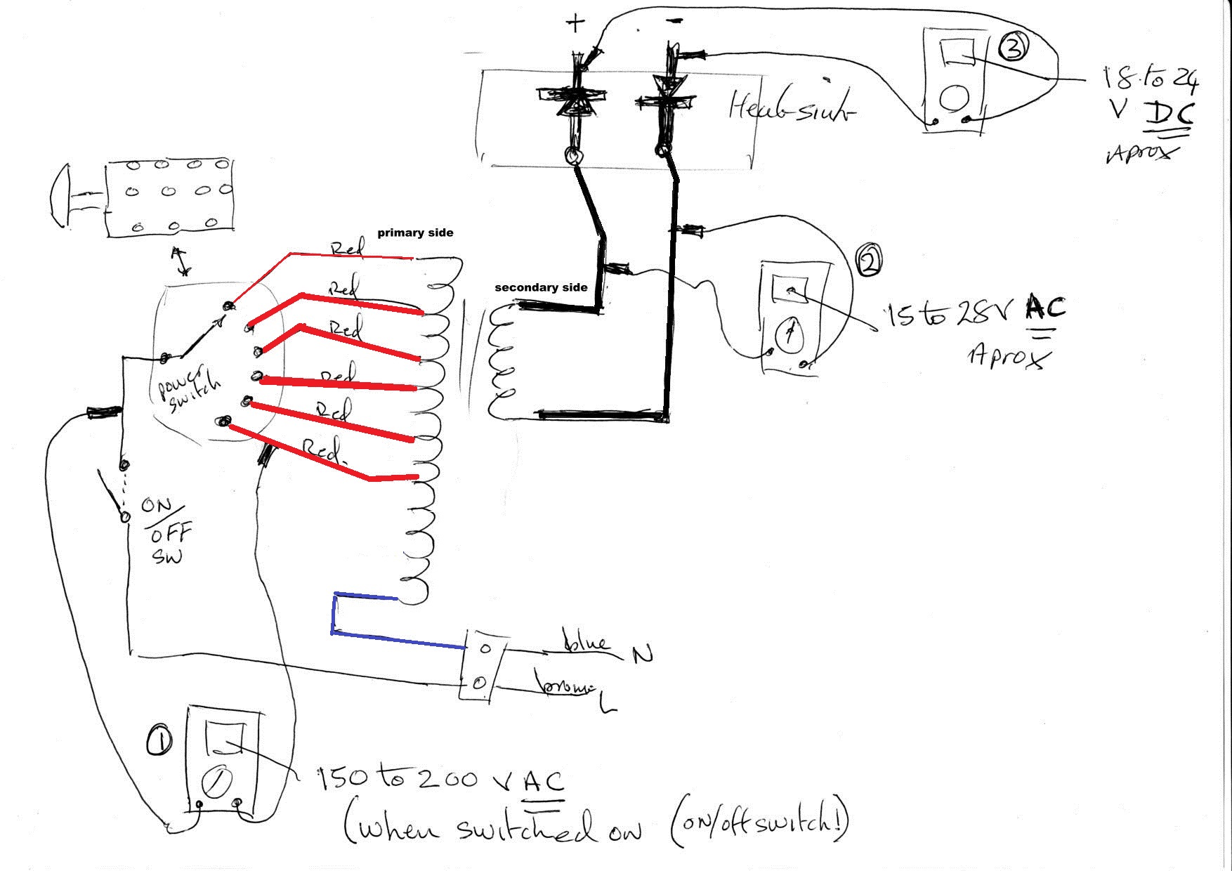

Hi guys wonder if any one of you can help I took transformer out of my machiene and forgotten which wire goes wherethe transformer side I've got the two out to the diodes but not sure of the other connection on the right still trying to upload picture cheers?
