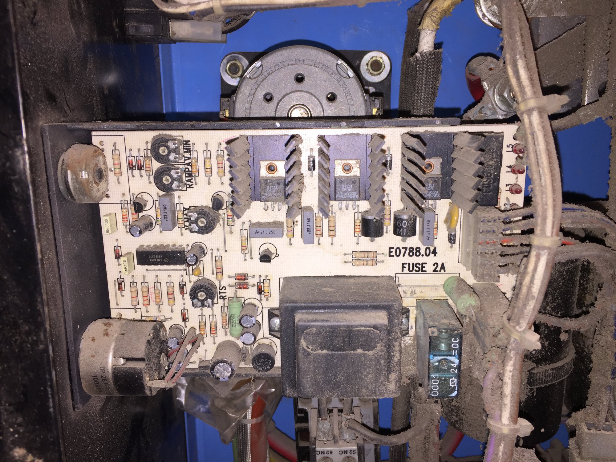

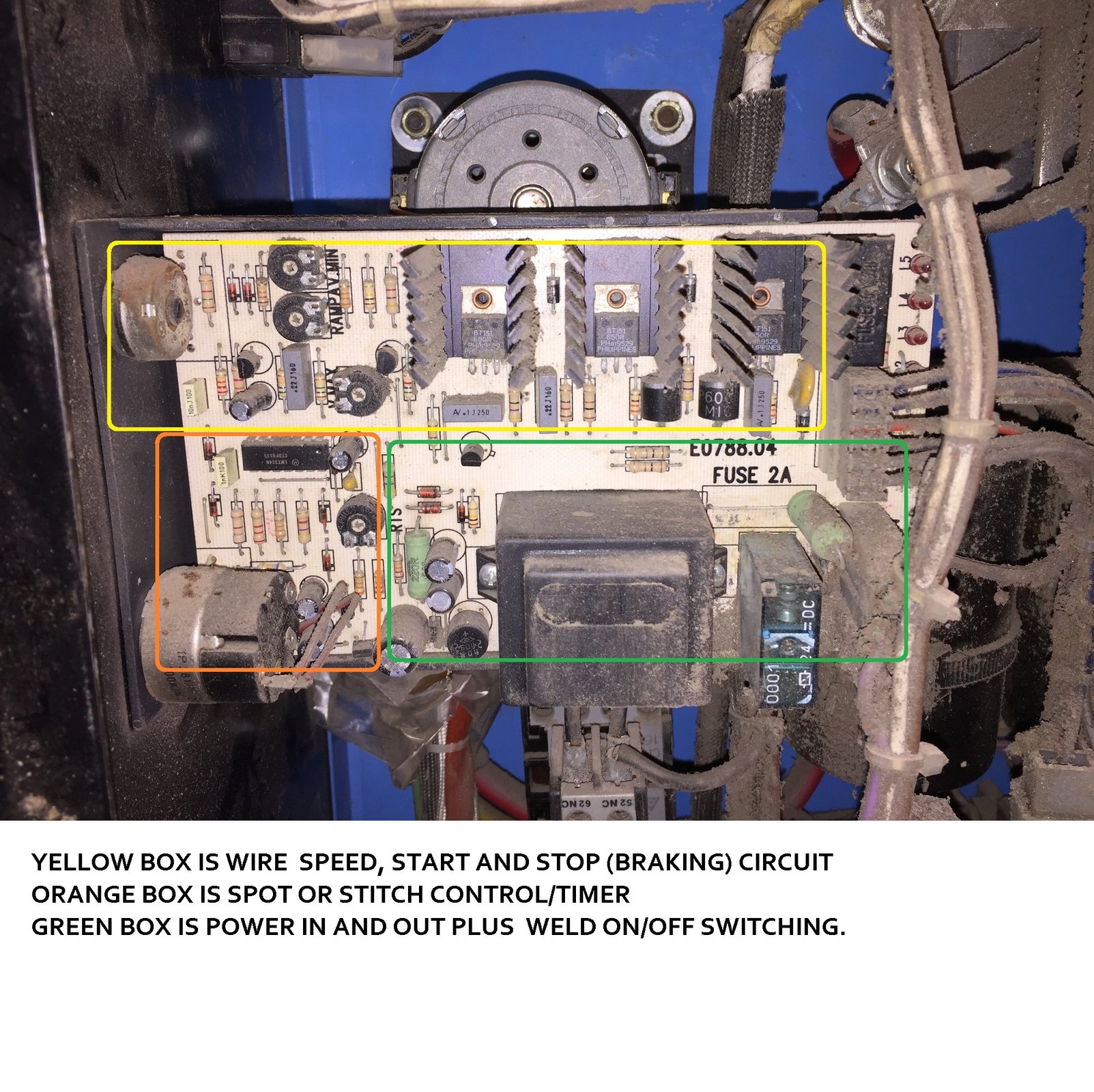

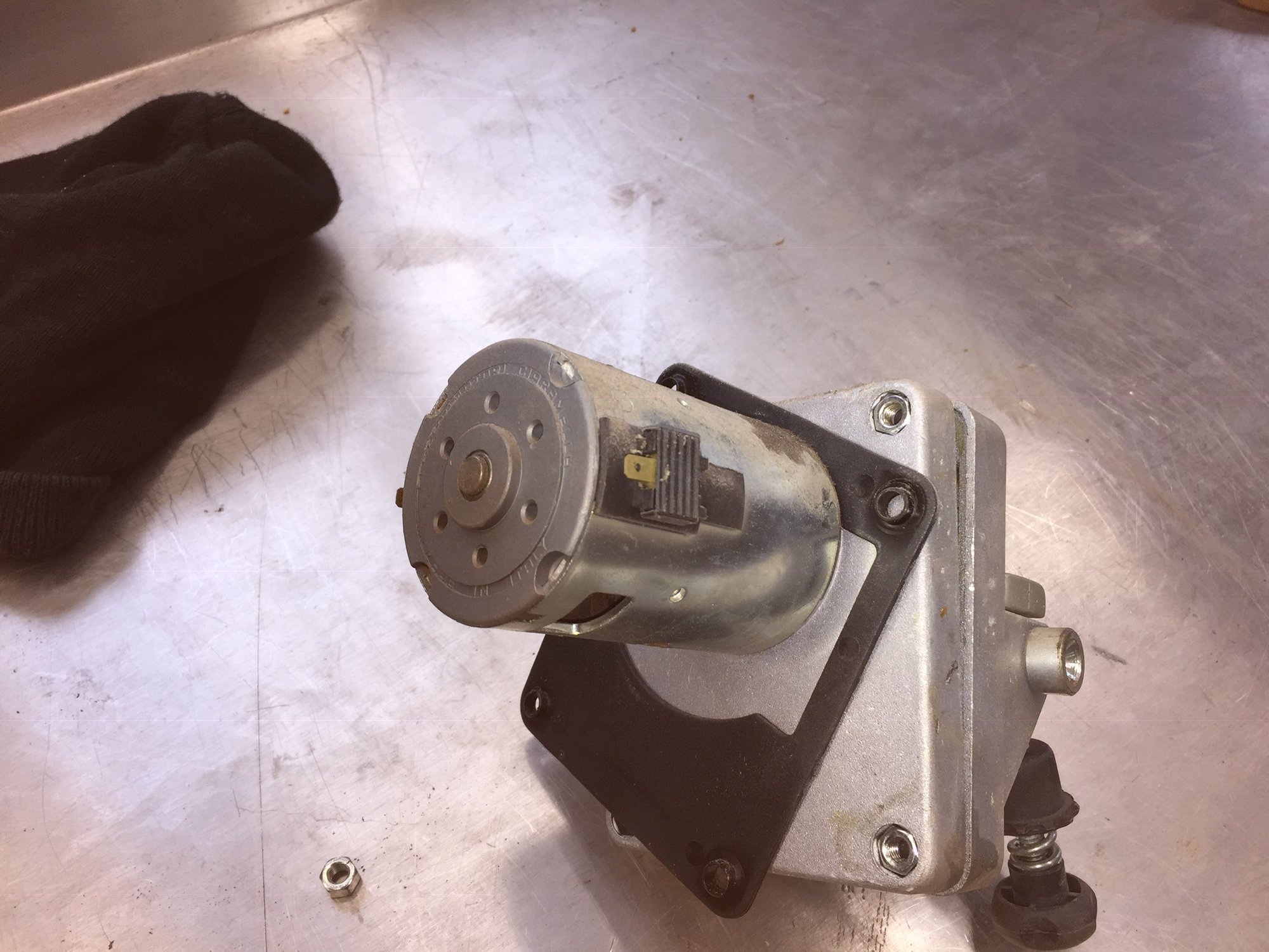

My Clarke mig 250t seems to be running the wire out too slow. When I try to weld at usual wire speed it doesn’t create a proper ark. I can get it to weld properly if I turn the speed up as far as it will go. Even with the roller not engaged it looks to be turning way too slow. Could anyone give me an idea what to look for.
