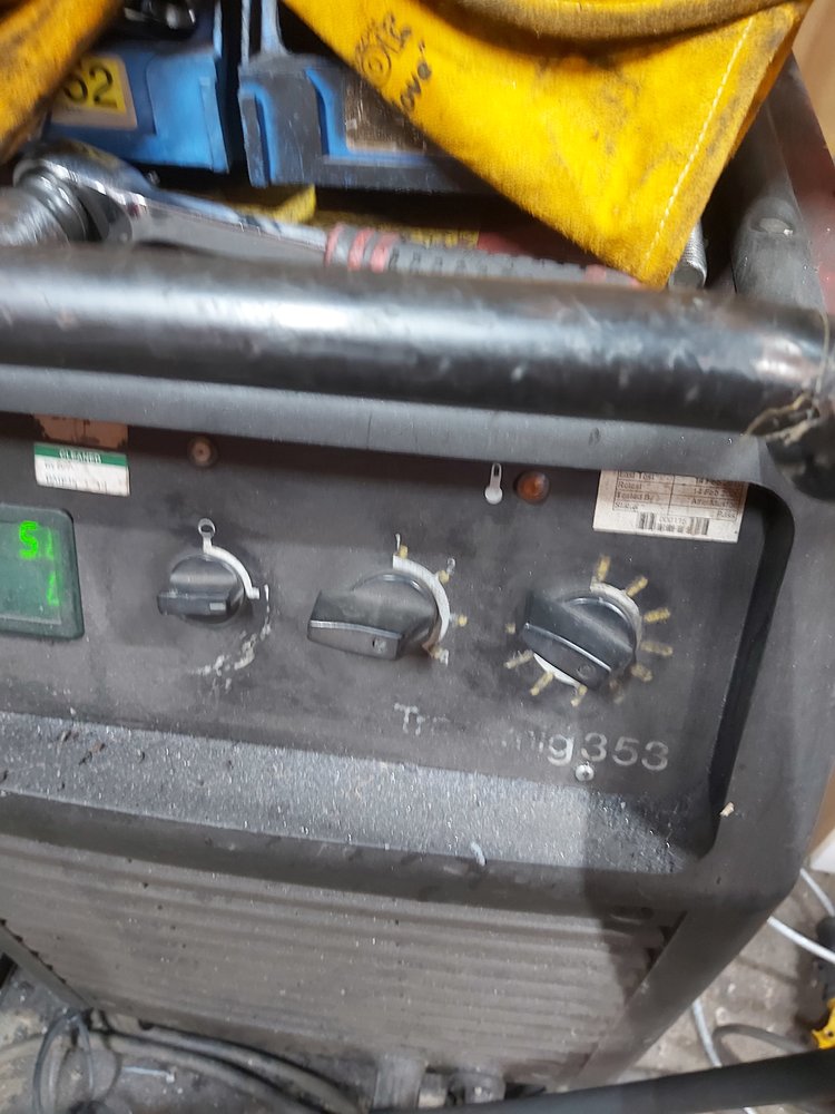

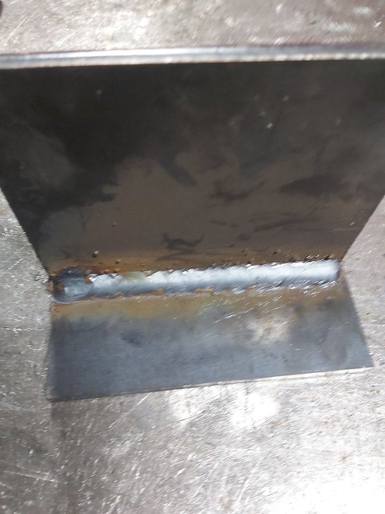

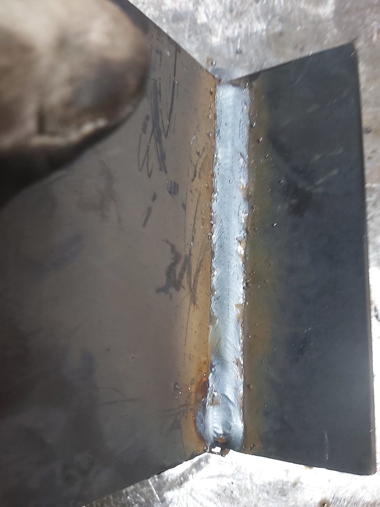

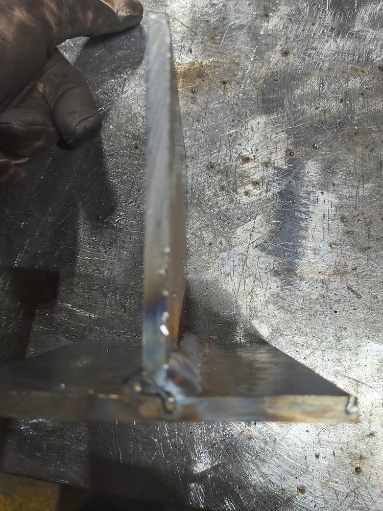

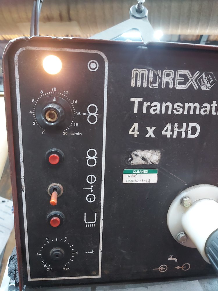

Hello guys I was wondering if I can get some feedback on a weld I did today, I used a murex transmatic 353 machine on 6mm plate, I have included pictures of the weld and the settings on the machine , I used a pull technique from right to left
Superficially it doesn't look too bad. I'm assuming your using bare wire with an inert gas - in which case you should push the arc as it'll give better penetration. The toes look a little cold and I would suspect penetration isn't as good as it could be, but you'd need to cut a section out to tell for sure. In fact, I would go ahead and cut a bit anyway and then probably notch test it.
