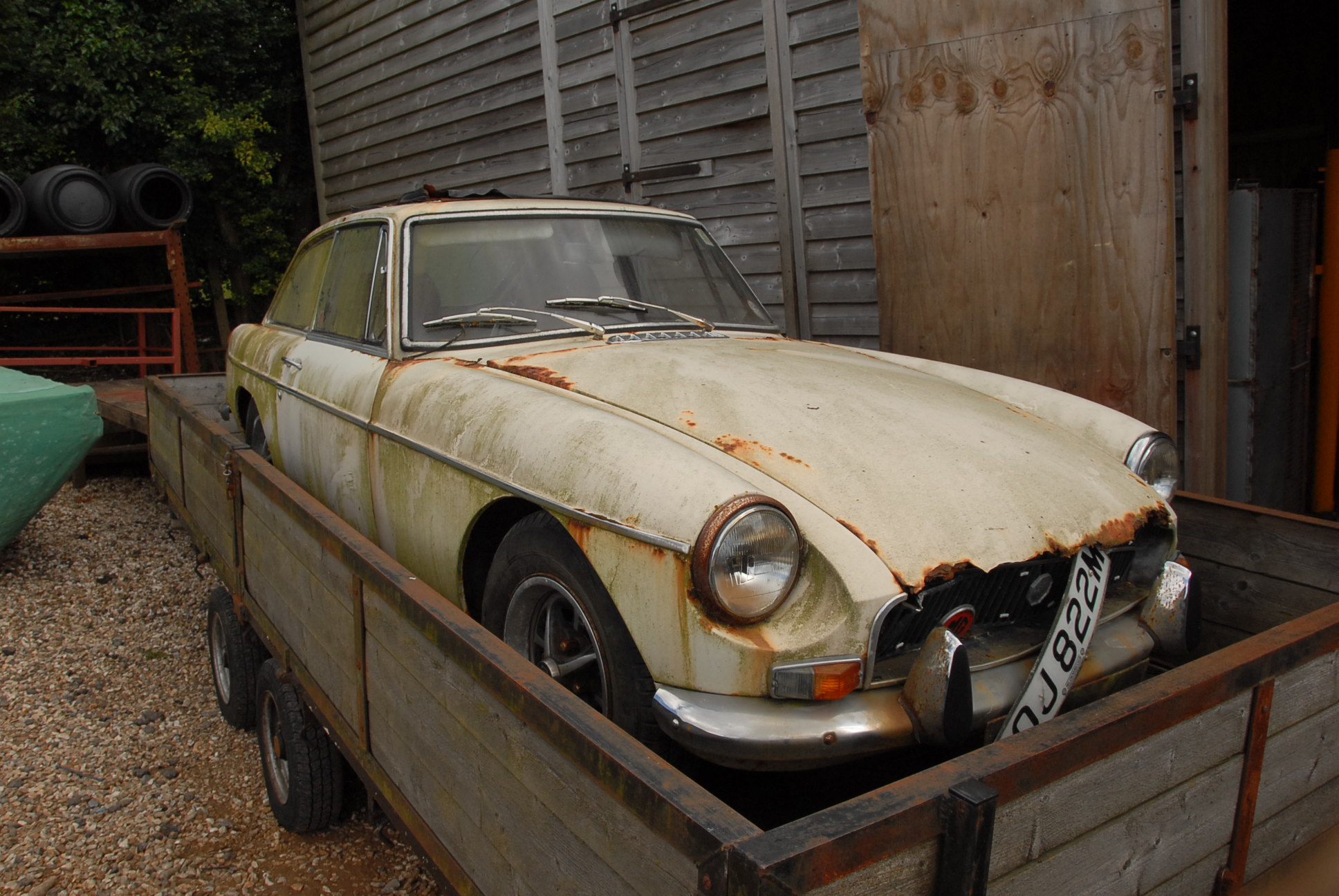

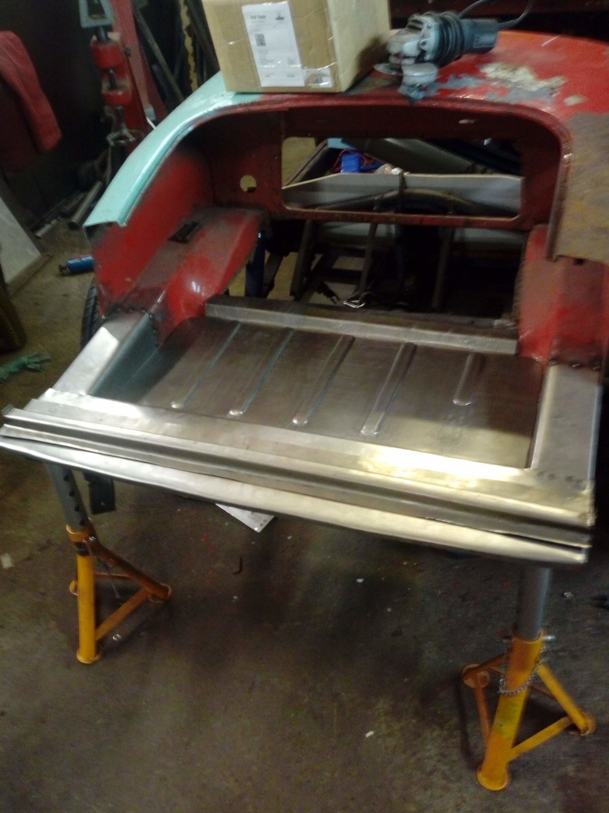

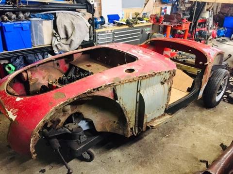

    This is not my car just giving the guy a hand but thought you would be interested
    Don't expect this to be done in a week its not Car SOS or trick my truck
    or do you not think it's not worth the effort?
    It's not a complete car but we have allot of bits
    MGB 1800 with mk1 overdrive gearbox
    All MGB running gear will change the wheels for 15" later
    The chassis is all good so that's a good thing
    Have some repair panels but the price of new panels is eye watering

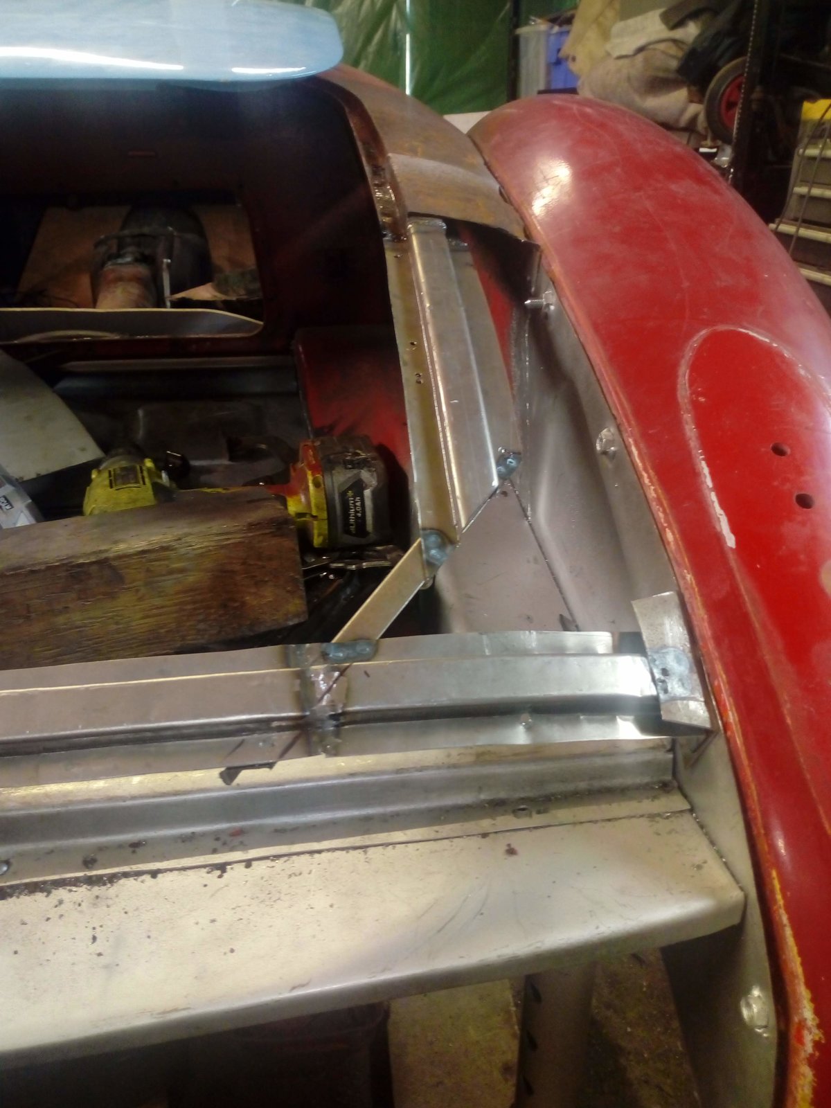

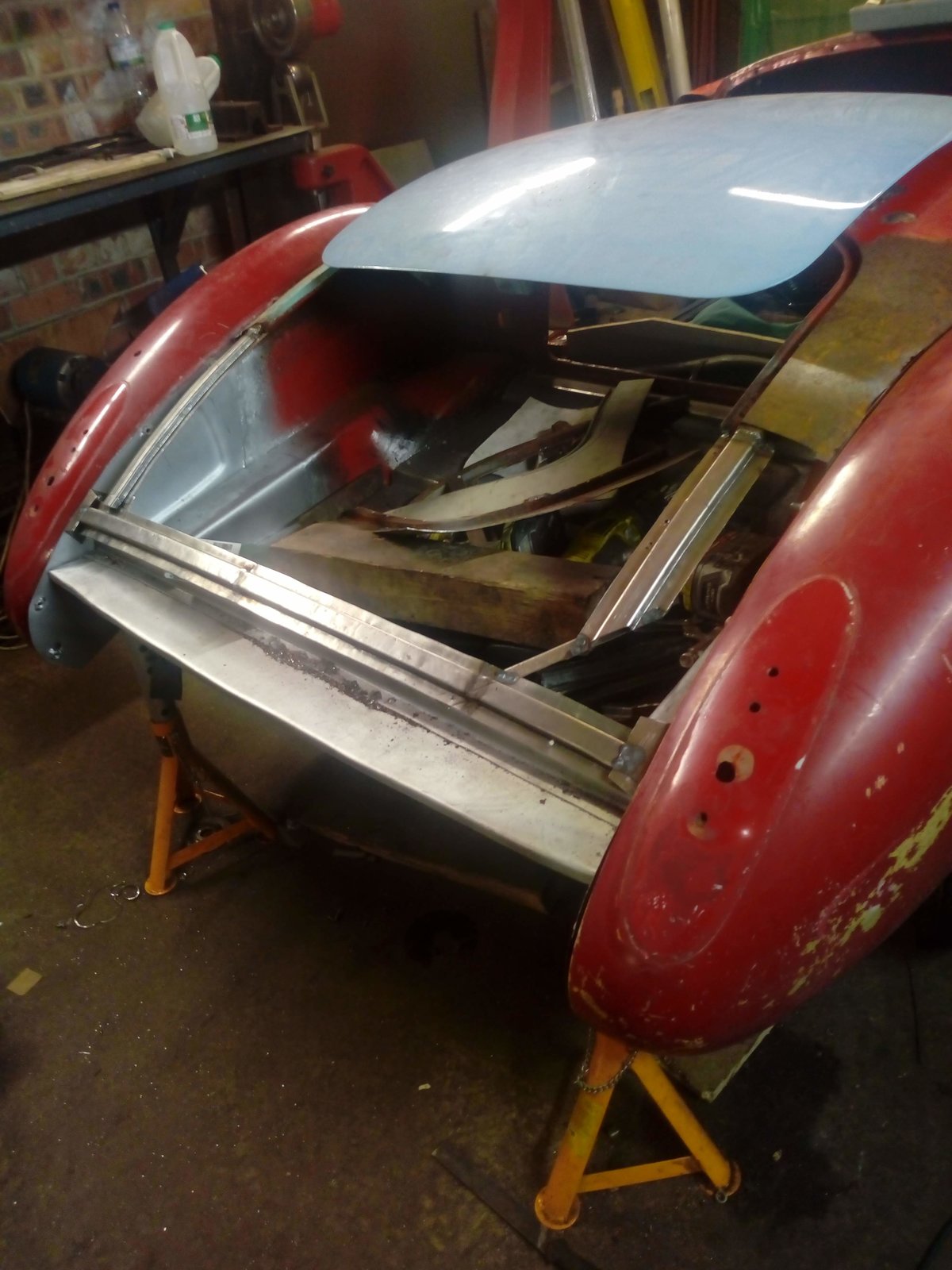

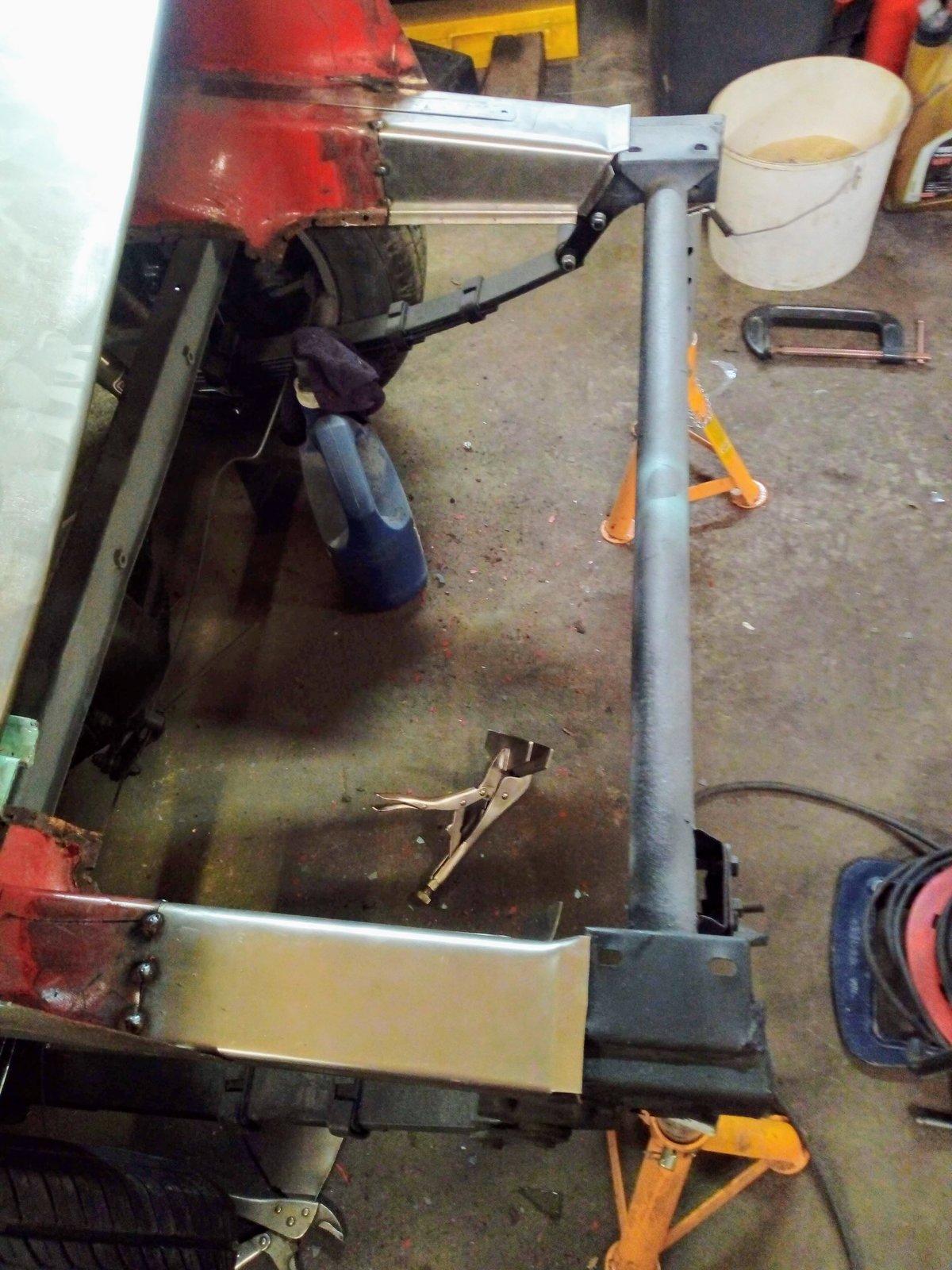

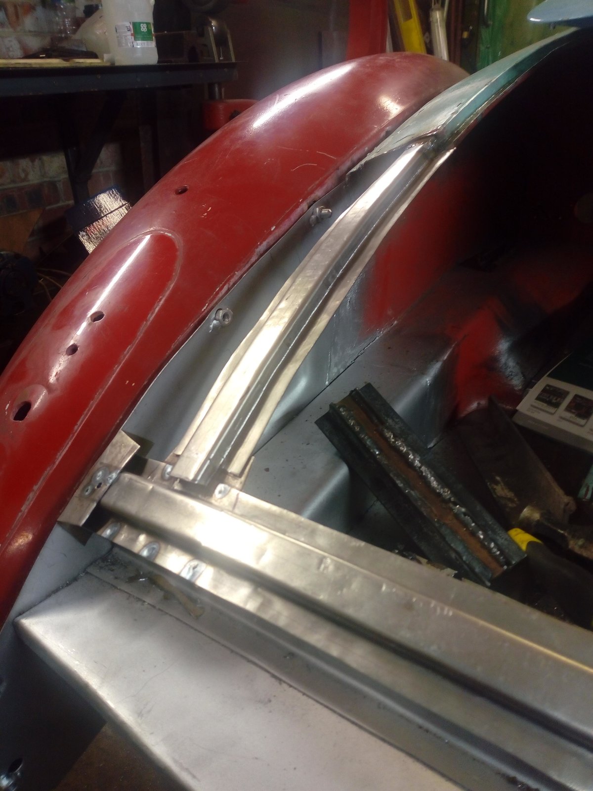

    Sofar I have extended the boot support rails
    Slight curve to rear of the car
    will see if I can give a weekly report i don't get along every day
    Mac

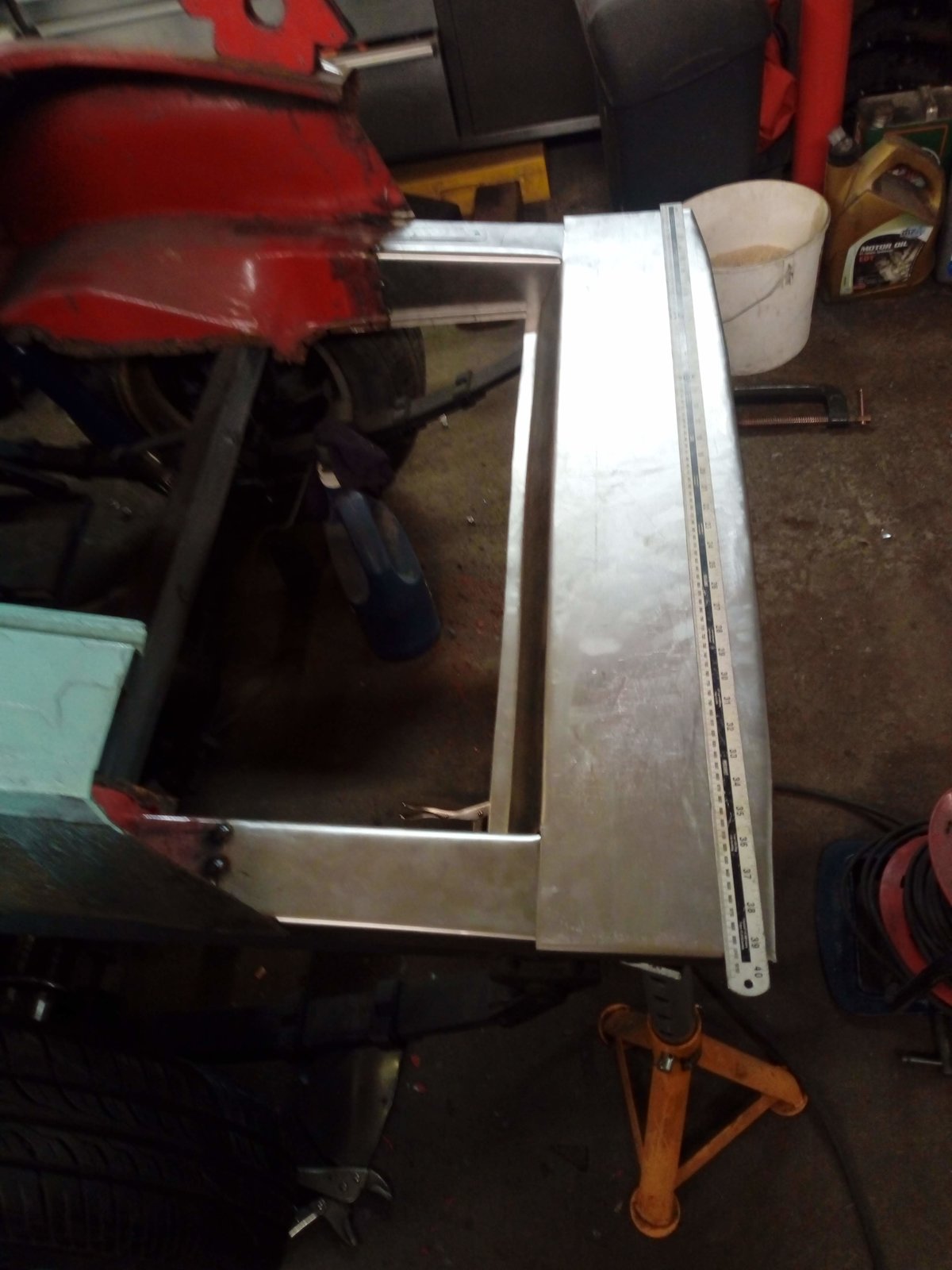

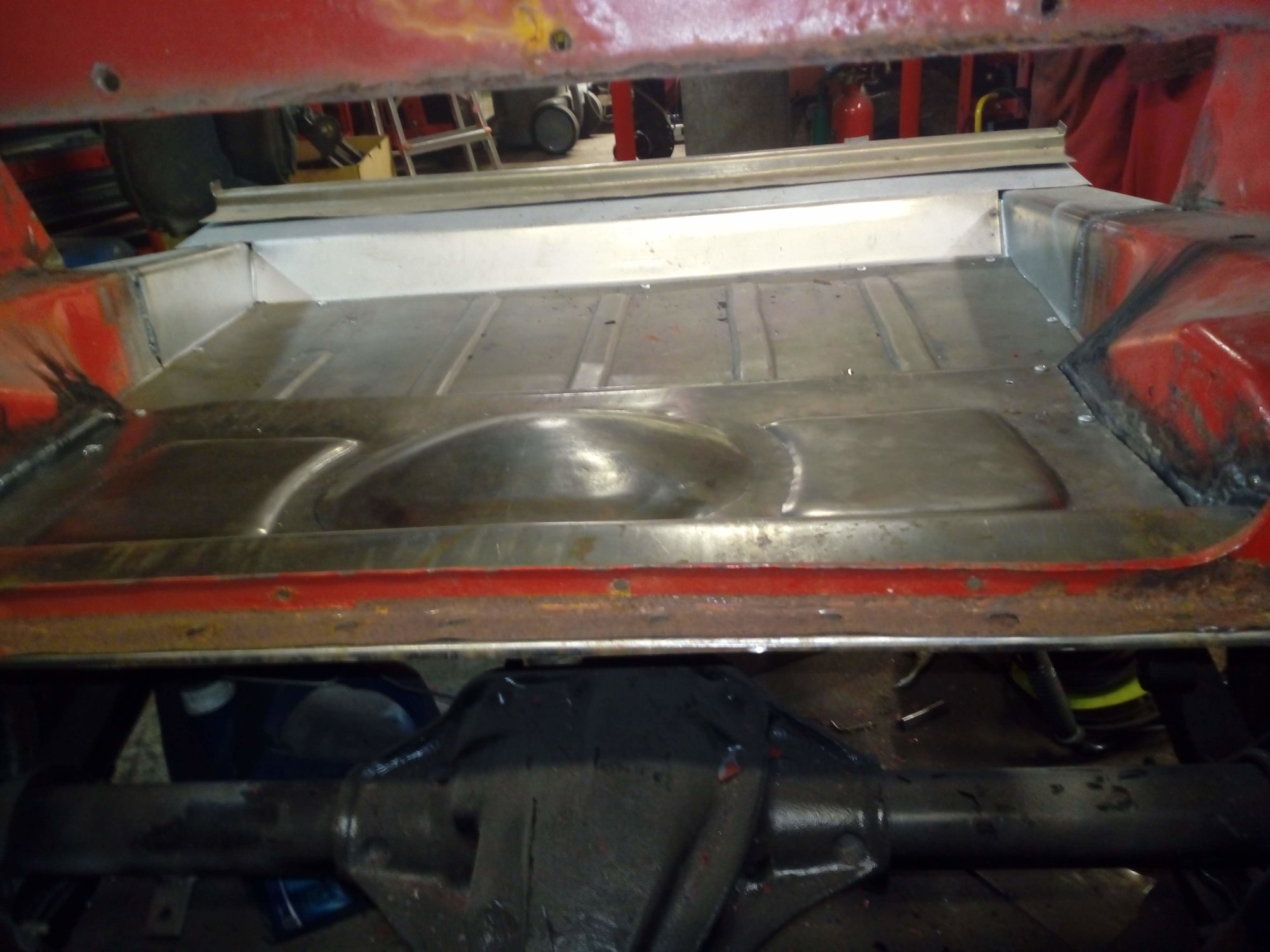

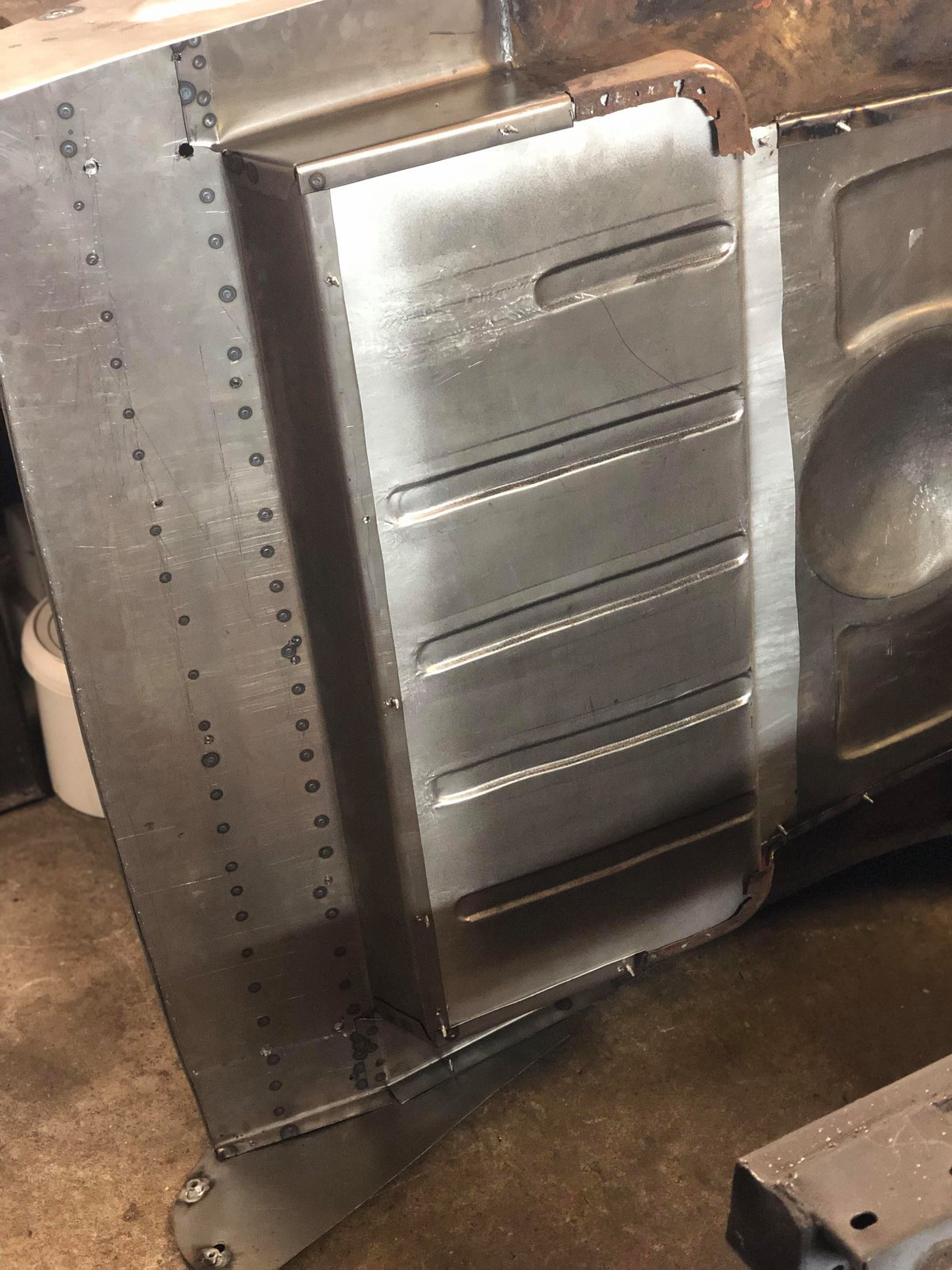

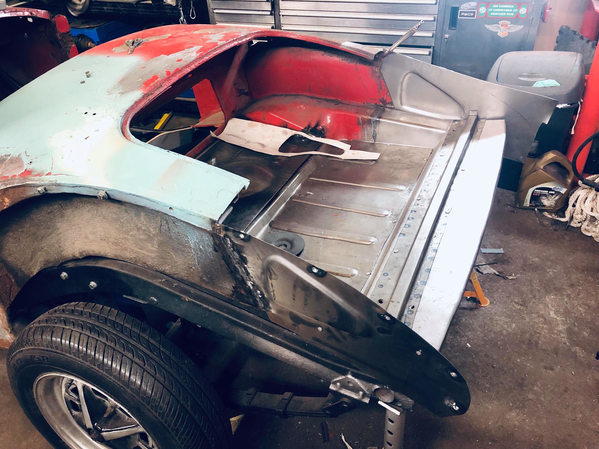

    managed to get a quite a bit time on the rear tub this week
    got the boot floor done and the rear stiffener nothing welded in just screwed down

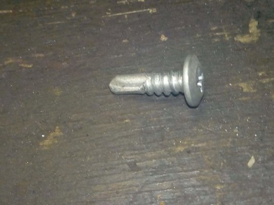

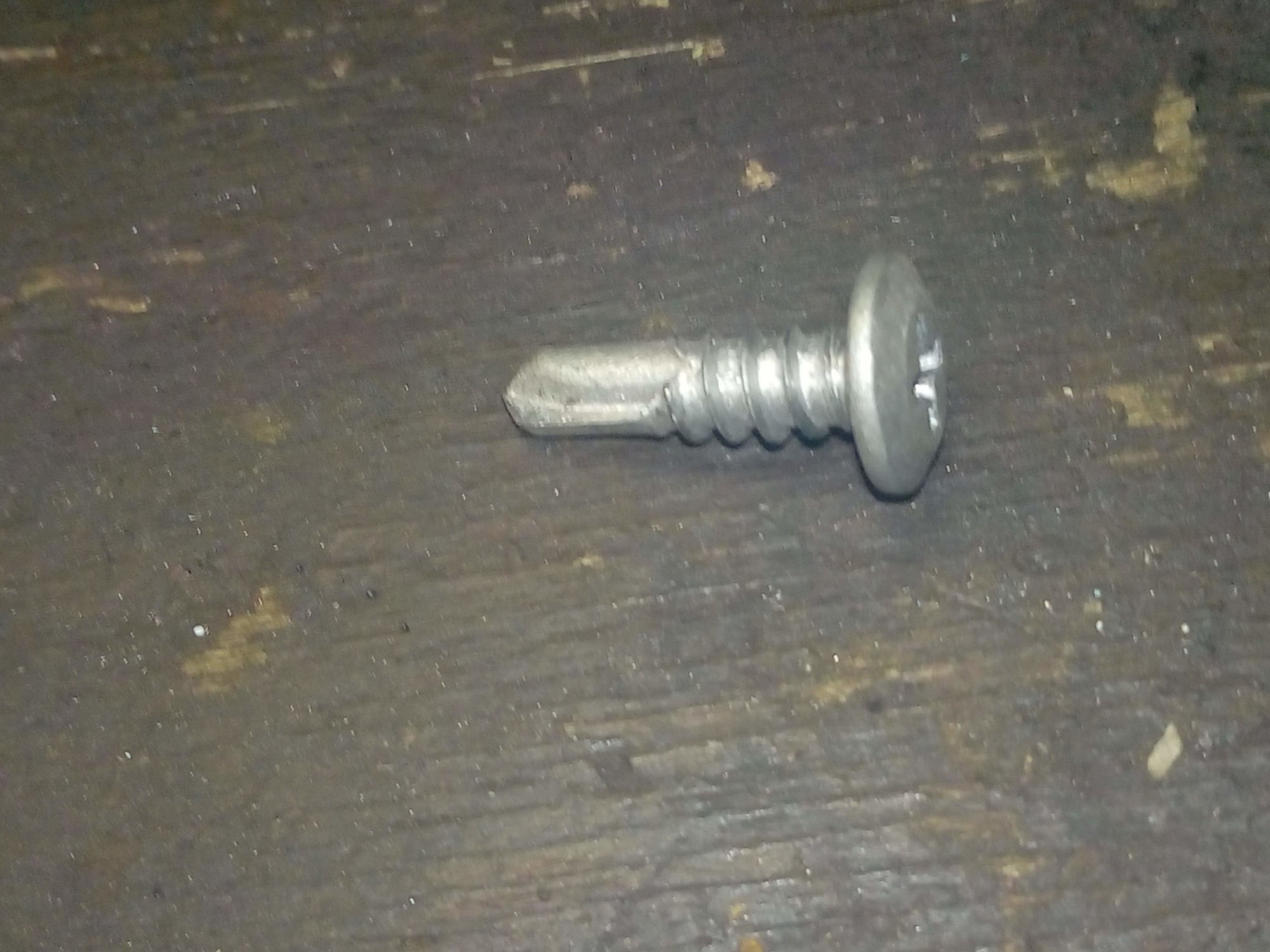

    got them from screw fix or toolstation
    I think the tubs been used as a parts car the way the rears been cut off
    Need to replace the flange for the inner boot floor its in pretty poor condition even though its been cut out with a spotweld cutter

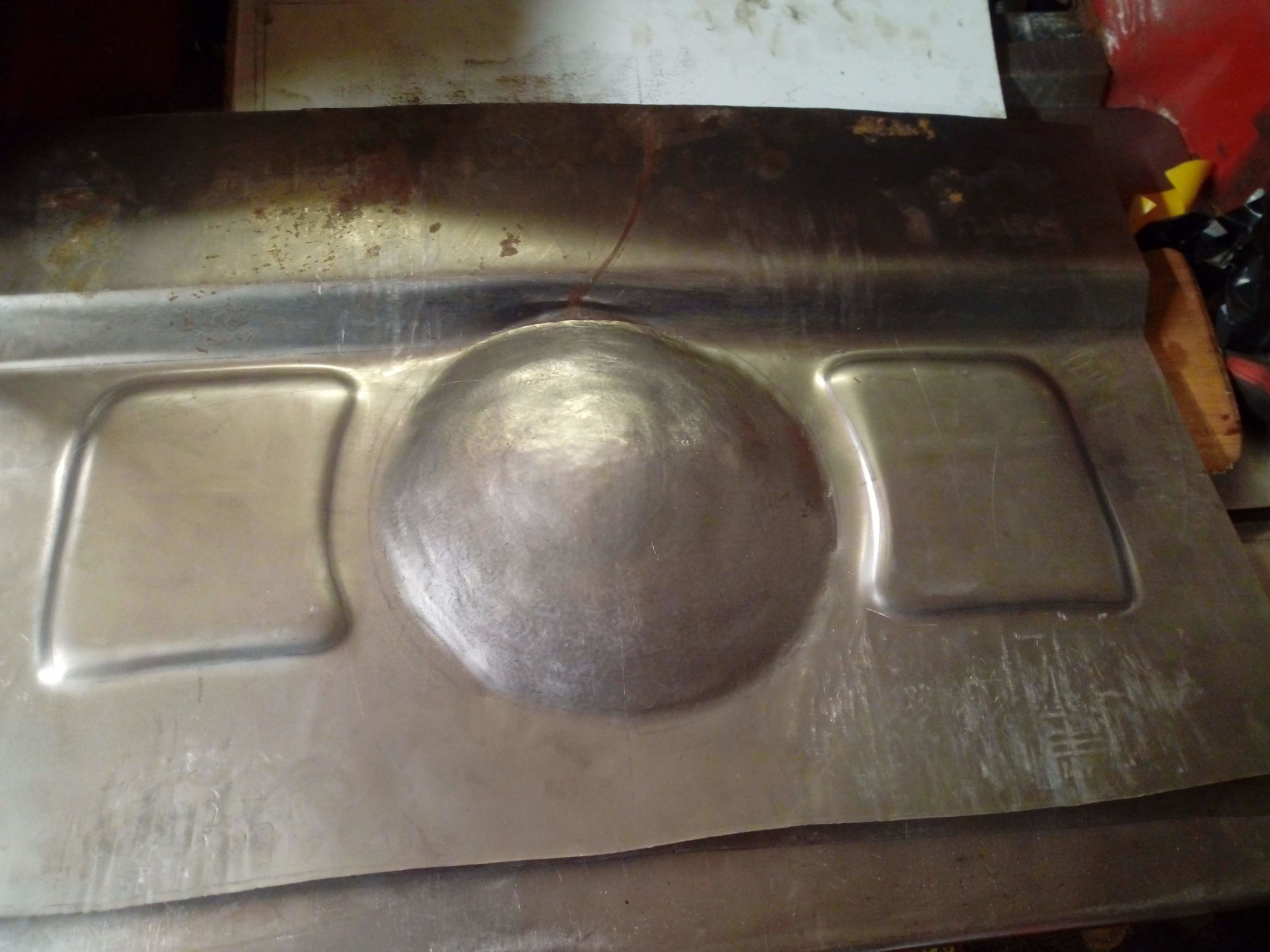

    Also got the rear boot floor made
    bit of a tricky one with the pressings either side of the dome then the flange at the rear might have a bit more fettling to do on that dome
    floor in place but only screwed down it might look out of level, just the angle I took the shot
    Well thats up to date think theirs a lot of fiddly bits to do now, like the rear shroud stiffeners and the outer panels
