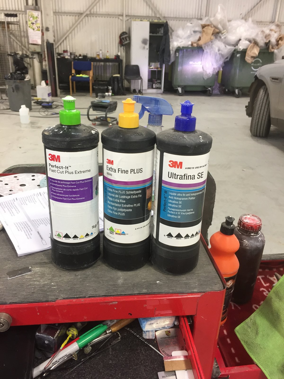

    Was thinking of final stage to use Autoglym super resin polish but read it’s got silicon in it, would that just cause me lots of headaches down the track?
  17. steveo3002 Member
    Messages:
    5,223
    cambridge uk
    yeah if its true then dont use that , plenty of bodyshop safe stuff like 3m available
    Burdekin likes this.
  18. jordan1 Member
    Messages:
    2,028
    Location:
    Yorkshire England
  19. Gingle
    Gingle Member
    Messages:
    79
    Location:
    Cambridge
    This is what we use in Bodyshop
    slim_boy_fat and Burdekin like this.
  20. Burdekin
    Burdekin Chief Bodger
    Messages:
    5,009
    Location:
    Aberdeen
    Thanks. I bought some Farcella G10 to try. It's cellulose I assume so thought I'd go gentle first and see how it goes. I looked at the 3M pack, just thought it might be a bit too aggressive for Cellulose but just an assumption.
