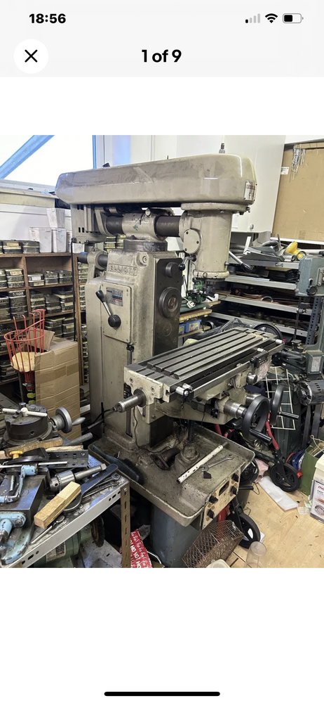

I was tempted by this machine but the missing handles put me offHi there,
I’ve just purchased an Elliott Omnimill 00, can someone please share the link to the manual ?
Thanks,
Stefan

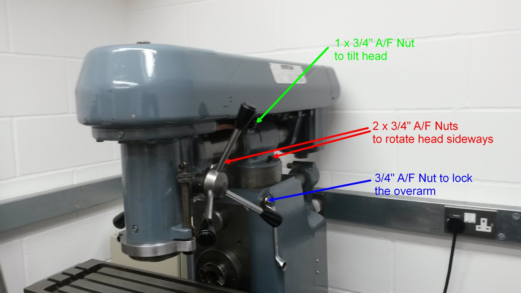

Wondering if anyone can share any manuals they may have
There should be a nut at the top of the column on the right side, the one at the end of the blue arrow. Loosen it and give it a clout with a deadblow hammer to free the clamp inside. Use the arbor support to give you some leverage to twist it to get it free. If it's not been moved in years, expect it to be tight!I am having a hard time getting the overarm to move and I can't find any sets or clamps
