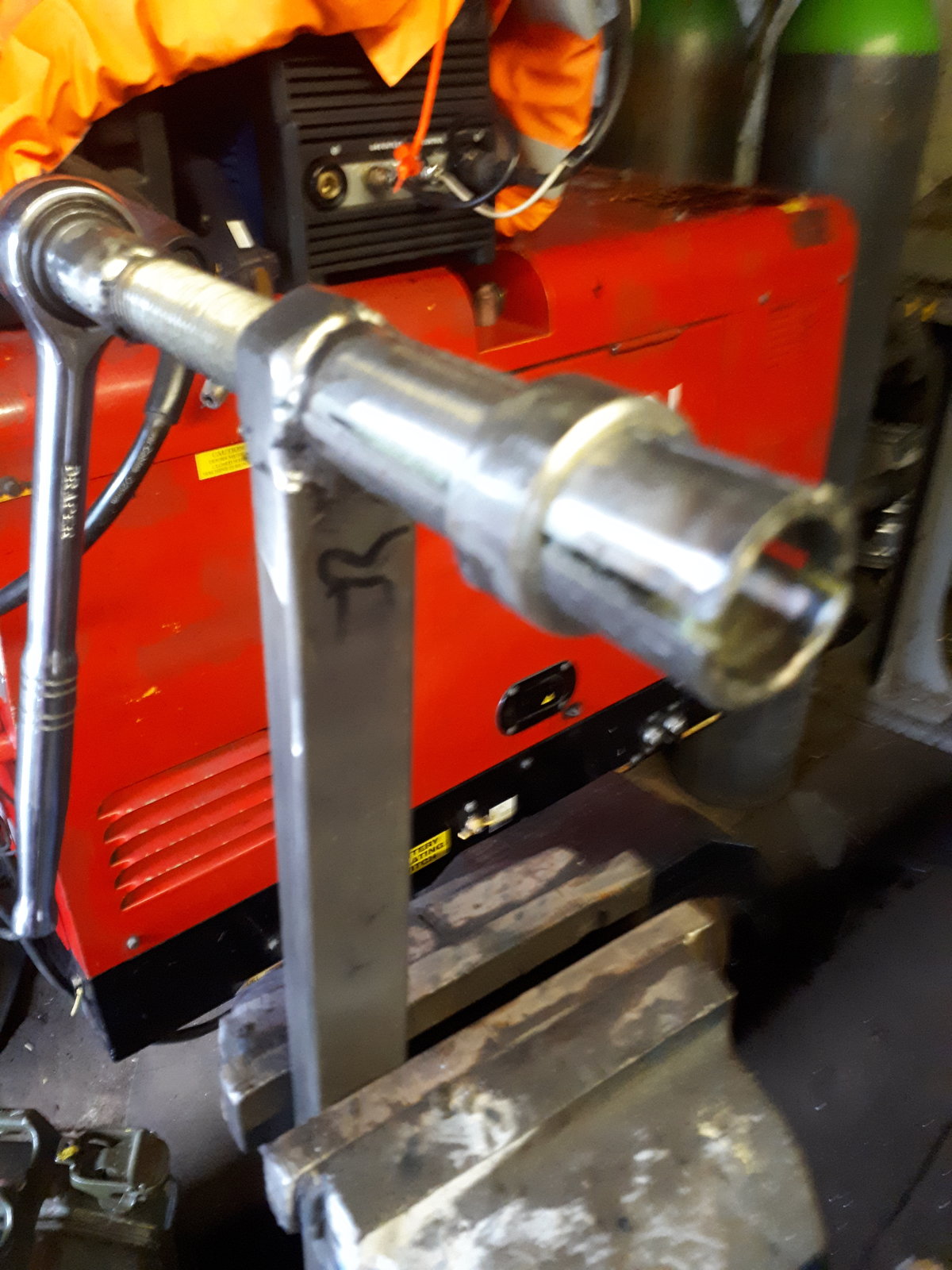

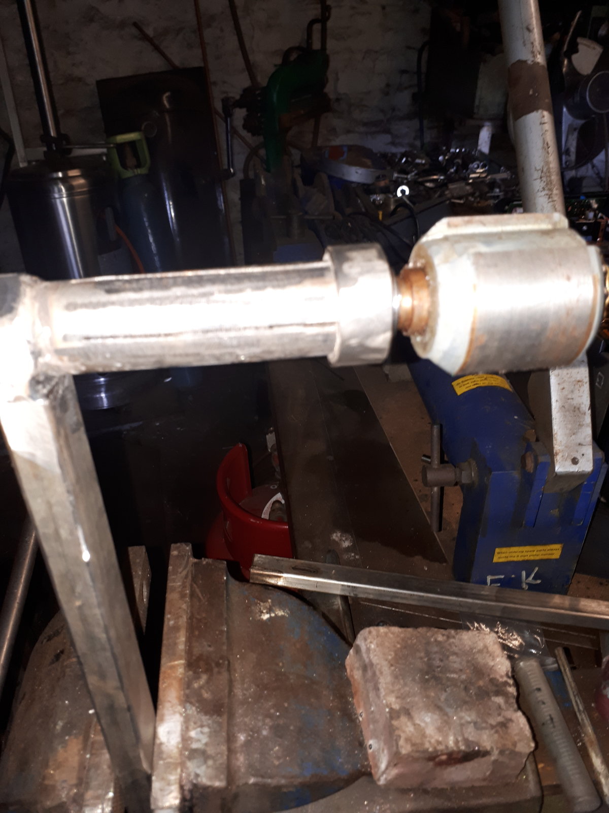

Cobbled this up out some scrap 316l the tube fitted neat over the inner race so i pulse tigged a bead inside to mimic the balls making it roughly the inner size and radius the tube was split linear at 4 points to allow it over the outer od and /A
] piece of pipe was added to slide over and contract the 4 sections snugly on the race a screw thread locates in to the centre drilling on the shaft and pushes the armature off
