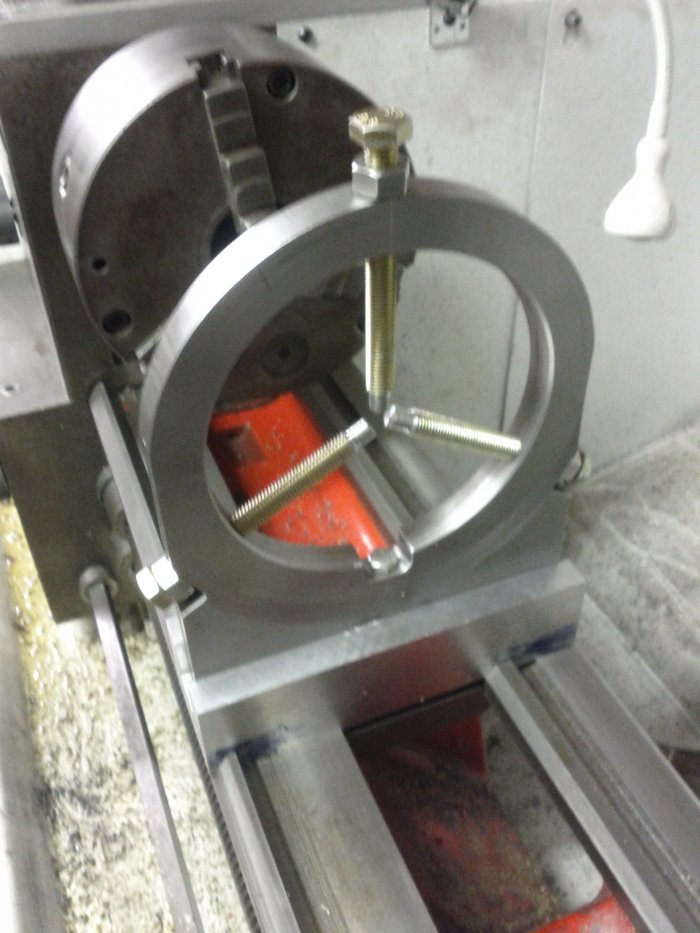

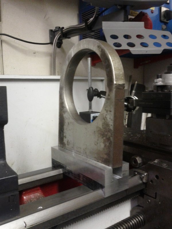

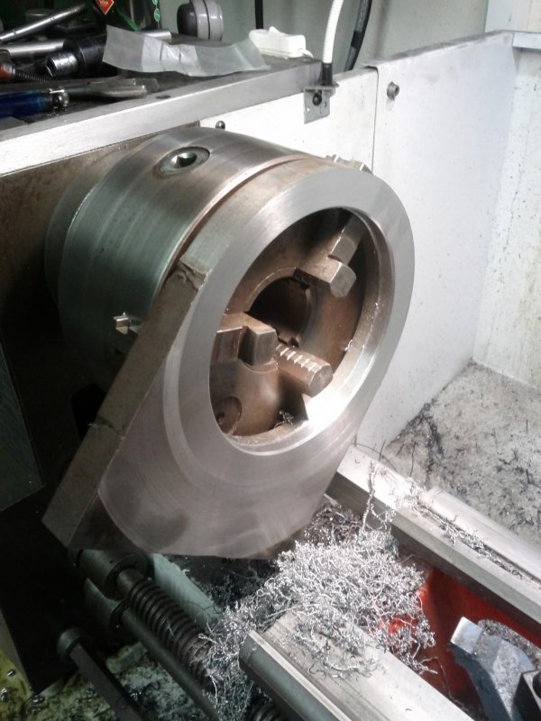

What did you make the round part out of??Just about finished, this project, just need the ends tapping for M5 so I can fit replaceable brass ends.
Throat size is a whopping 155mm.
Currently doesn't need to open as it's only going to be used for short pieces.

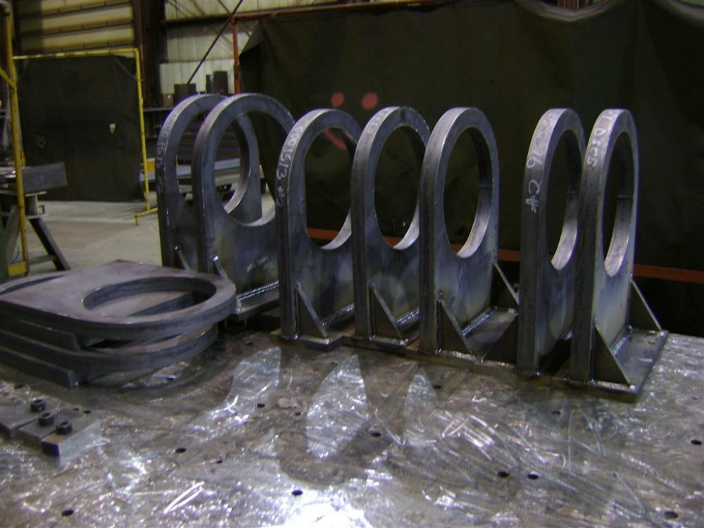

I cant find any plate on ebay it looks like asking around. Having said that it is not an imminent project so I have time to look around. lolVery nice!
