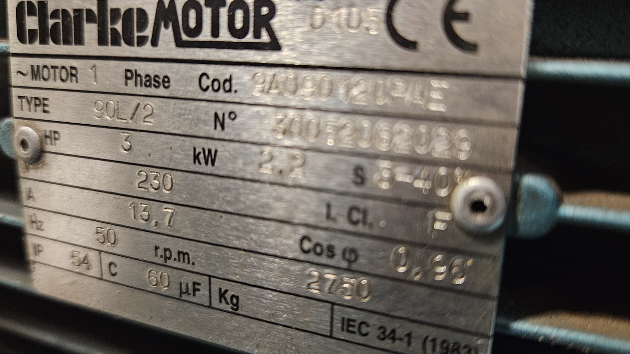

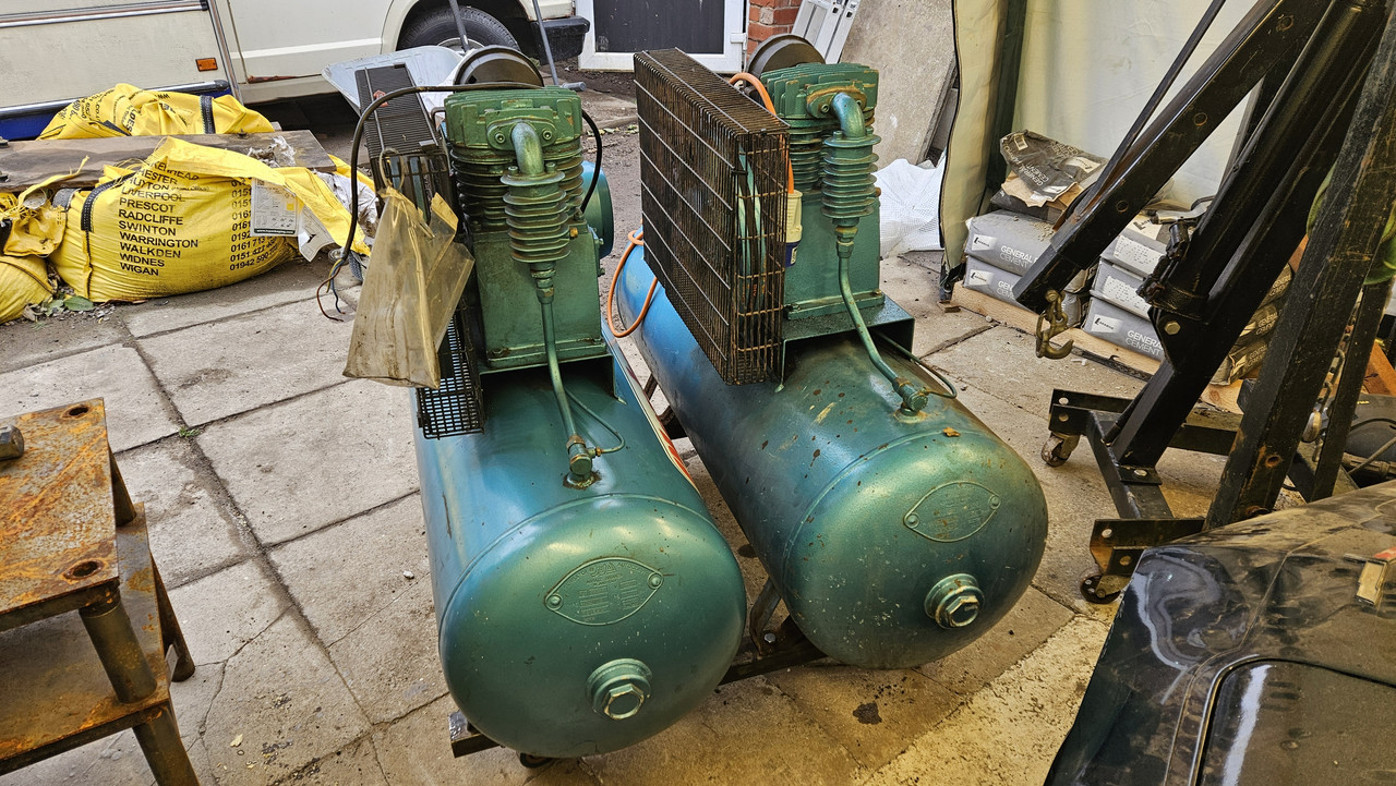

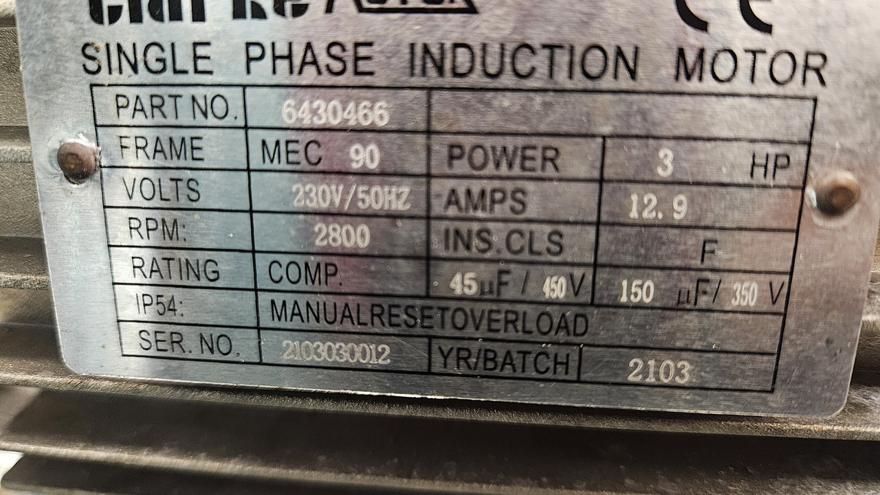

I have done this before but with smaller compressors. Now as these are a lot bigger than i had before i was wondering how to power them. I am running one from a 32amp MCB. Also just checked the motor specs and there slightly different. No big deal i dont think.. ?
The one i had originally has this motor which is a replacement
Then one i collected today has this original motor fitted.
Garage is running from a 62amp DP rcd CU in the workshop ( 10mm T&E ) and feeding the 40amp MCB. CU in the workshop which i6s then fed from the 32amp MCB to the 16 Amp Interlock Socket for the compressor/s
Whats best way to run them together then with what i have? Have a twin Interlock so each compressor can run from the 40amp MCB ? saying thsi as both compressors add upto 26.6amp so a 16amp Interlock is no good ...yes ?
