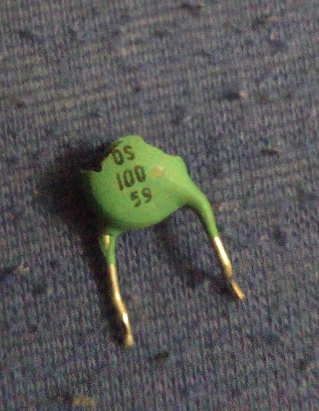

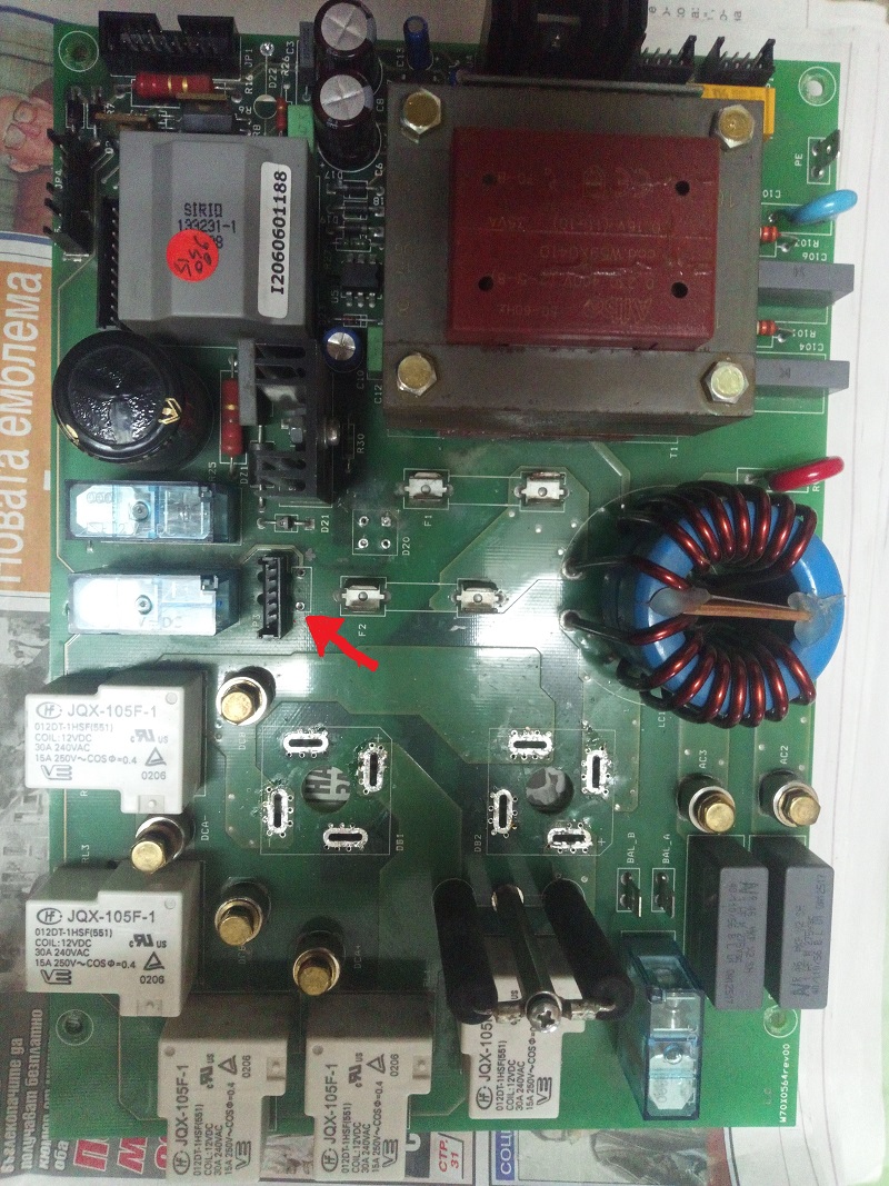

E Eaglextz New Member Messages 12 Location Bulgaria Mar 22, 2020 #1 Hello guys,can anybody help me to indentify brocken part of power supply board Lincoln V205-S 2V,i attached photo of board with red arrow show possition,and picture of brocken part.

Pete. Member Messages 14,137 Location Kent, UK Mar 22, 2020 #2 MOV perhaps? https://www.switchelectronics.co.uk/passives/varistors?limit=all
E Eaglextz New Member Messages 12 Location Bulgaria Mar 22, 2020 #3 Maybe ,but i don't know value ... i can't find any board diagram for this model
Seadog Save the planet. It's the only one with rum! Messages 11,438 Location NE London - UK Mar 22, 2020 #4 Is there a schematic reference number on the pcb? I can't tell from the photo due to glare.
Pete. Member Messages 14,137 Location Kent, UK Mar 22, 2020 #6 Eaglextz said: There is written R24 . Click to expand... That would make it a ceramic disc resistor IMO

Seadog Save the planet. It's the only one with rum! Messages 11,438 Location NE London - UK Mar 22, 2020 #7 I've never come across one. I think it's still likely to be a MOV.
E Eaglextz New Member Messages 12 Location Bulgaria Mar 23, 2020 #8 I am not sure how correct is it,but i try to measure with multimeter and he shows 28.8ohm.
B Bobbes Member Messages 230 Location Maarssen / Netherlands Mar 23, 2020 #9 It's a NTC of 10 Ohms. X0564rev03_Input Board.pdf 91.9 KB · Views: 111
