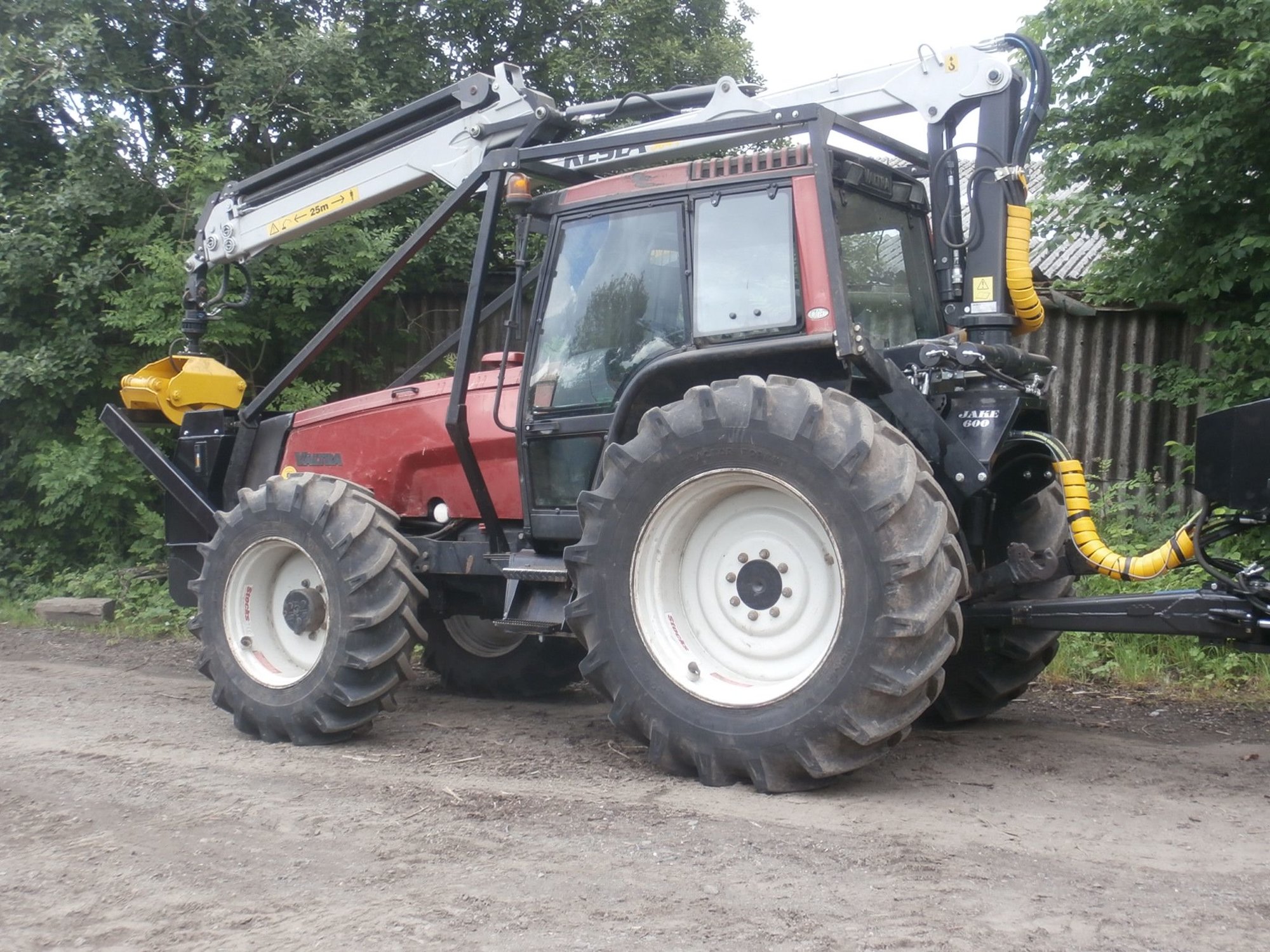

  3. addjunkie
    addjunkie Member
    Messages:
    4,818
    Location:
    Northumberland. Reet oot in the sticks
    IMG_0561.JPG Look at foresrtry tractors, plenty of them have hiabs fitted.

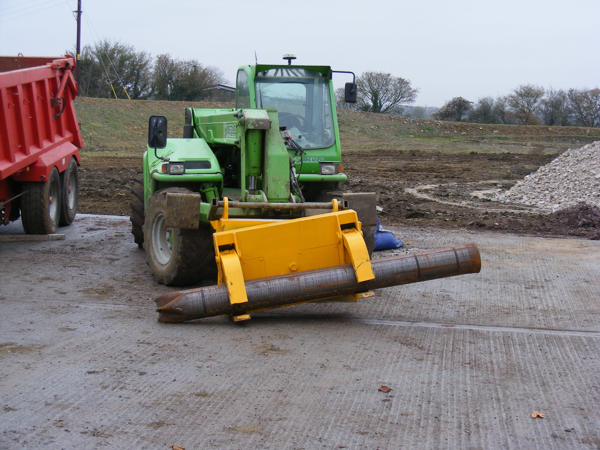

  9. 500e
    500e Always buy fire insurance a flood is hard to start
    Messages:
    3,617
    Location:
    Somerset UK
    DSCF0005-001.JPG Look at Merlo roto-telehandler we have 4 Merlows great tools 1 with the extra jib, road burners they are not

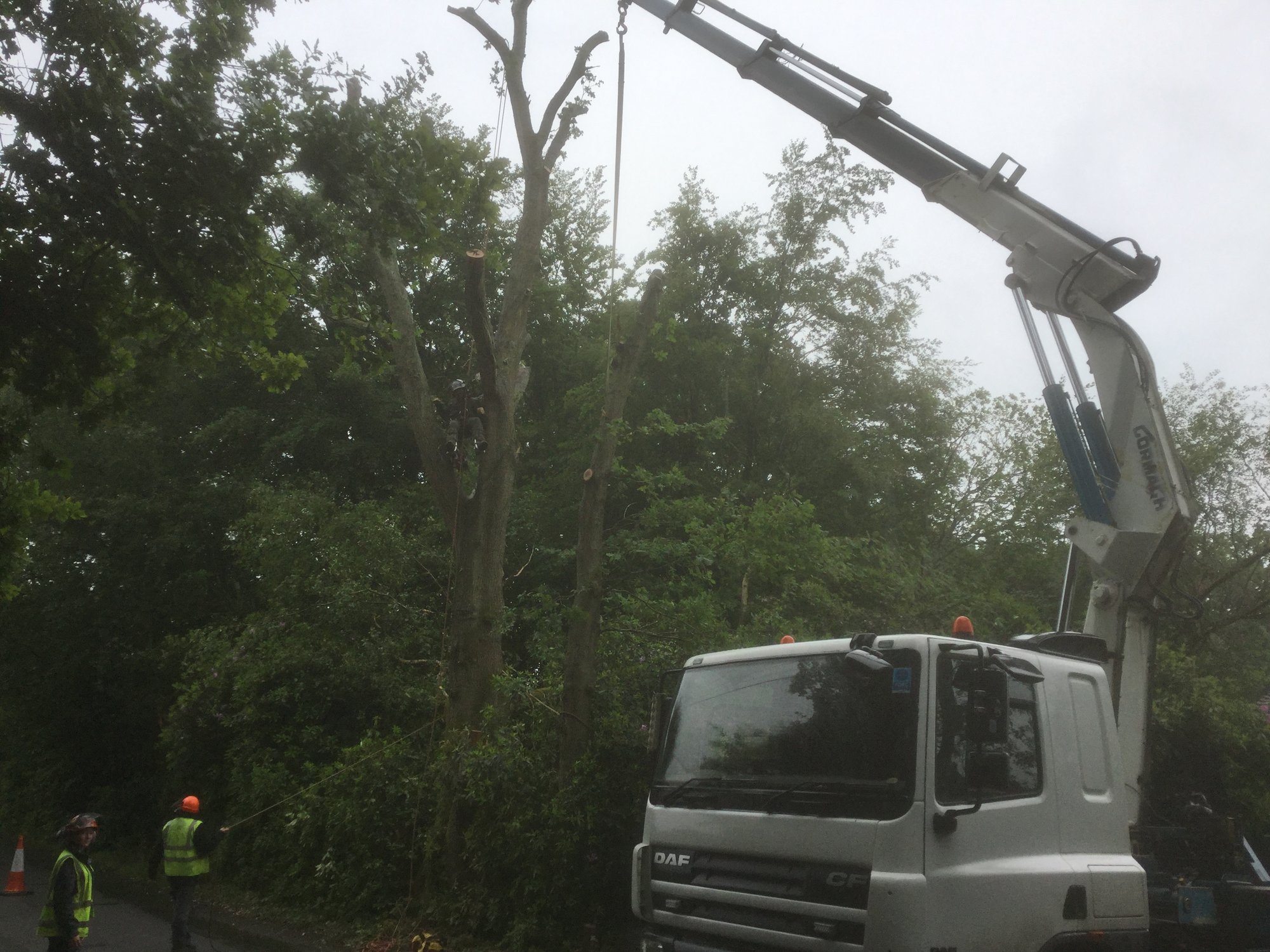

  10. slim_boy_fat
    slim_boy_fat Forum Supporter
    Is that you up the tree?
  11. 8ob
    8ob Member
    Messages:
    3,516
    Location:
    moscow on thames
    I am on the levers John, most of our climbers are about six stone which makes me eleven stone overweight :laughing:
    [​IMG]
