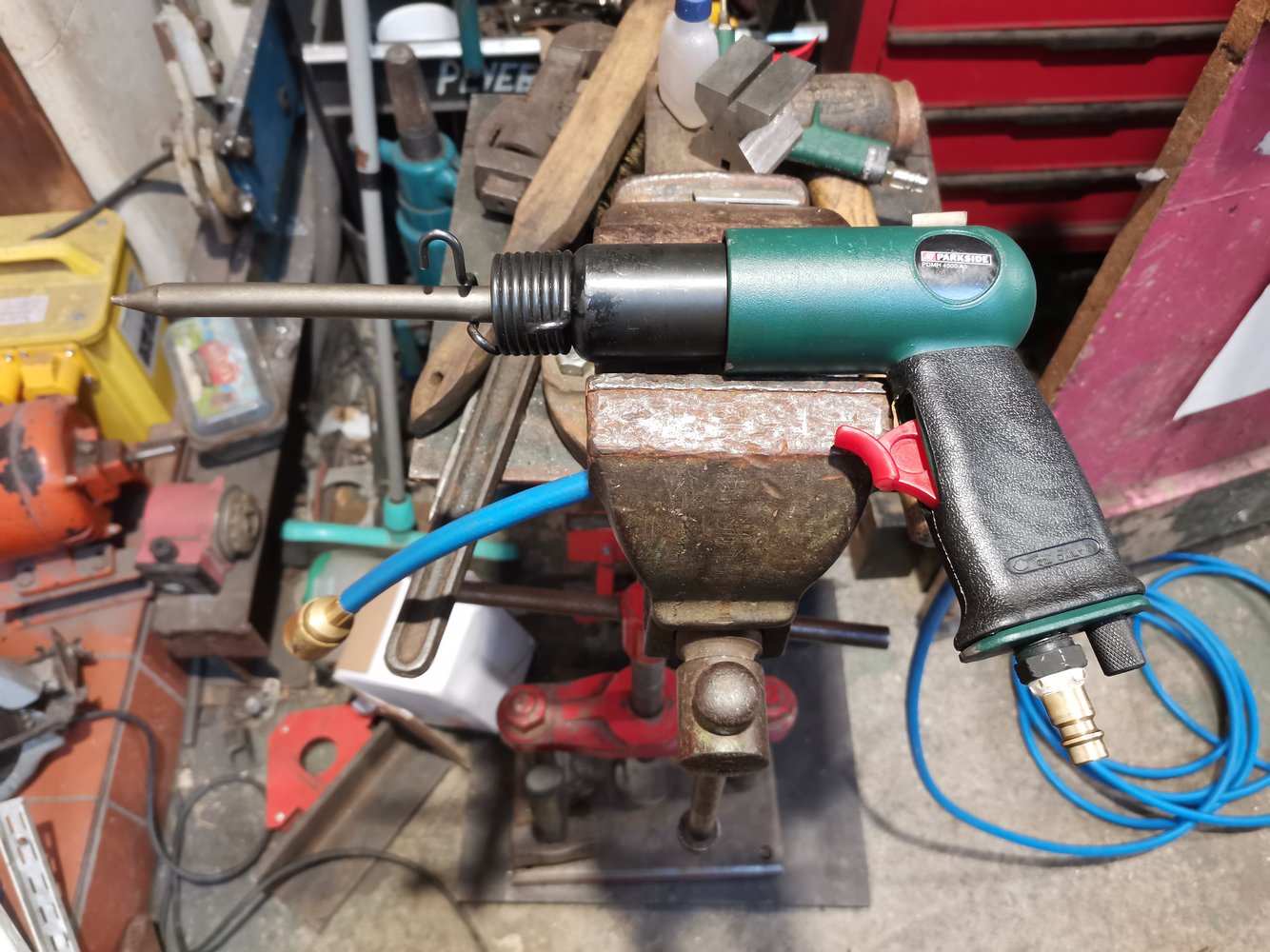

Mine stopped working last week and I haven't smashed that much stuff with it so I was a little disappointed but after disassembly I discovered a quantity of swarf and a tip from a broken drill bit inside after there removal it works again.
Insides are identical to this one the canadian guy takes apart.
