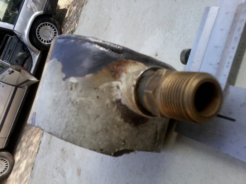

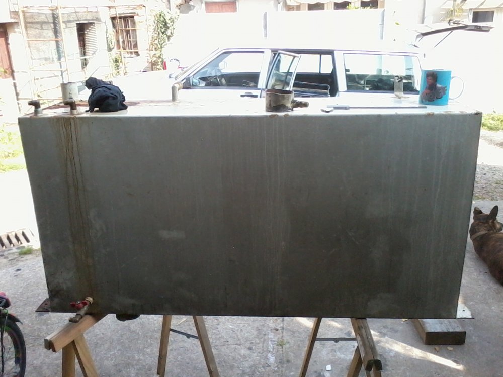

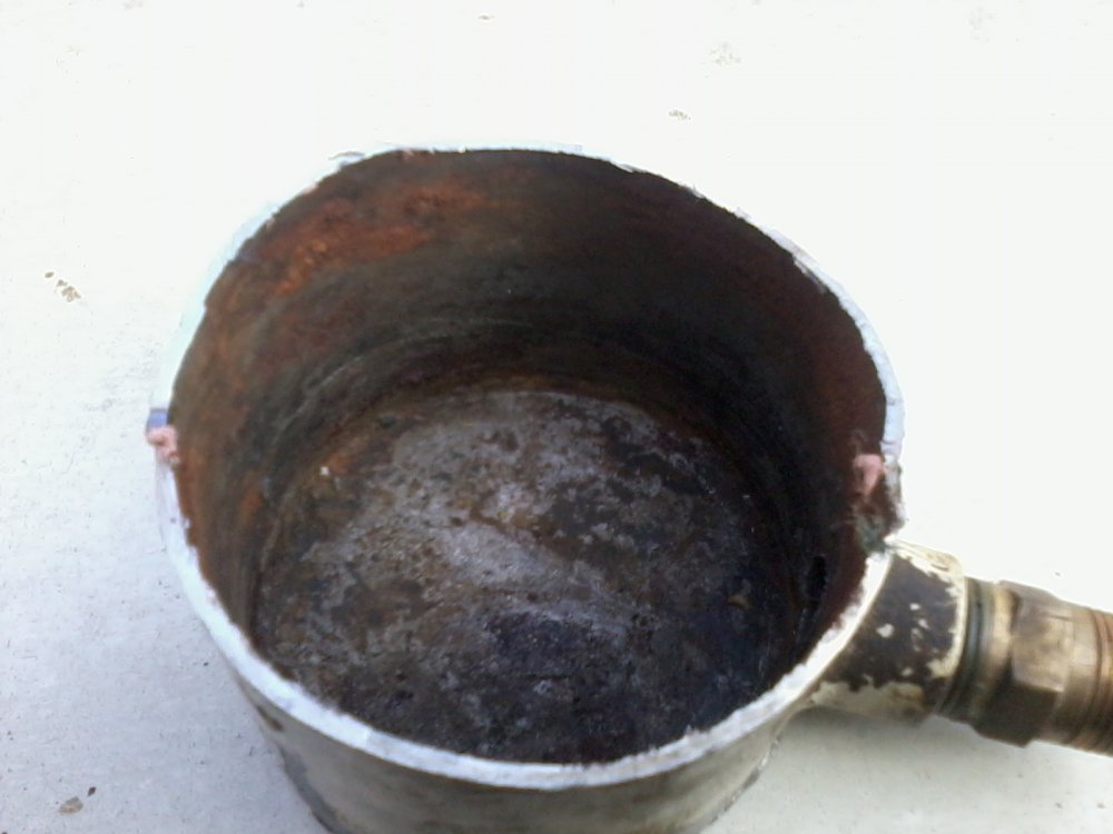

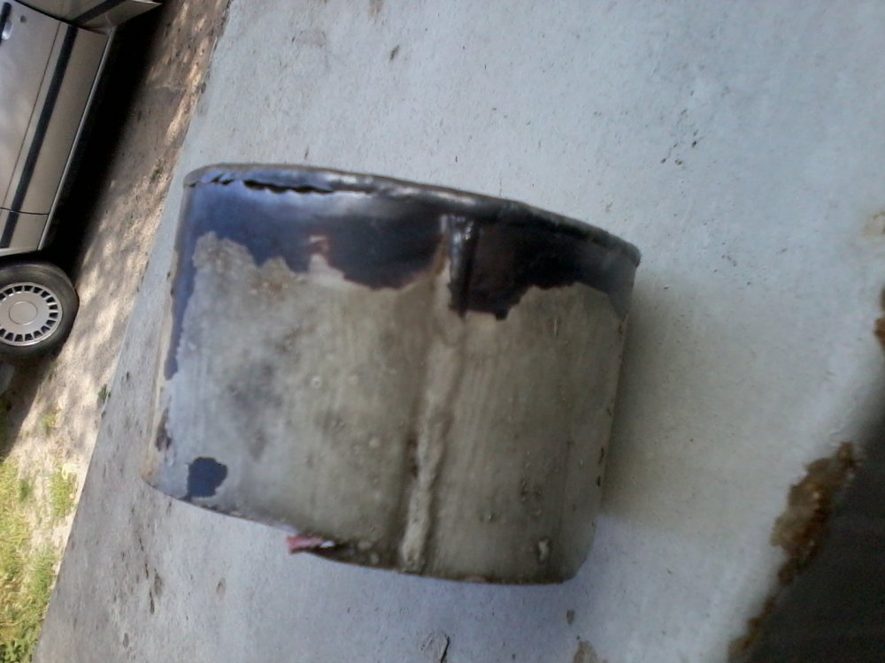

I work with boats, I have a client who has a 1987 mild steel diesel tank which has just started to leak, so I pulled out the tank and standard problem is that the water is never drained from the drain valve at the bottom and systematically rots out the bottom of the tank, however this is not the case, exceptionally this diesel tank has been reguarly drained and it seems to me its the mig welds right at the bottom of the water trap which has rotted out. An inspection shows very little detoriation to the actual steel, was it badly done? An old mechanic once told me its always the welds which rot out first, myth or truth?

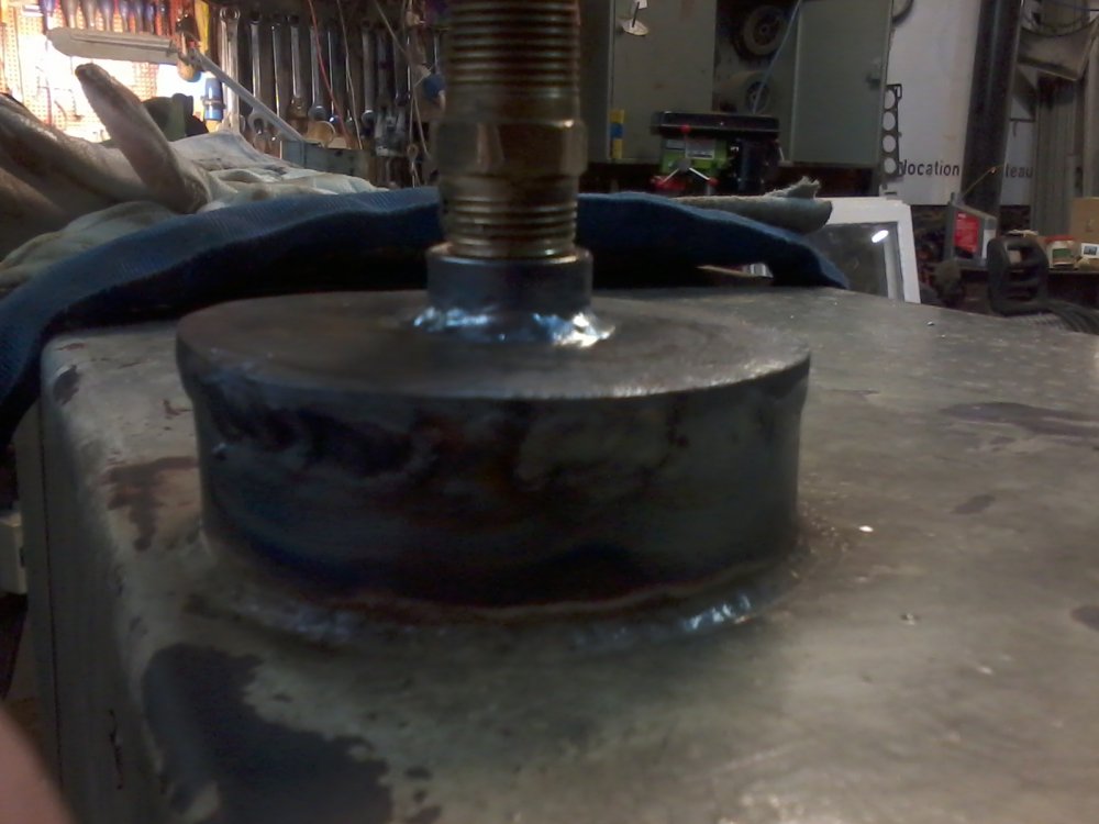

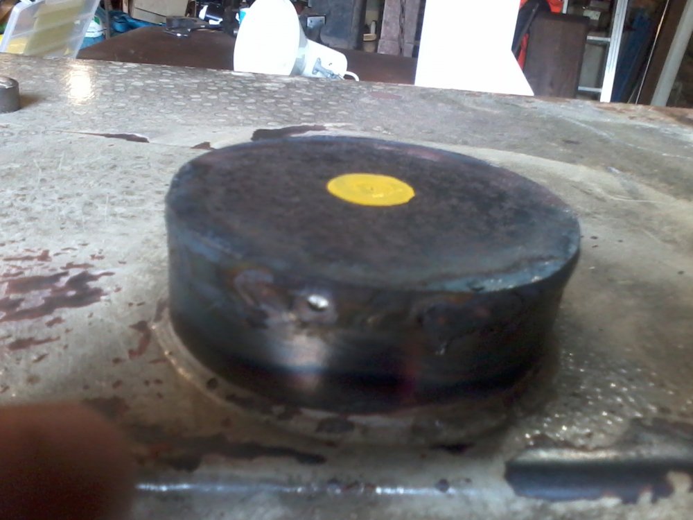

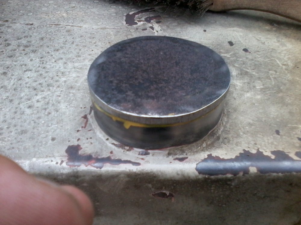

So im going to make a new water trap with drain, and weld it on, but mig or tig? I have both, I suspect the proper way to do it would be to tig and go over with the mig?
Heres some photos.....
