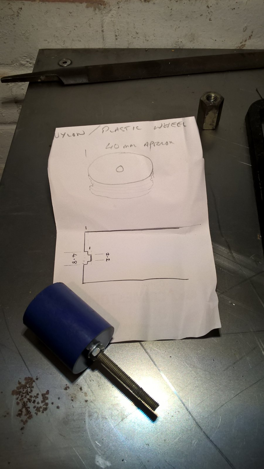

So I thought I would try it.

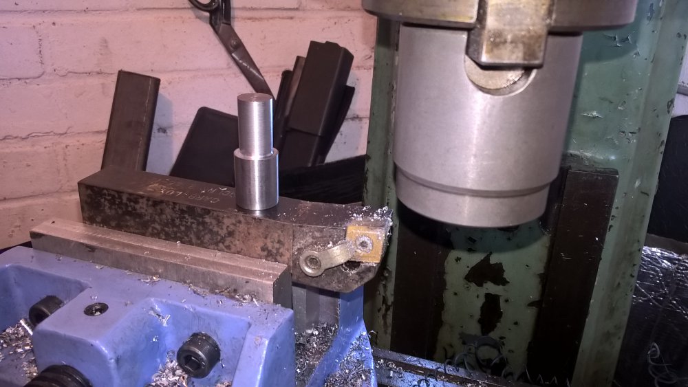

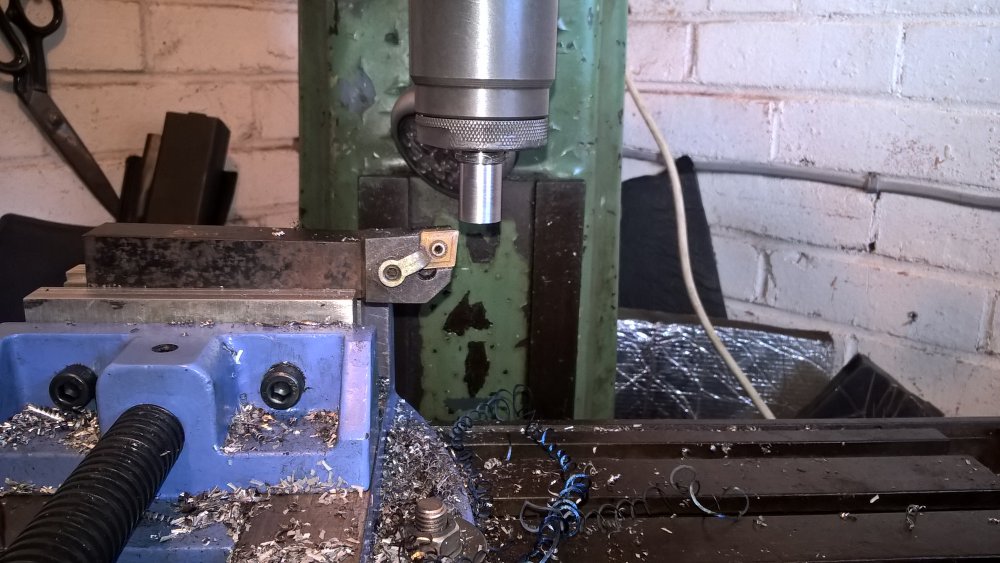

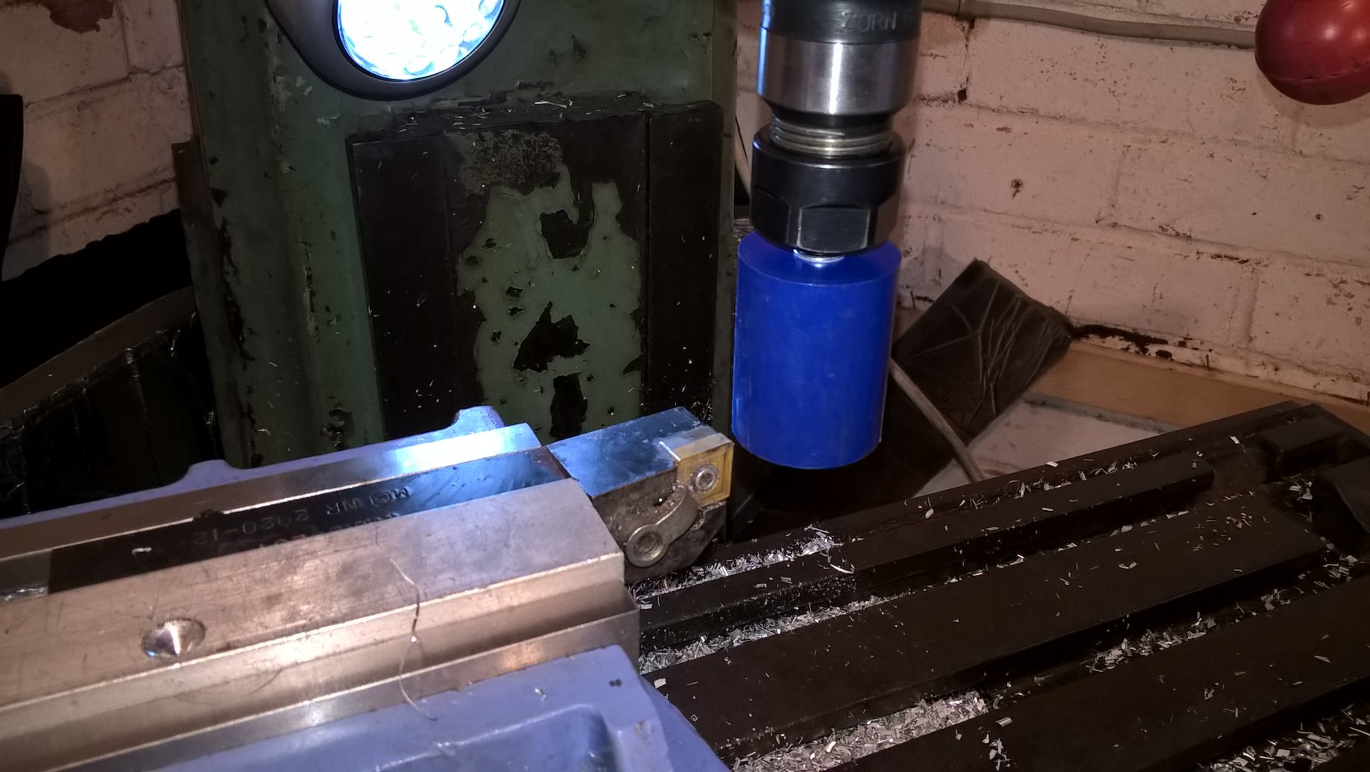

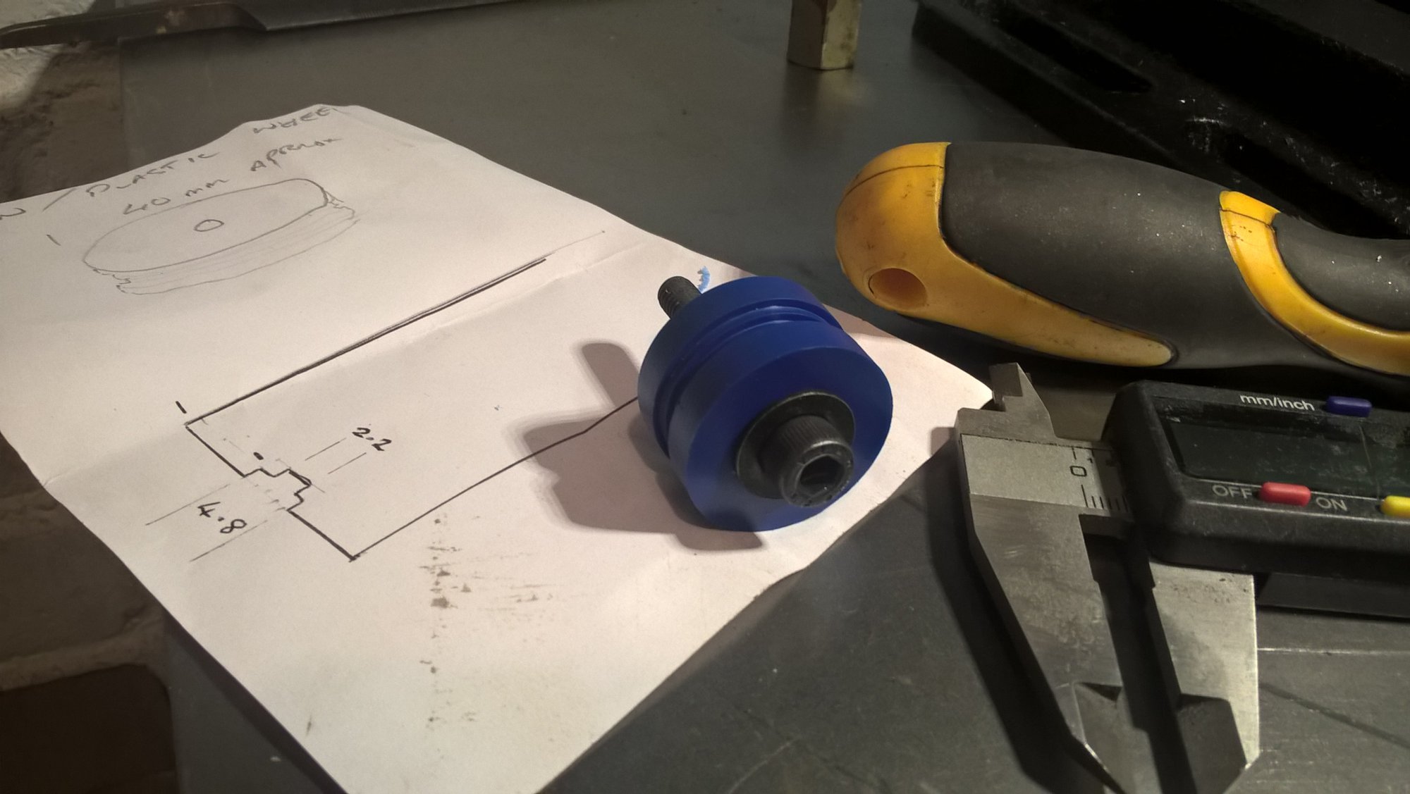

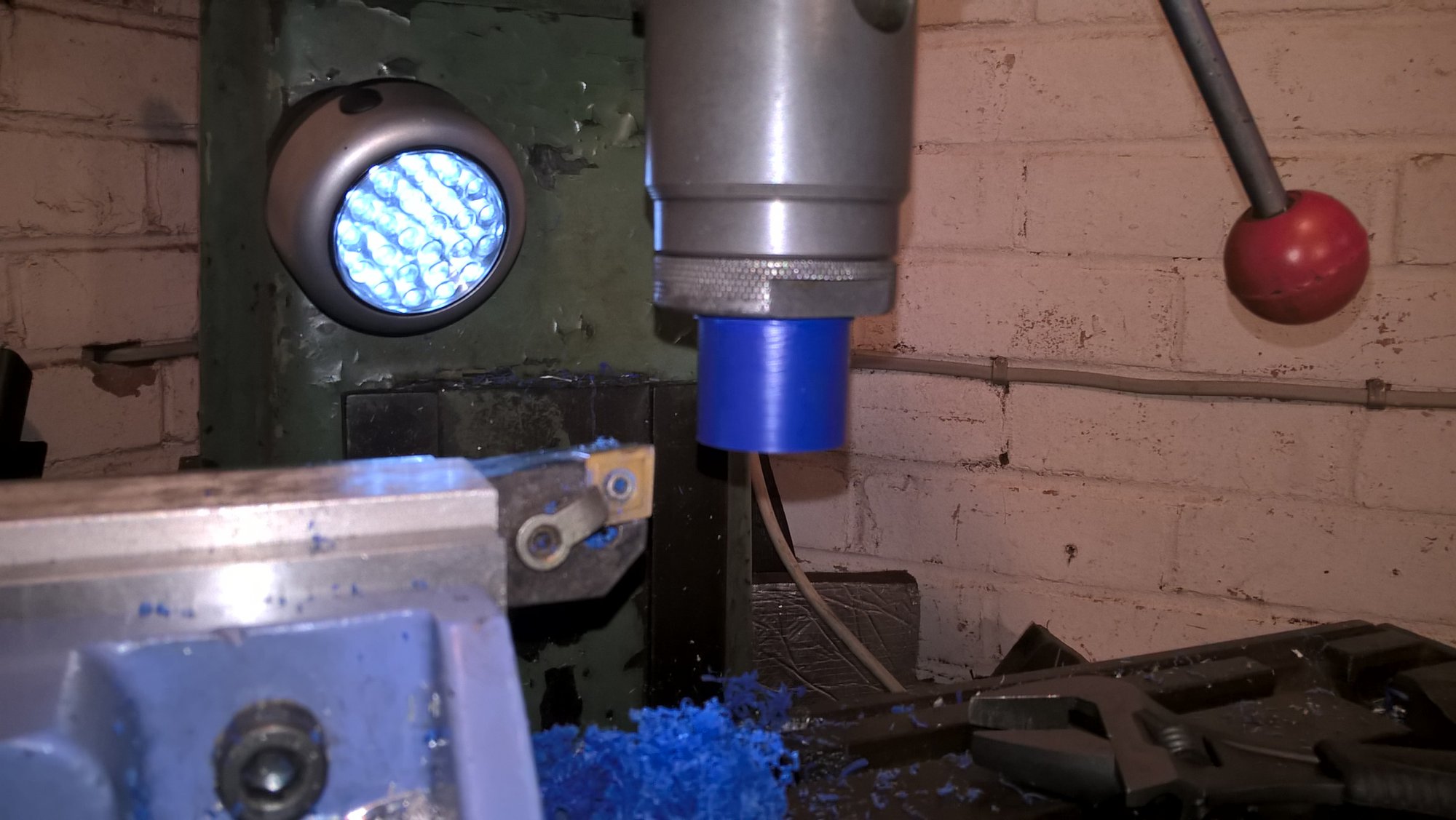

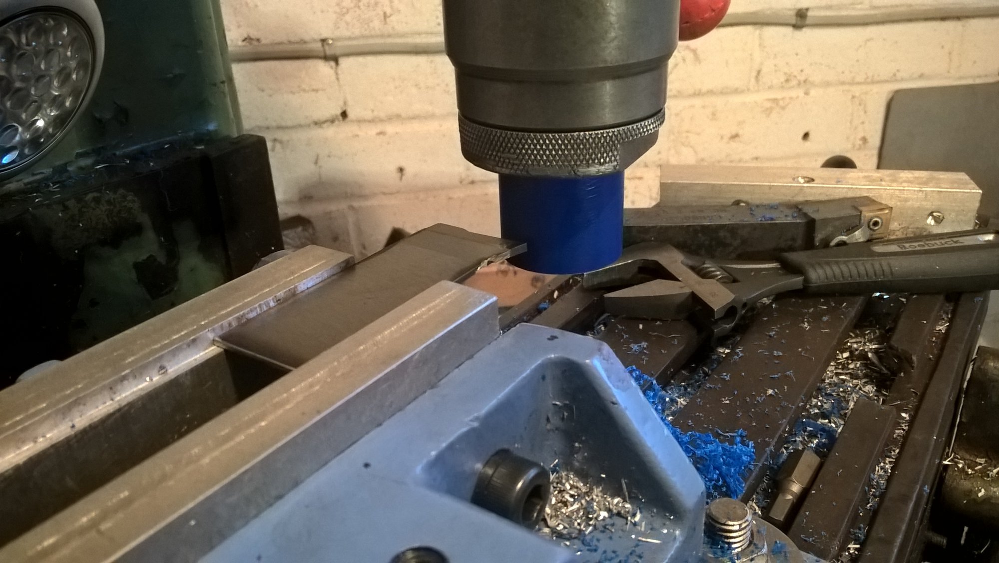

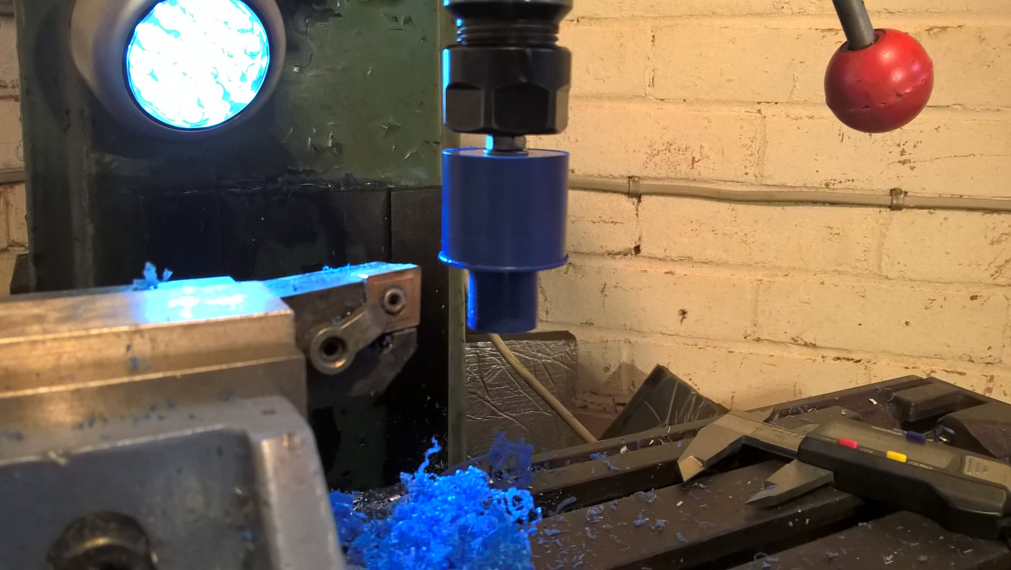

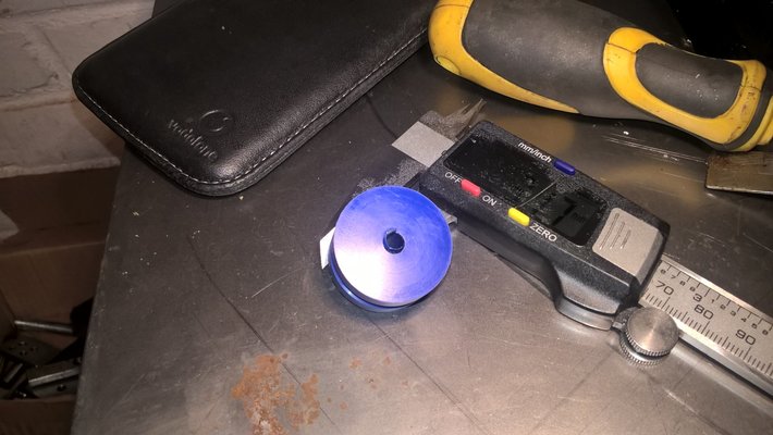

I thought to turn out another adaptor for converting a BT holder to ISO. This time using a lathe tool in a vice, with the job held in a Clarkson chuck.
Result! well happy with the finish.
