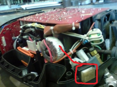

I had the covers off my 180 minarc and the switch looked straight forward to change. I'm sure it will be similar.
It was held together with torx screws. some were under the door hinge so that had to come off.
From what i remember i think all the screws were on the one side..could be wrong though.
I rested it on the wire feed/door side and lifted off the other half.
