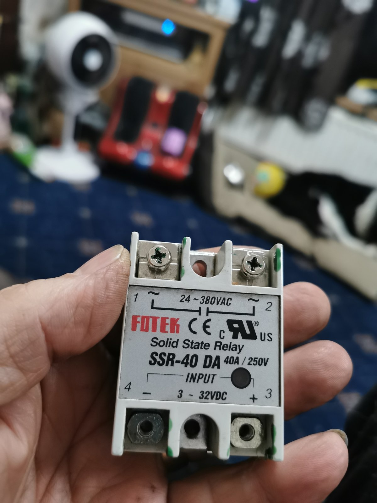

    I have a heat press my son was given to see if it could be fixed cheap enough.
    That was mechanically....... It was a bit if a mess as I don't think the cheap Chinese bolts etc could hold up to the not quite perfect design and the forces that was causing.
    Anyway if I can get it working it would be fine for a backup as it's one of the best built cheap Chinese presses I have seen.
    But it's not metering as I would expect it.
    I seem to be getting OC when I test the 24 to 380 side.
    And I get very little from the 3 to 32 side, other than a flicker on the meter that seems to indicate that side is not OC but certainly not complete continuity.
    That said I don't know how these new fangled relays are supposed to meter out. Lol

    I'm confused - that's what I'd expect, given that the internals are likely to be a mosfet / triac switch.
    Have you tried just applying +12V to the input and see whether the output goes closed-circuit?

    Stick your 3 to 32 volts in and the other two terminals should close. You may find that you won't detect it with just a multimeter. Better to have a power source in series with a lamp.

    You'll need to test it in circuit and under load.

    Well in that case I have tested it...and it don't work. Lol
    But I guess I had better go and check I have something on the 32 volt side or it won't work.

    It needs a dc signal on the input side and an ac voltage on the output side as said above.
    You won’t get a meaningful reading on a meter if measuring resistance alone on the output side, unlike a “normal” mechanical relay.

    For a load you can stick an incandescent lightbulb in series, doesn’t need to be anything fancy.
    I’ve tested 500a thyristor stacks with a lightbulb, all you need is something to pull a bit of current.
