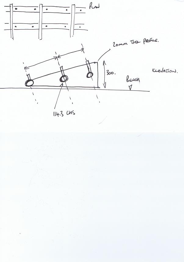

Got some 30mm dia round bars to weld onto 114.3 OD CHS tubes very precisely (Glass to go on them!). It will be laid on the bench, which will need to be used as a reference surface.
Two alignment problems - firstly getting the 30 dia bar centred on the 114 CHS, and second, getting the bar at the correct angle. Been scratching the head on how to come up with a manageable jig to do it.
Anyone any thoughts?

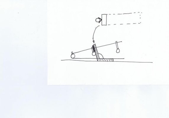

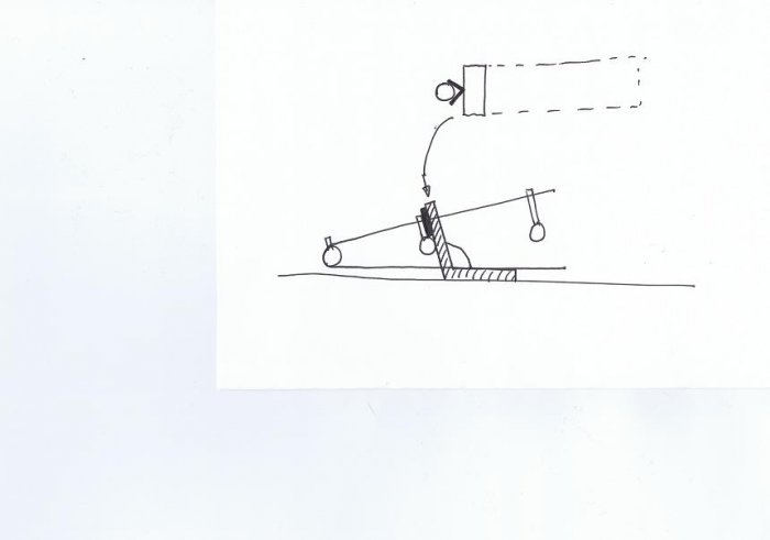

Sets it off half the width of the CHS with a bit of packing out
