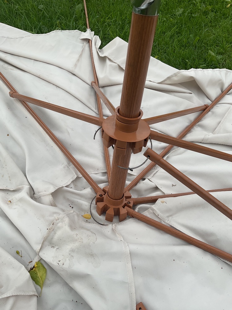

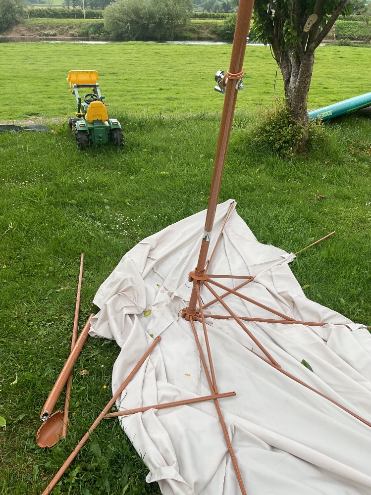

This got wrenched in a freak gust ,it was a wedding present,not sure the replacement cost,it looks a tricky assembly to try and get the two circular wires relocated,has anyone successfully repaired one?
Everything is repairable...I'd certainly be looking into replacement costs before attempting to repair that though stuff like that has a habit of becoming a nightmare quite quickly

fiddly but doable, the original wire is simply twisted and will break if you try and re twist it. get some new wire, lay it out without the fabric (Unscrew the bit on the top) lay in the struts in order as you pass the wire through. If you have a small ratchet strap it helps to squeeze the struts in place in the hub then re do the wire.
Looking at that, big ziptie repair moment? i.e. feed the biggest one I had through the holes folding it slightly to make it fit, then zip it up to replace the ring. That's probably how I'd do it...
Had no idea they were so cheap,ffs,more landfill,too many expensive things to sort currently to care for this,it got wrenched so violently,it bent the hole in the table,that’s 2mm thick.

I 'repaired' mine when the block the wire runs through broke, i used a tig rod. ran it around through the holes twice and twisted the ends until it was snug enough to work.
