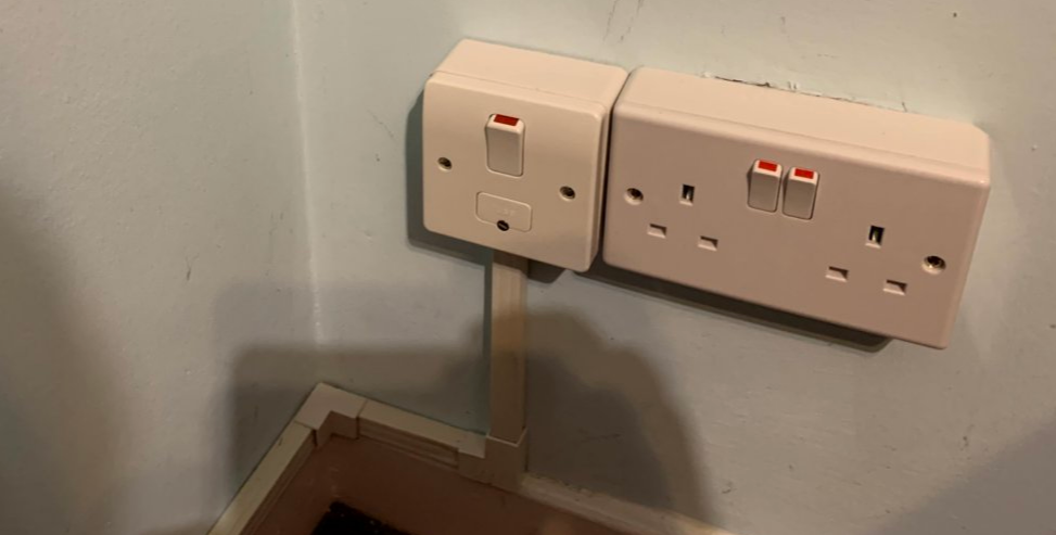

    I was replacing a single socket tonight with a double and thought I was playing it safe with an MK Logic Plus dual gang socket.
    I belatedly came across this IETF thread about this very same topic.
    The weird screw angle, torque-wrench requirement on initial drive, cable disappearing up the side of the screw, and the screw being made of cheese.
    As per title, I thought MK were supposed to be the chosen make for this kind of thing but it seems I'm wrong.
    Double socket in the bin and another trip to screwfix in the morning.
    Any recommendations for basic 2 gang sockets?

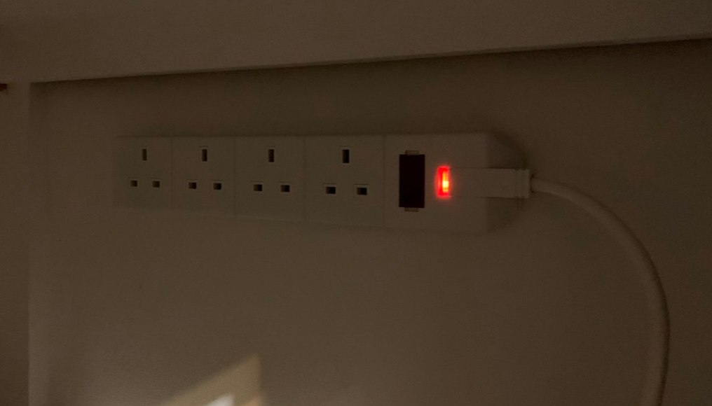

    What I was doing was replacing a single socket with a double socket, and an FCU supplying a 4 gang on 7m of 1.5mm trunked flex:

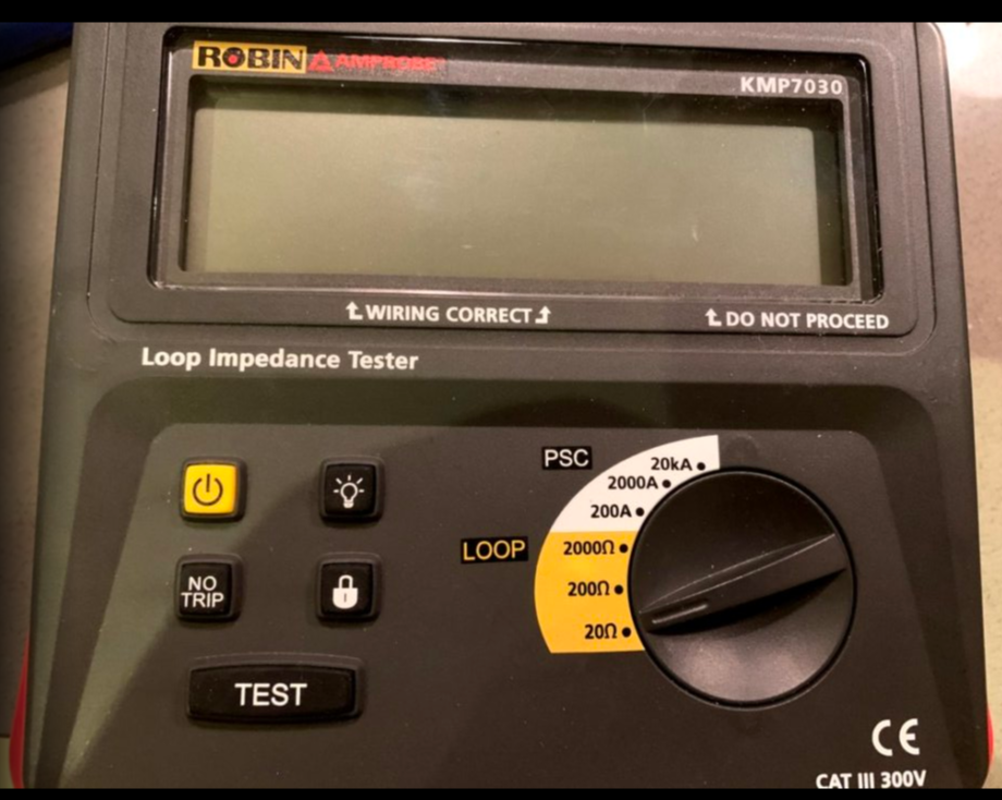

    I then tested the sockets with my trusty Robin:
    0.58 ohm on the new socket, bang on what the old socket was showing.
    I then tried it on the extension and the first time it came out at 0.78 ohm - to be expected, I guess, given it's a spur on flex, and well within spec.
    But I then tried it again and, even though the "No Trip" button was on it tripped the RCD. Flipped it back on again, re-tested, and it did the same again although I noticed the Robin flash "NOISE" just before the RCD tripped.
    Is this to be expected and/or anything to worry about?

    have you tested your tester on a separate circuit preferably on the other rcd
    could be an earth leakage somewhere else, then when tested its sending enough current past the rcd that its tripping.
    pretty simple to prove either clamp the main earth
    or turn on one circuit at a time on the board
    skotl likes this.

    Yeah - I use it in the garage whenever I fiddle with the sockets, and that's on its own RCD
    And, of course, it's ok when plugged into the socket at the other end of the spur :dontknow:

    another option is the rcd
    as ive got an MFT id just test the rcd as well check earth leakage with a clamp, might be easier for you just to swap the rcds then test again.
    rcds do go faulty i have a batch of rcbo's that wouldn't trip even 5X rated

    Probably as above a little leakage already on the RCD, happens with lots of SMPS. It's one reason I like RCBO'S.
    Hopefully, if and when they get to the 19th edition, the suites that don't work in the real world, will of hears of Time Delay rcds, for downstream along with 10ma, and 100ma or 300ma, for main supplies. You would think the only thing you could buy is a 30ma.
    It's too common now for 2 or 3 to be in a chain and its pot luck what one will pop, as there is no allowance for discrimination.
