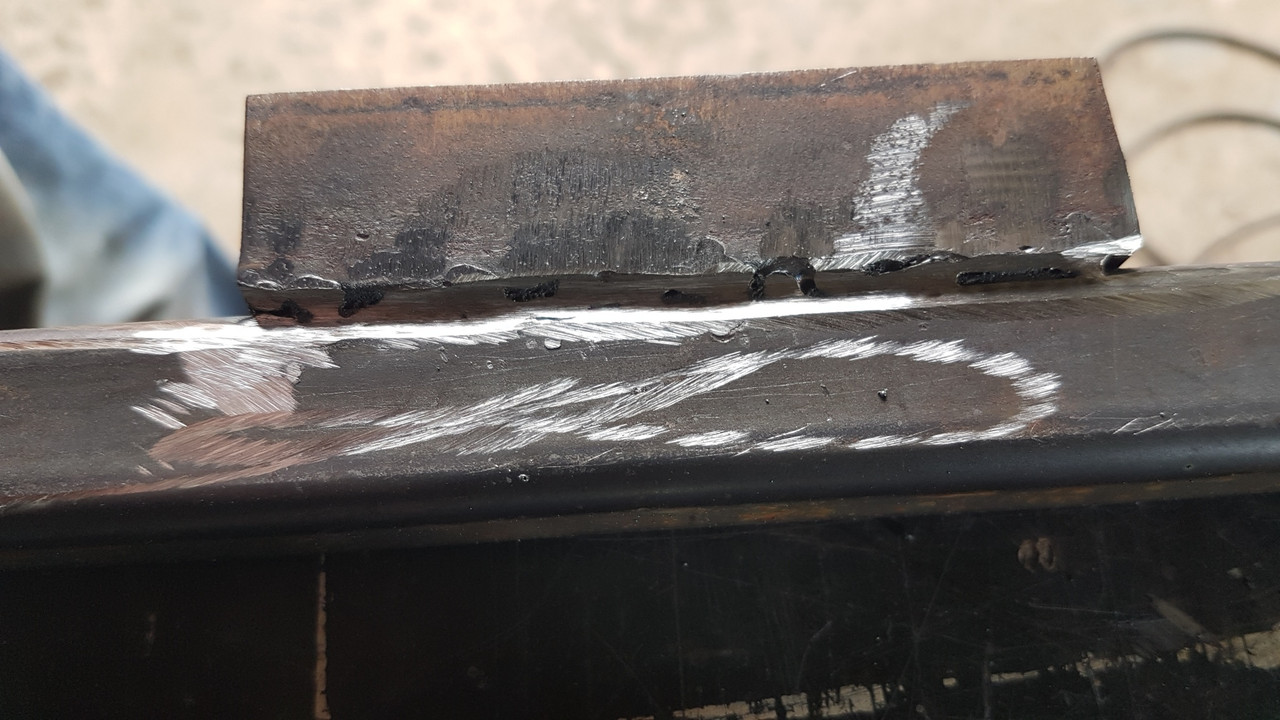

    Hey All,

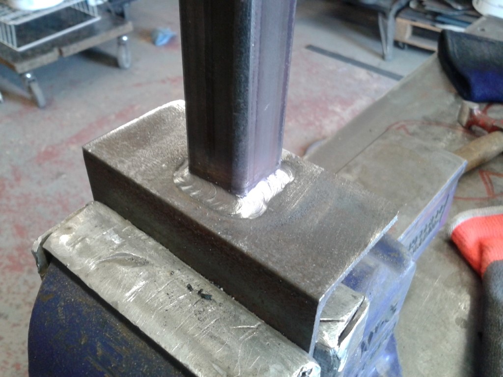

    Looking for advice on how to avoid slag inclusion on deep pocket welds. I am trying to weld angle to box section where the round corner on the box section is creating a deep pocket to fill as shown in Pic 1. Pic 2 shows the results after a bit of cleaning up.
    I dont see a way to keep the slag out of the weld as it has nowhere to go but I guess I am doing it wrong. Im welding it on the flat using 6013 at approx 60amp. I point the rod up into the joint and pull it back. Would I be better off doing it standing up (vertical) and work for top to bottom?
    Any advice welcome as most youtube video are 1/2 plate overlapped or T jointed in perfect position which doesn't help in the real world.

    Looks like your moving to fast and not laying enough metal.

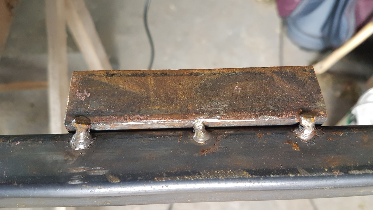

    Making hard work of it with those big tacks @fizzle , I would do that in two passes. Lay the first run with a high amps and a tight arc which wont produce a peeler but will fill the radius, chip off and go again as normal.

    You don't say what size electrode but 60 amps is too low even for a 2.5, I would be running at around 90 to 100 amps in a fillet, keep the arc tight, you can even touch weld with a 6013 and let the electrode burn away at its own rate.

    Thats a nice weld Paul. If I tried that at 100 amp would surely blow hole in tube.

    Not if you keep the arc tight, the wider the arc the hotter and less concentrated it will be, varying the arc length is how we control the heat input while welding.

    As said above, you're travelling too fast and not laying it down properly. I imagine you're making a similar mistake to me with 6013 - all you can see is arc and slag, no puddle to speak of, so you're more relying on proper amperage and technique from muscle memory.
    Try travelling slower, keep a tight arc but not jamming it in there, and just watch for the tie-ins to the sides. definitely a few more amps will help too, at least 75 amps for a 2.5, at least 90 for a 3.2 rod...

    Thanks all. It is a 2.5 rod. Will give it a go with higher amperage and try form a puddle before I pull back. The rod does tend to stick so thats probably part of it.

    OP, I'm not sure what you're trying to achieve here. You seem to have a good sport for a bevel and then a good root and fill, but then you grind almost all of the weld off...
