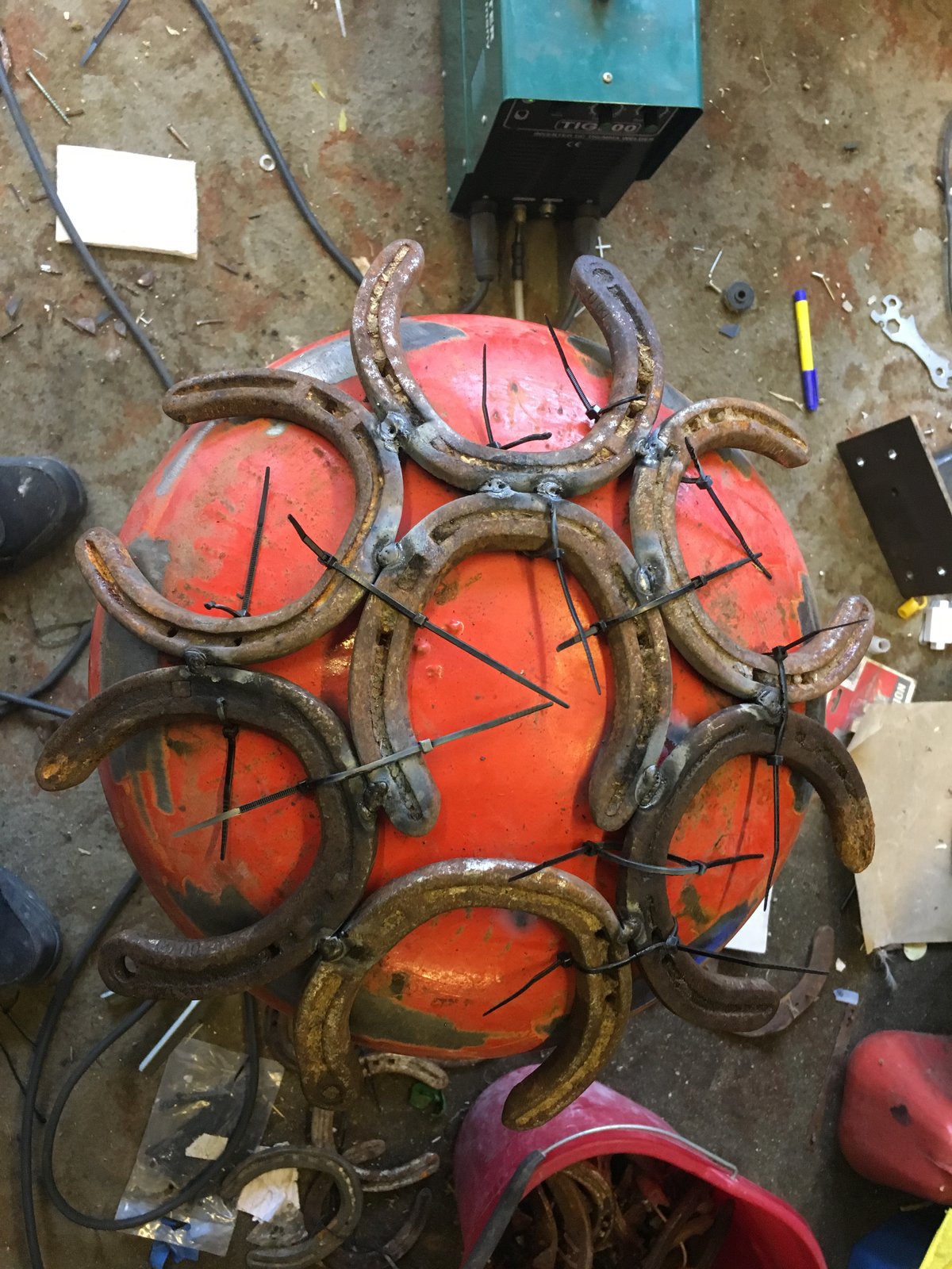

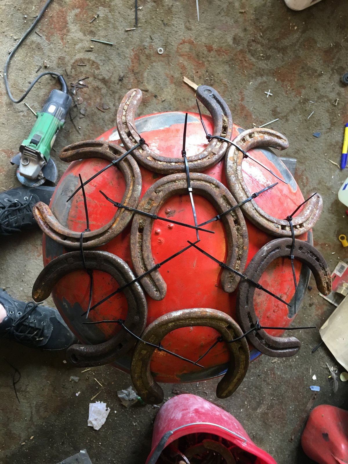

    A while back I was given a bucket of old horseshoes by another forum member and all that scrap wood I got hold of last week gave me an idea.
    Shoes loosely arranged over the bottom of an old gas cylinder (which will become the ash pan) and held together with cable ties to check fit.

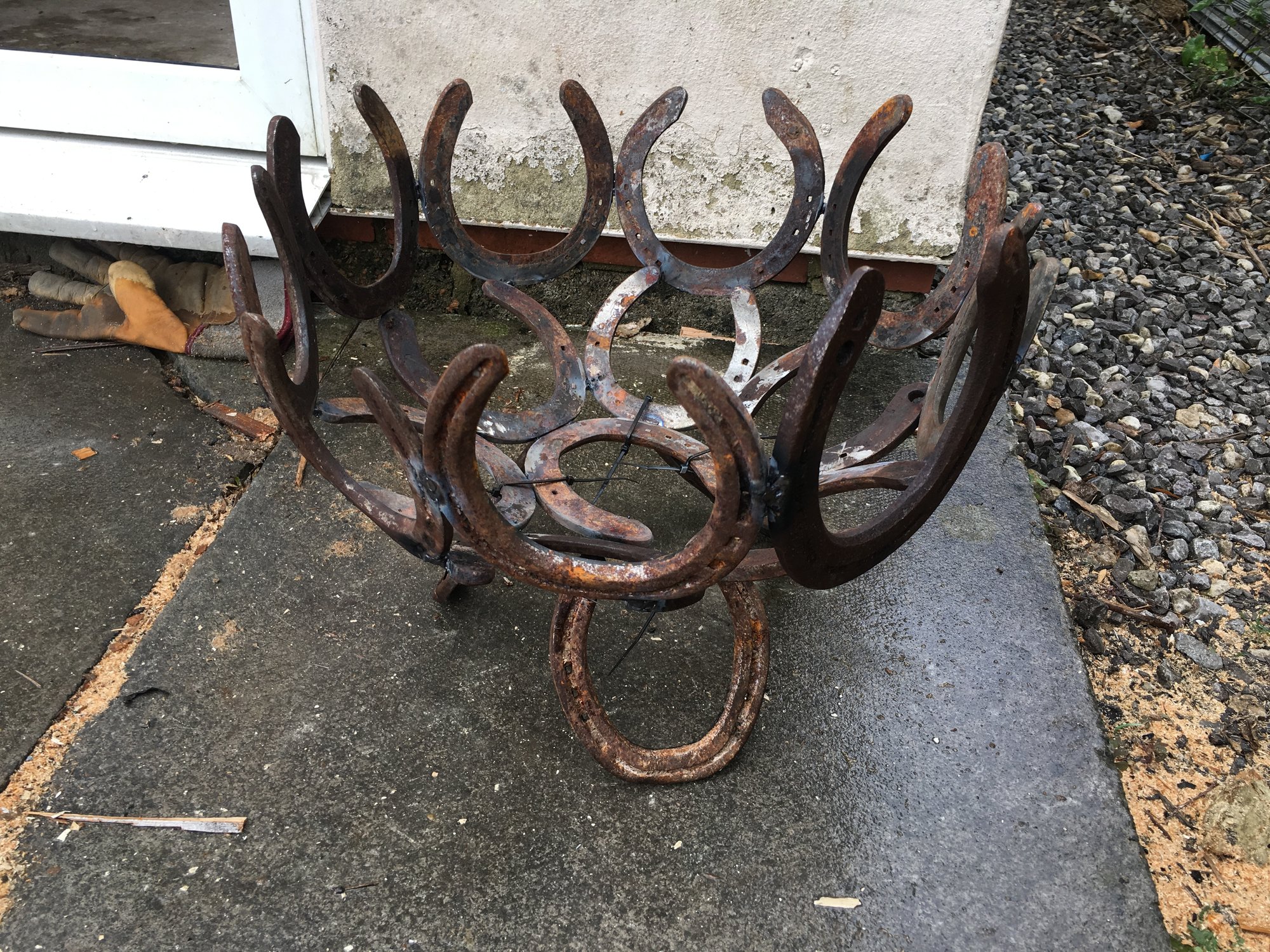

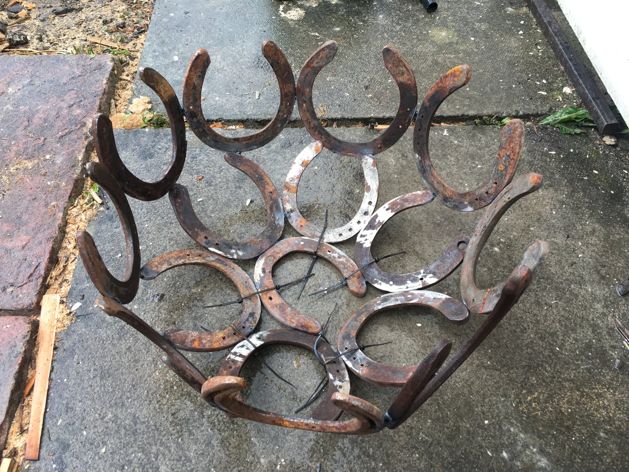

    Tacked in place

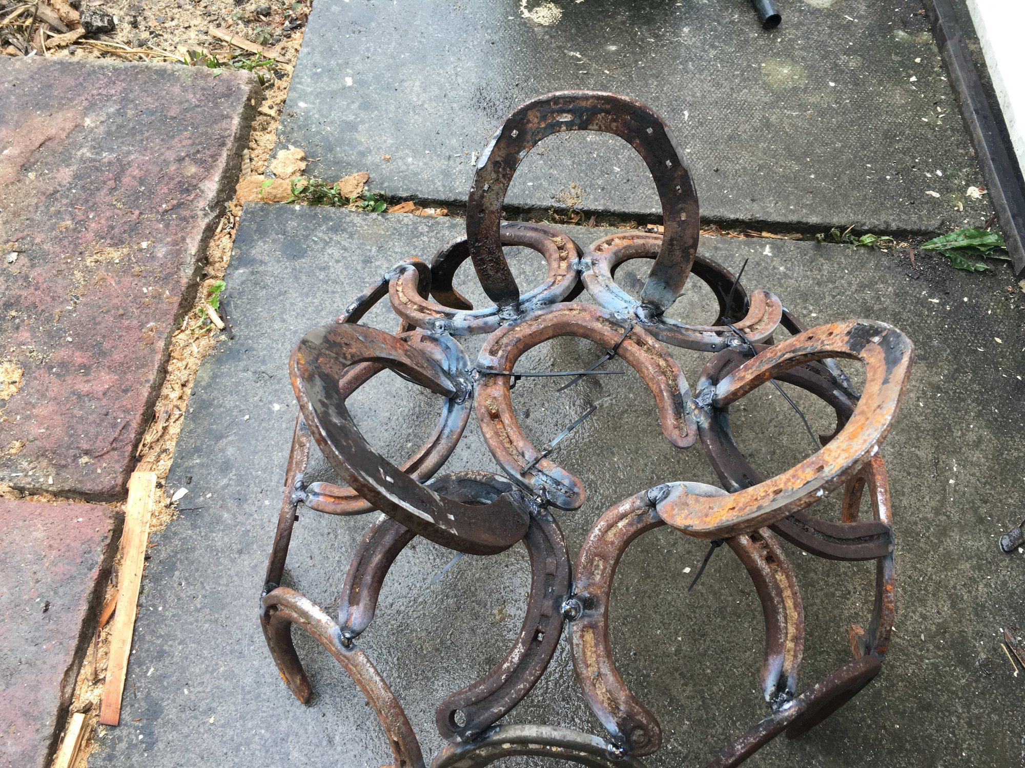

    Side built up
    Feet tacked on
    Ready to be fully welded up and fettled into shape

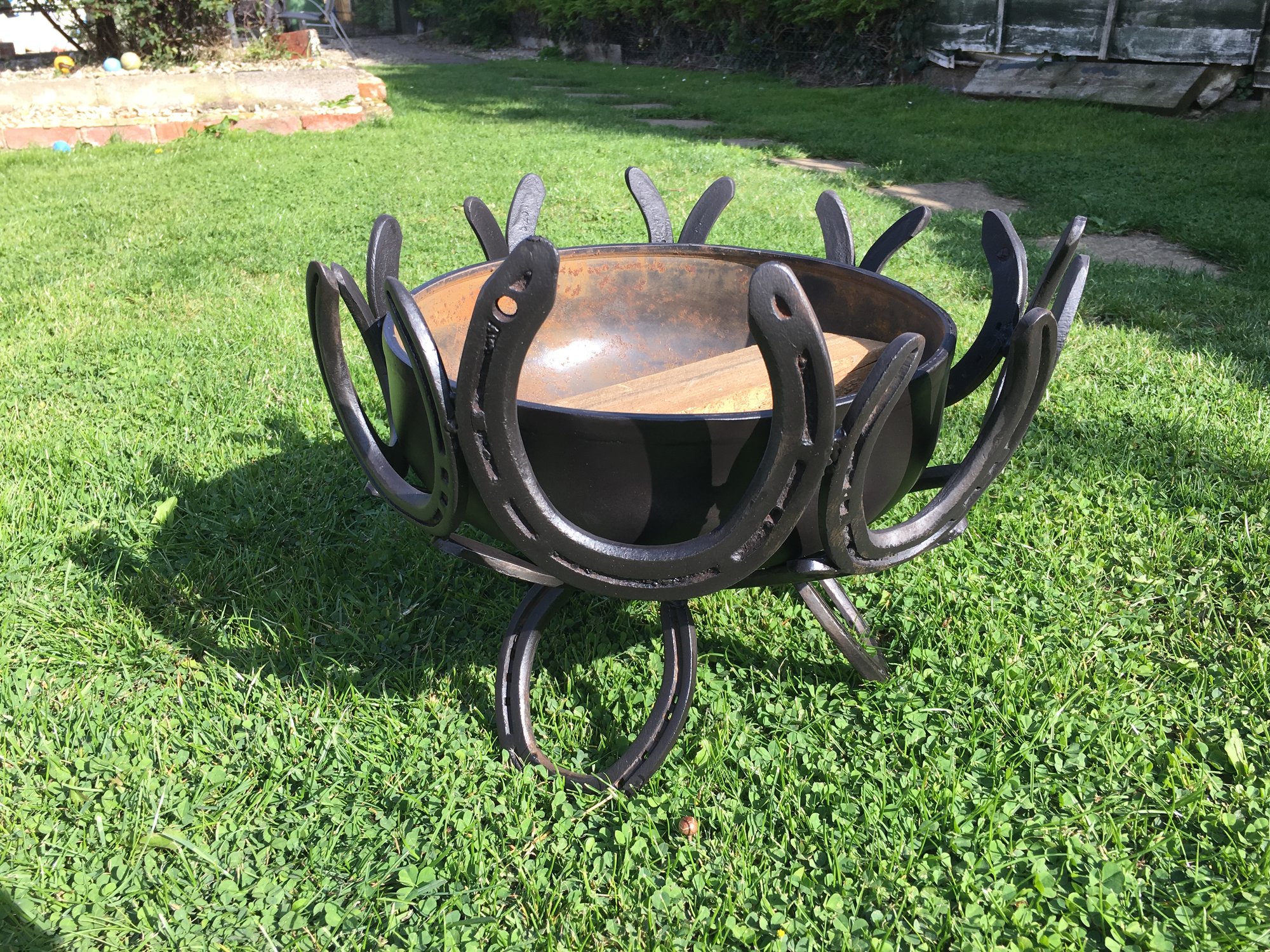

    Need to get some stove paint for it, cut the ash pan then it’ll be ready for it’s first burn.

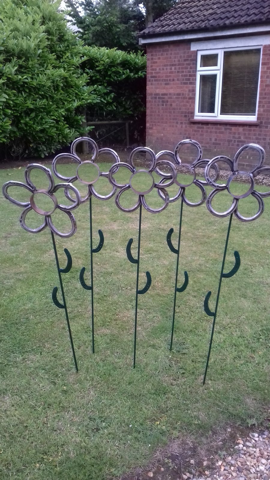

    I have tried all sorts to stop the rust, either hammerite or clarcoat is the only thing I have found obviosly neither any good for a fire bit, just let them rust, looks good I think. FLOWERS2.jpg
    Parm and Wozzaaah like this.

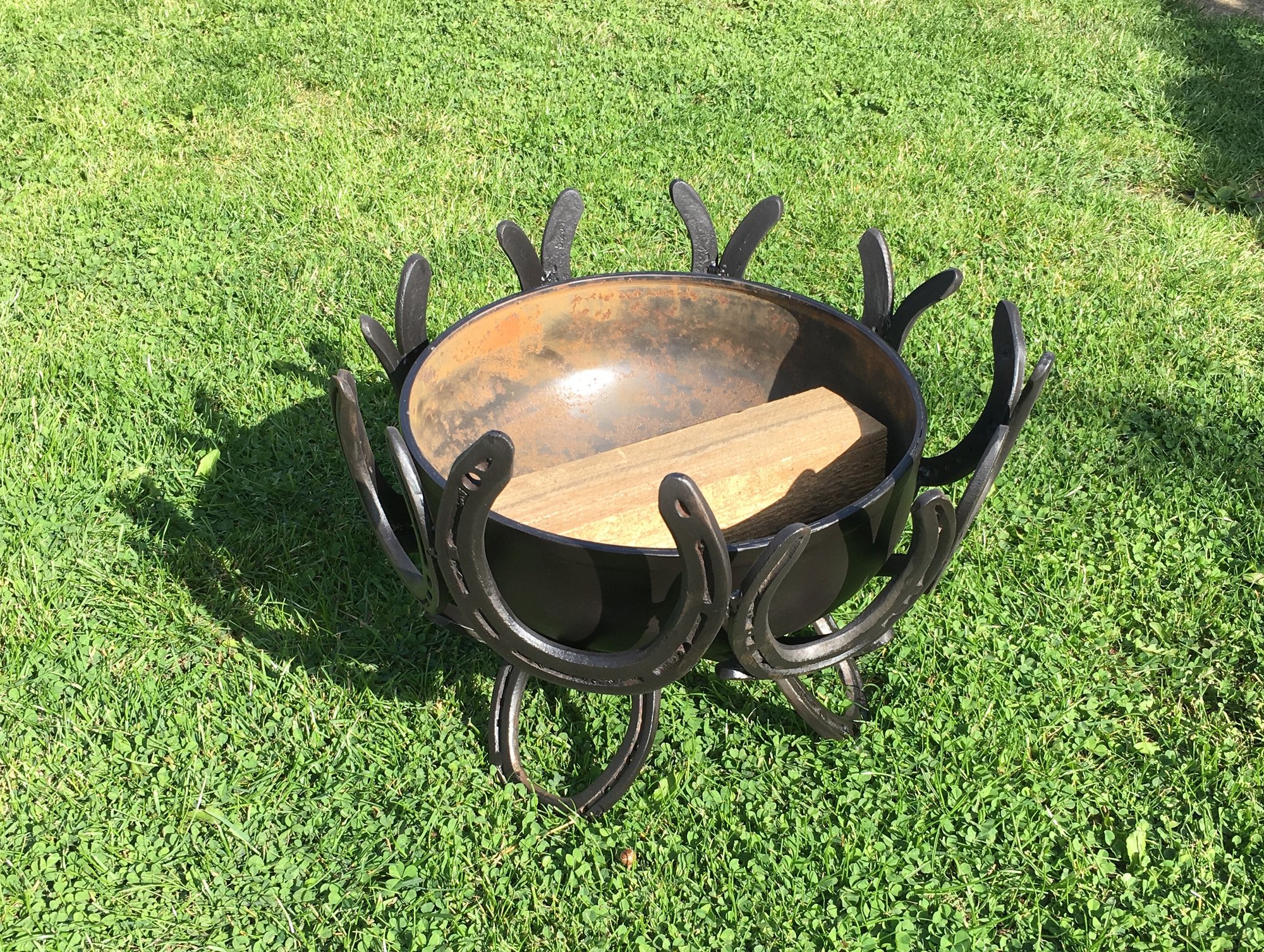

    Basket given a couple of coats of stove paint (sorry :laughing:)
    Fire bowl cut, cleaned up and painted. Ready to go! :D
    60FC3754-B5A6-4837-8942-DCC9511B9A72.jpeg 921C2F5C-6709-47AC-A790-2EB3D8FBF5BD.jpeg
    Parm, slim_boy_fat, RonMig and 3 others like this.
