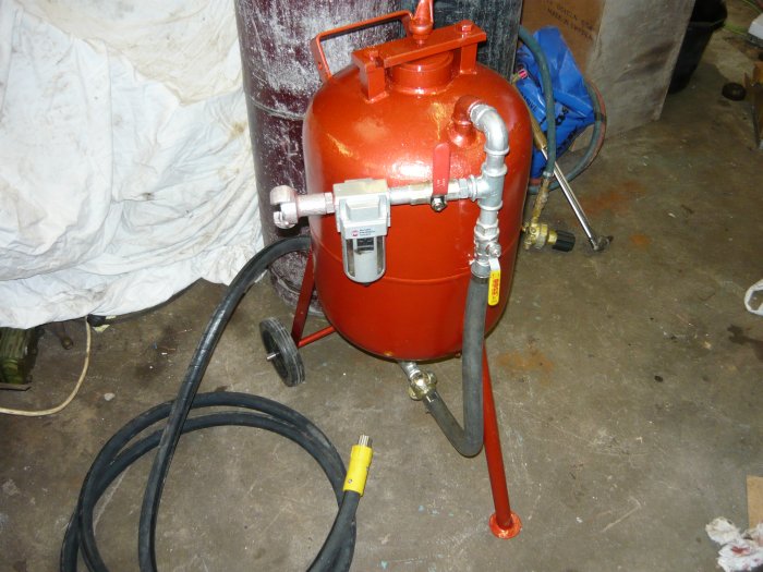

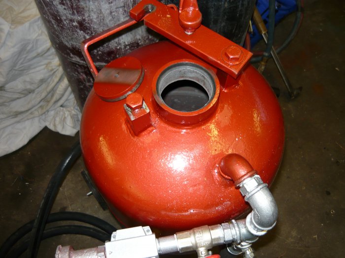

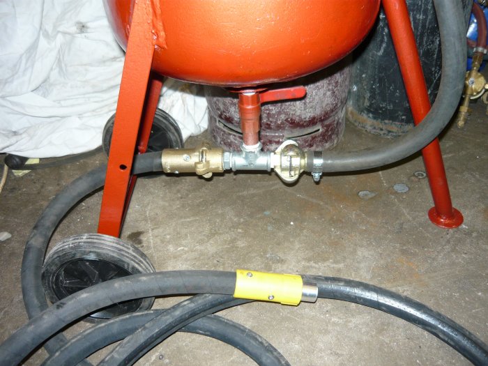

another gas bottle pot this ones simlar to most others that are either bought or made . the only improvements are the quick release filler neck which ive used on the last 3 that ive made and the quick release couplings on the underside of the pot . any blockages can soon be cleared/ it has 6mm carbide jet and runs on a 90cfm comp at 90psi . all the fittings and pipes are new total cost £130.00
