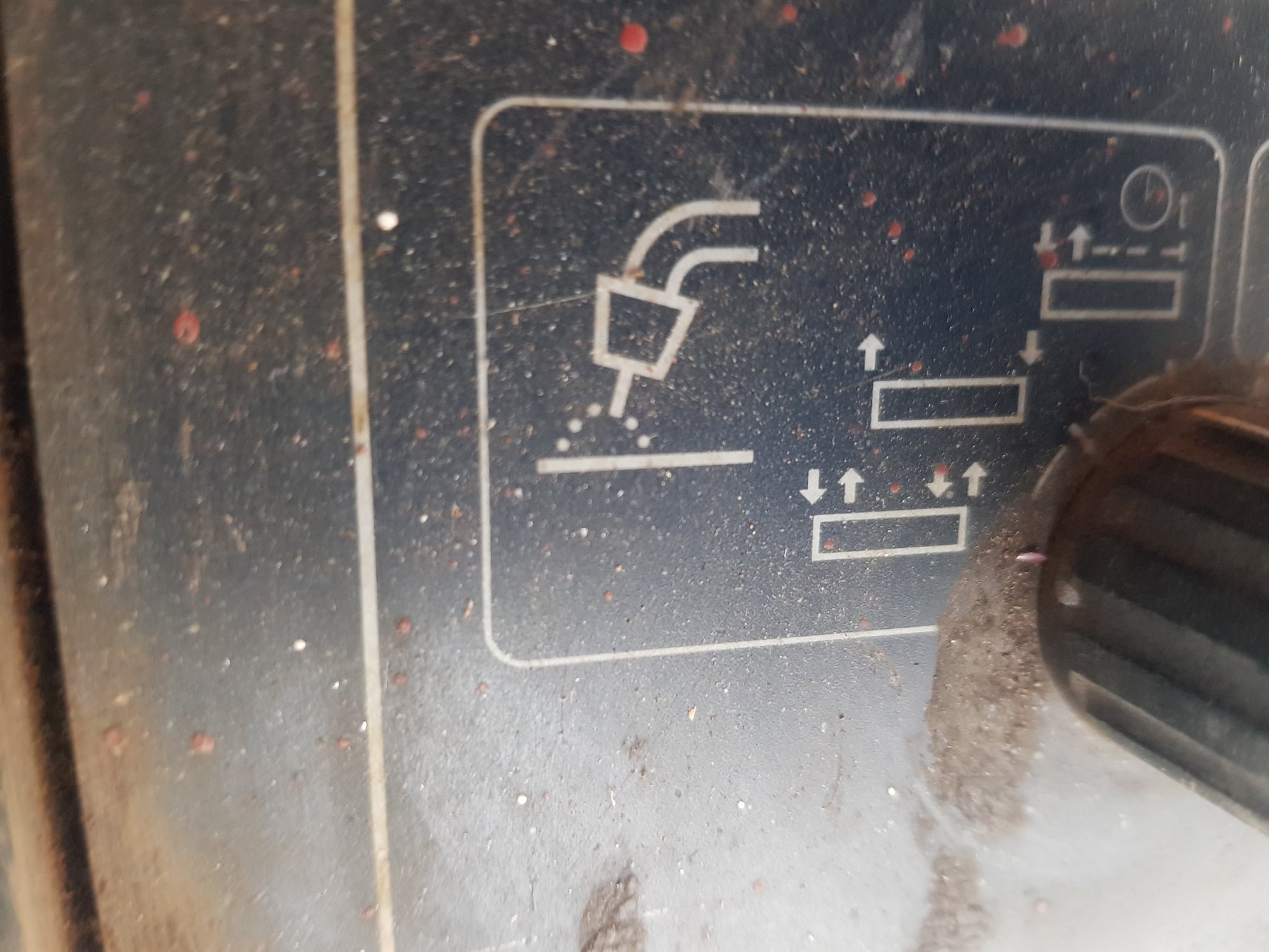

A Adam Marshall Member Messages 489 Location Nottinghamshire England Aug 14, 2020 #1 Can anyone explain what these symbols meen please? 20200814_174001.jpg 371 KB · Views: 46
R Ruffian Member Messages 3,510 Location Devon UK Aug 14, 2020 #2 2t 4t And spot weld timer. All actions that can be used on the trigger to instigate welding. 2t is on-off 4t is on low-on-on show-off Timer it on for time duration set.

Hitch Moderator Staff member Messages 13,276 Location England Aug 14, 2020 #4 4touch... press trigger and let go, welder keeps going. Press again, and let go, it stops. 2touch... weld starts when you press the trigger, and stops when you let go. Timer, pull trigger and it runs for a selected time.
