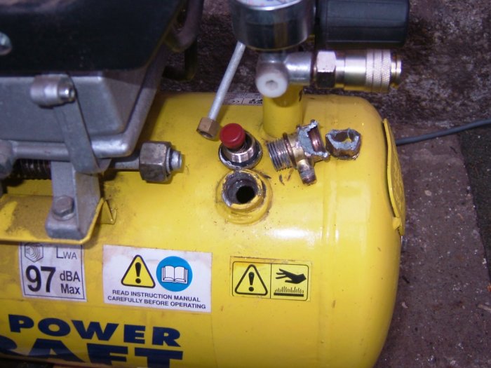

    Hi - I'm new on this forum and hope that someone may be able to help with a repair to a Wolf/Powercraft compressor (cheap Aldi 24l unit PC270/24).
    I've managed to wreck the main inlet coupling on top of the tank, where the compressed air enters the tank and where a T piece feeds pressure to the cut-off regulator unit. It's a flimsy casting, which broke apart when I attempted to 'nip down' a minor leak. It also seems to contain a simple spring valve that looks as if it prevents air from the receiver escaping via the compressor unit when it shuts off. Image attached of fragments.....
    Is it possible to source this assembly as a spare part, or does anyone have any suggestions on how I might cobble together something out of plumbing fittings to link the feed and the shutoff line to the tank?
    I suspect this is fatal, but I'm reluctant to dump the compressor as it's been very useful so far..... keith

    Welcome to the forum!
    Bog standard item, Machine Mart stock them. Just need to make sure you get the right thread sizes.
    This might help http://homepages.tesco.net/~A10bsa/bspgo.htm
    Just to clarify one point.
    The unit is a non-return valve as you guessed, the thin pipe doesn't feed pressure to the switch. It is connected to a valve inside the switch which exhausts the delivery pipe so when the motor restarts it isn't under load.
    This is where the characteristic hiss comes from when the compressor cuts out.

    Dont dump the compressor it can be fixed, it is fatal trying to "nip" up one of those ally castings they will always snap had the same prob myself, cobbled it together using plumbing fittings from B&Q I had probs with the 6mm pipe leading to the shutoff valve and a cracked casting on one of the outlets but fixed it with that thread loctite stuff, works a treat now.

    I bought one of those from a local compressor and parts supplier for a machine I built and it was made of brass, much more substantial than the monkey metal used on the cheap ones. It's a check or one way valve with an unloader

    Unfortunately Machine Mart were not really interested in helping when I phoned them(they say Powercraft is not a make they have any interest in and don't carry parts to suit(??)). I also see that Powercraft went into liquidation a while ago, so no direct support from them on parts. I'll just have to hunt around until I track down a suitable coupling. I think it would be quite difficult to fabricate anything to suit from brass plumbing or hydraulic couplings, as the spring valve inside would not seat. Just wish I'd been a bit more gentle in removing the fitting when the leak started which might have allowed repair by threadseal. Yes, Chinese monkey metal castings are a real pain, but I suppose that's the price of cheap equipment.

    Hi all - just a quick update on my long search to replace the knackerd non-return valve on the cheap old PowerCraft compressor -
    I eventually managed to track down the complete valve assembly and coupling at National Stock Solutions, who have taken over on Wolfs parts supply. Good service, quick response and reasonable price too (£7.98 incl 1st class post). Compressor now back in duty and running like new again. I'd almost given up on this and I'm glad I stuck with it
