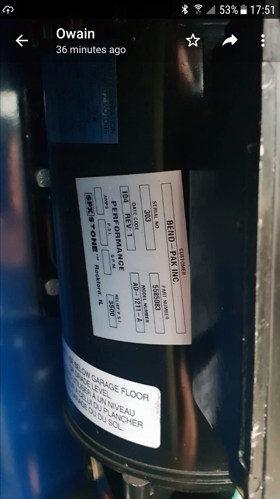

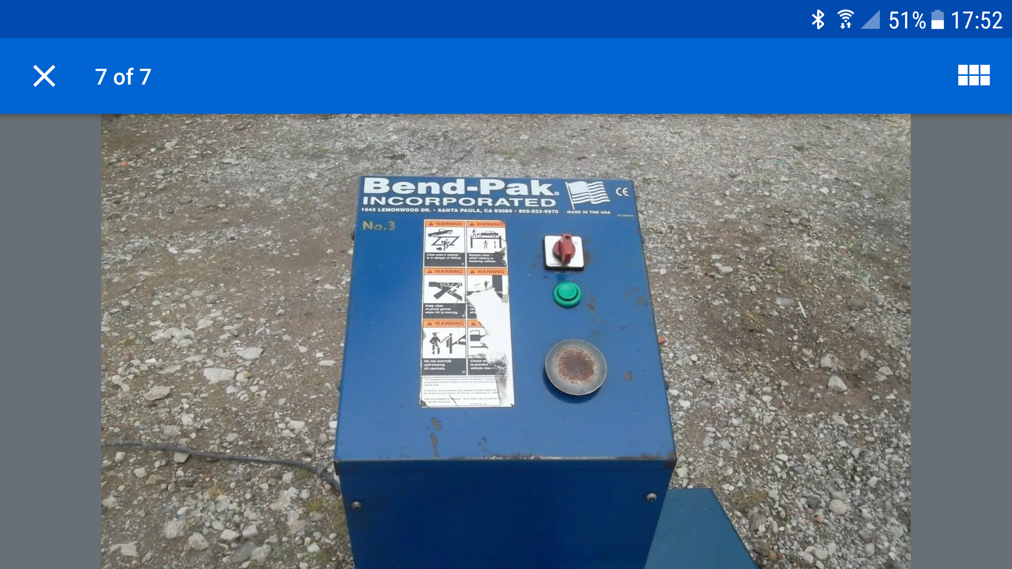

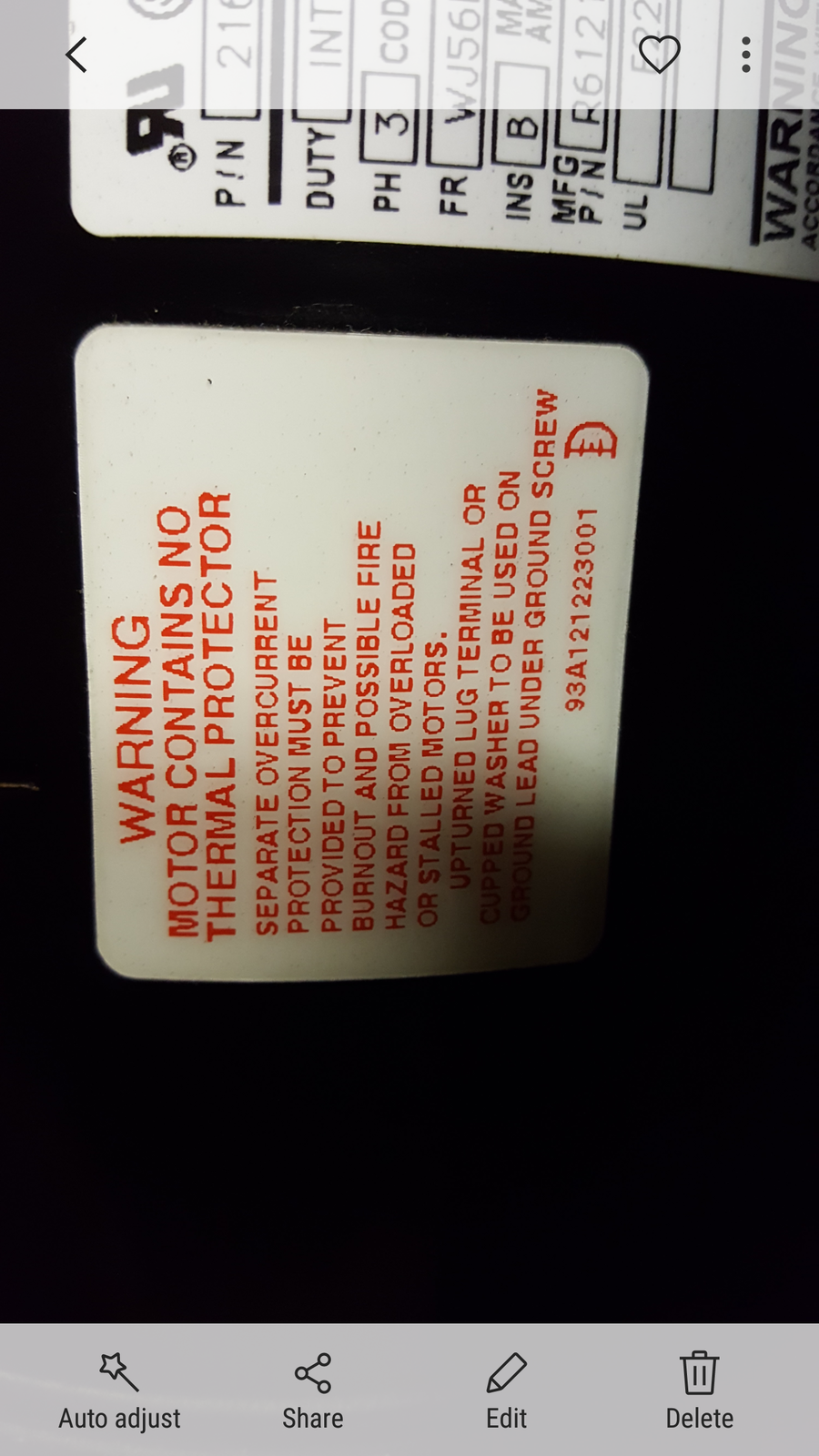

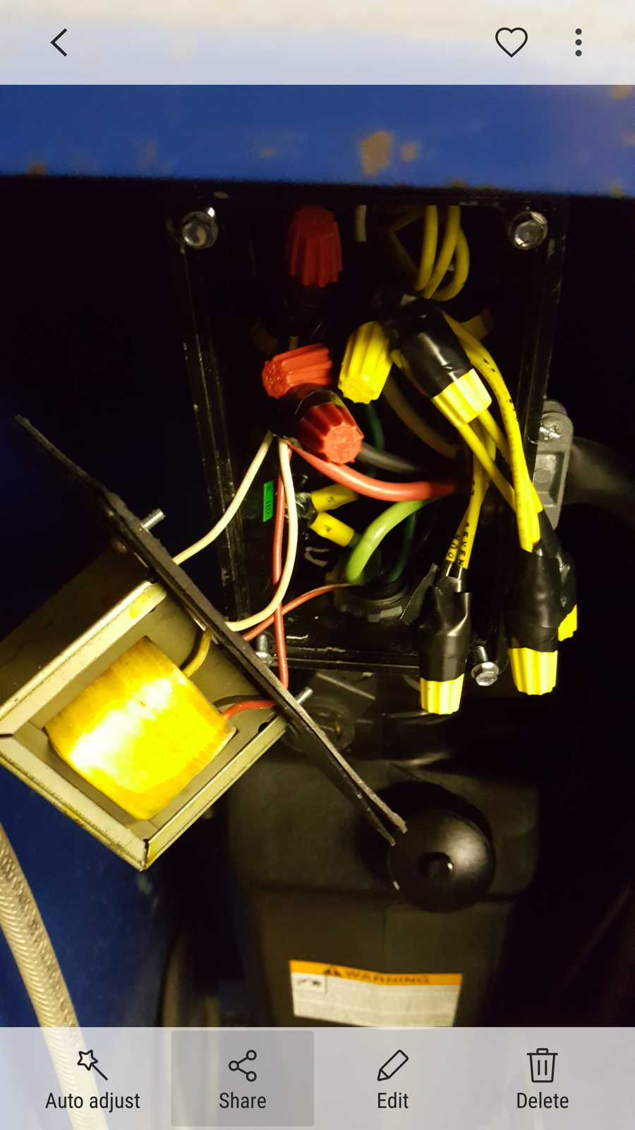

Can any help me with the wiring and controls of my scissor lift it is 3 phase and i need it to run single phase 240v

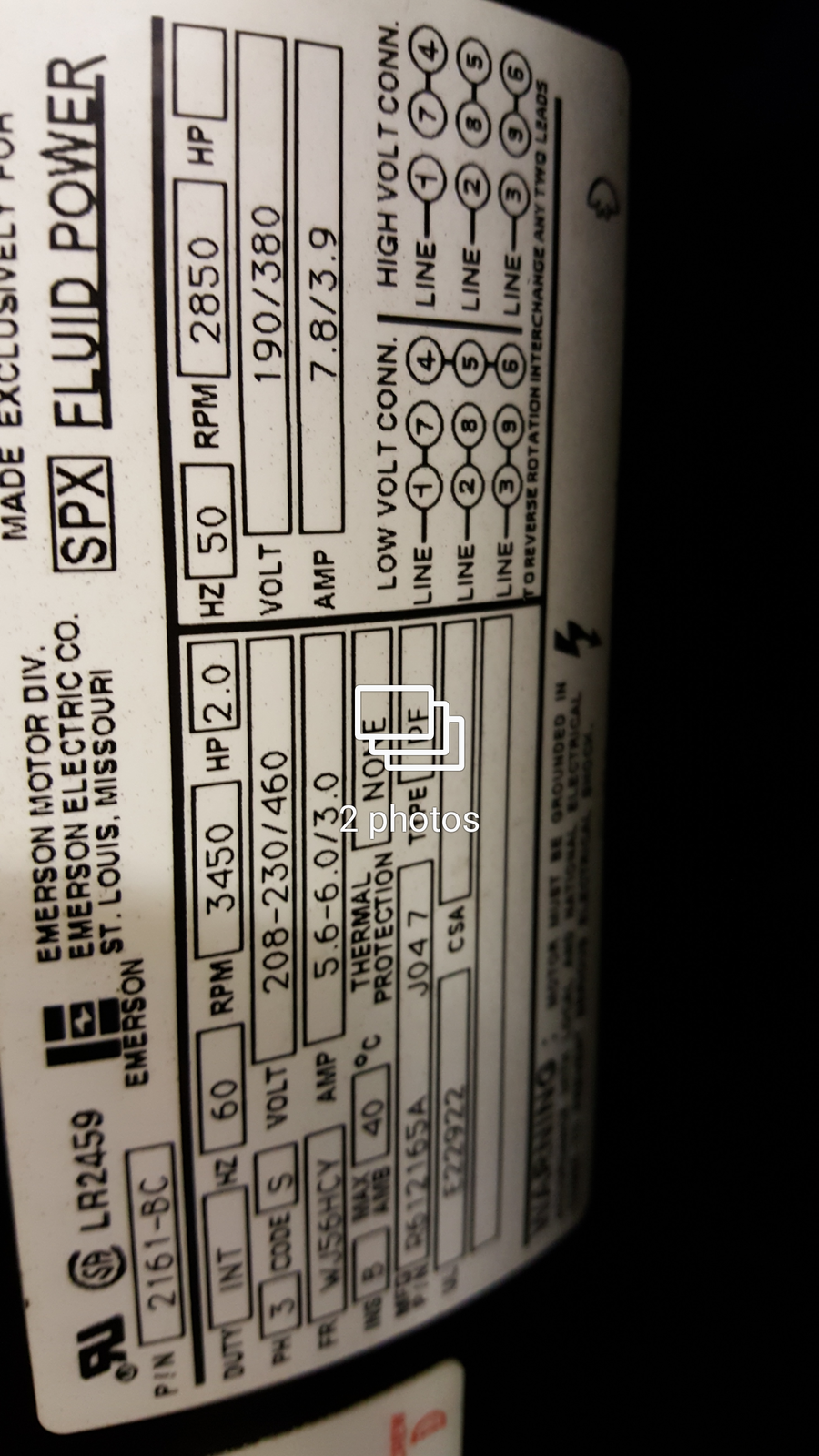

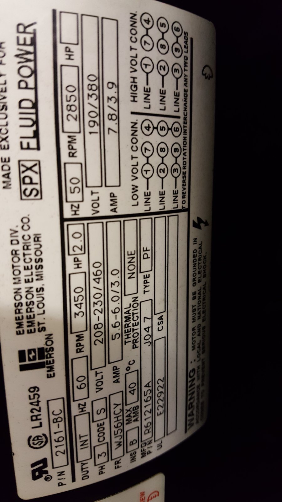

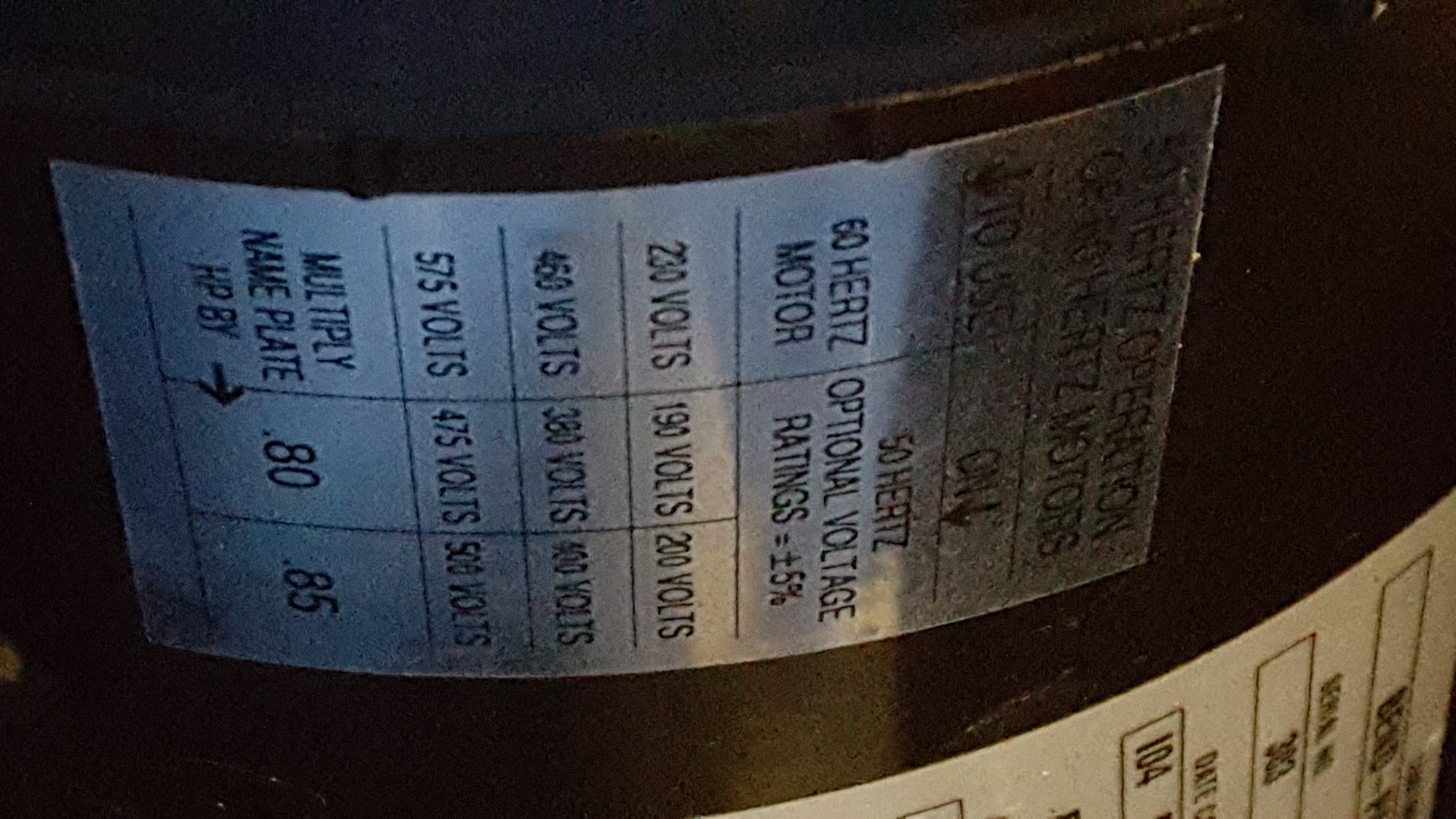

Not likely I am afraid this is also a US motor so for optimum use in the UK would require a slightly reduced voltage.Just found this sticker on the motor does this mean it will run at 240 single phase
Its 2HP as indicated on the motor data info in your photo, so 1.5Kw But you might be better off leaving whoever is going to fit and convert to order whatever brand of VFD that are most familiar with.Van anyone work out what HP it is so I can get the correct vfd

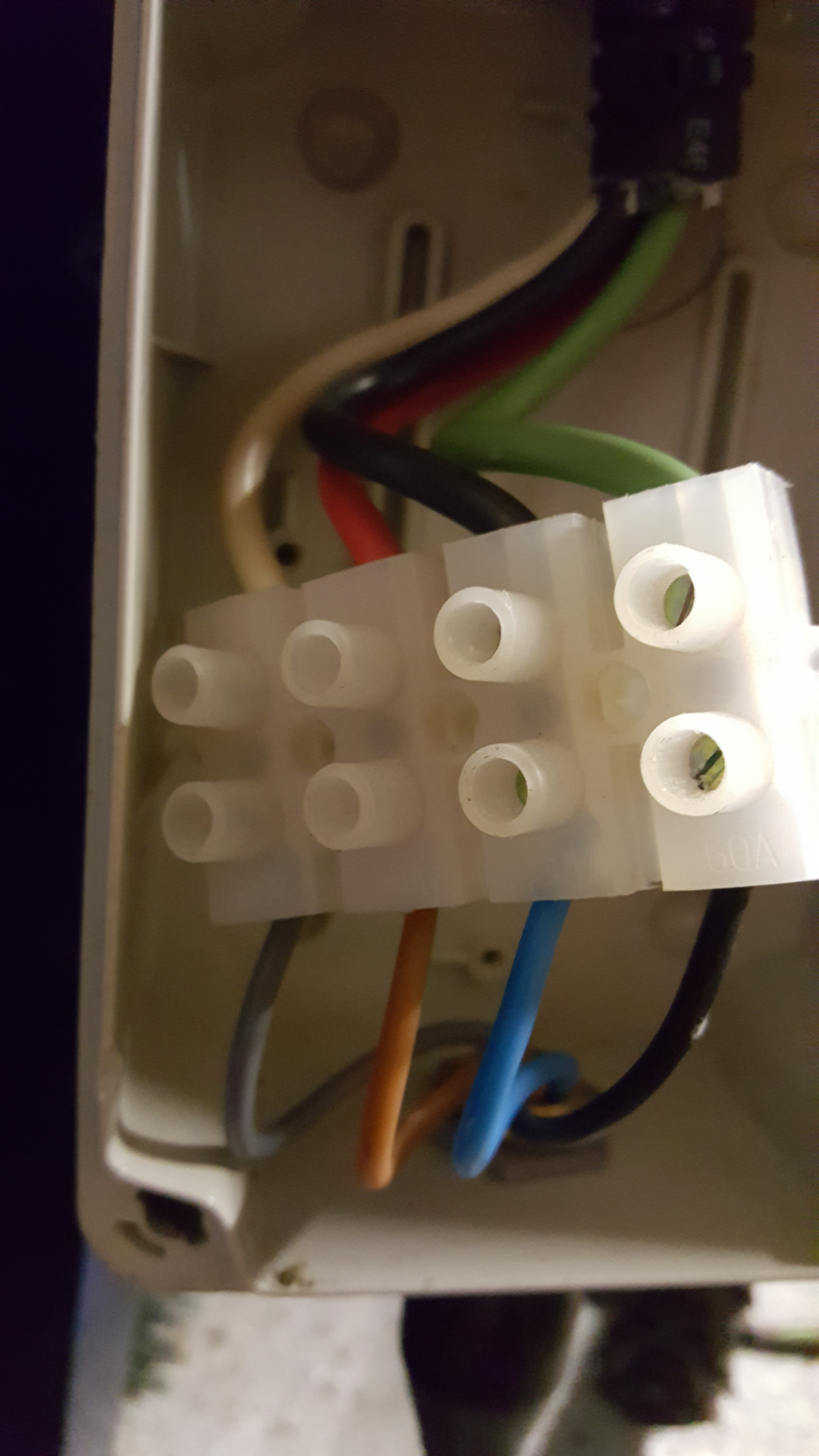

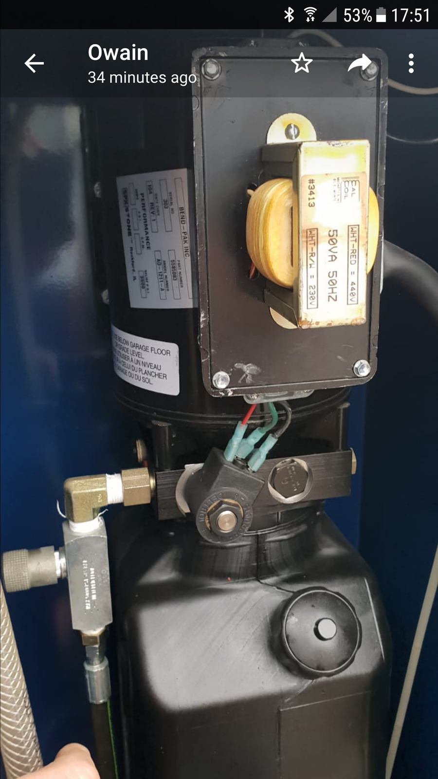

If you have a 16a or> supply as it might not like the stop-start on a 13a also you need to confirm the unit does not require a neutral, probably won't as it has the 415/230 transformer then yes it should be ok. You will need to make sure your control transformer is on the correct phase, not the artificial leg.
