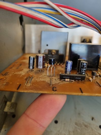

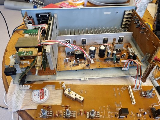

It's a Sony TA-F120, my dad bought it around 1990 so no wonder it need a bit of maintenance.
It's only very slightly faulty, works just fine as an amp but the indicator LEDs on the front panel have stopped working. It sat in the loft for years and when I plugged it in for the first time the LEDs initially lit but quickly faded out.
The LEDs are supplied 15v and connected to ground through an NPN transistor. I spent ages following the traces by hand to figure that out before I thought to look for a service manual.
There was no +15v supply to the front panel, turns out the joints on the regulator has cracked, I reflowed them and the LED's briefly lit and faded out again. Presumably then the transistor is busted (Though I'm not sure how to test it. I swapped it with the first NPN I could find, with the leads twisted to match the pinout. Again the LED's briefly lit and faded out, I assume that means there's a problem elsewhere that's cooking that transistor. There's no evidence of burnt resistors or leaky electrolytics, nothing I've probed has drifted far from it's original value.
The service manual shows this:
So do I measure it within a minute or after ten minutes?
The second I turn it on the points measure about 3.8mV, once it's all warmed up they measure about 12mV.
