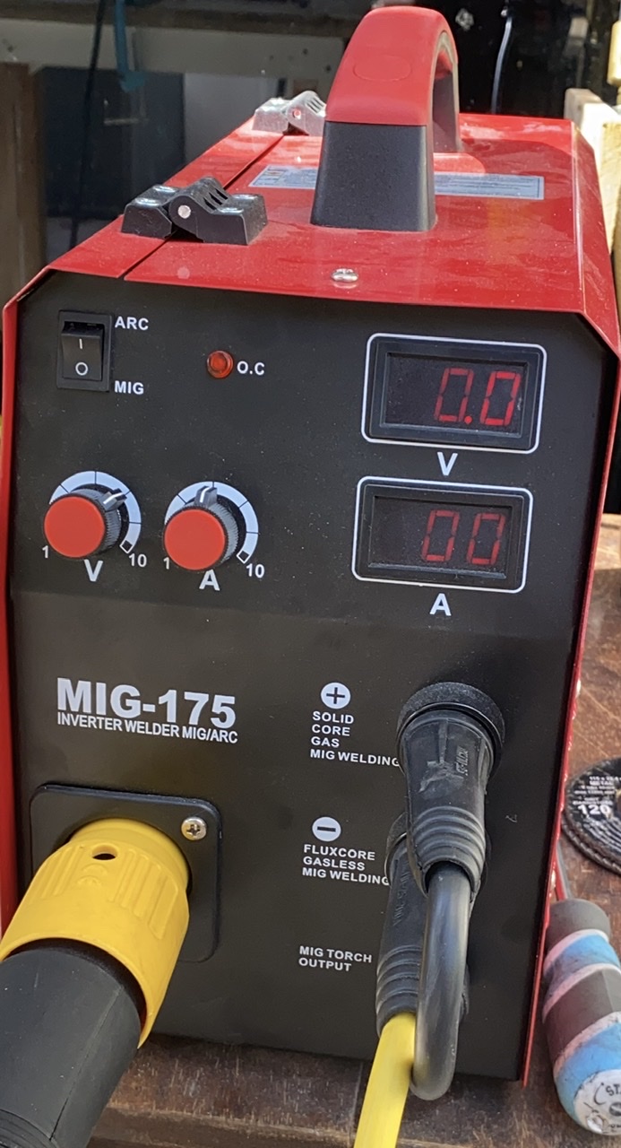

    41A4F80A-5677-4FCB-9FF7-7C02A69778AA.jpeg Best laid plans.....
    So the company who was getting me the technomig couldn’t get it, and now no other supplier can either, so I bought a £100 Chinese MIG 175
    Practice began today
