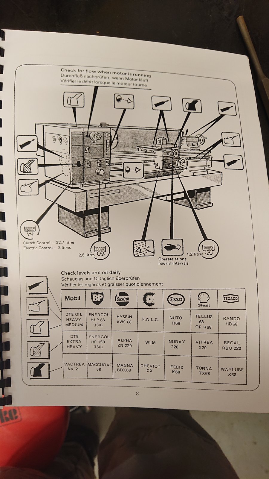

    Hi guys. i'm changing the headstock oil and gearbox oils on my m350.
    I've drained them, then flushed them out with diesel and finally cleaned the bottom of the headstock with rags and kitchen roll (amaze's me how much c##p and filings do be lying in the headstock).
    The last time I used high quality 10w/30 tractor transmission oil just because I do have gallons of the stuff. Even though it seems to work well, with no obvious signs of wear and a nice quiet running headstock i'm just wondering if someone could advise me of the correct modern oil grade that should be used.

    ISO68 cheap as chips

    paging @scottmk1 to give you the official spec

    Here is what the book says.

    ISO 68

    Thanks guys, finished lathe today iso 68 in headstock and 220 in both gearboxes Just like book says. Thanks Scot for specs.

    ISO 220 in both gearboxes... are you sure?

    Feed box and apron

    Not in the apron, it's going to be hard work pumping that onto the ways.

    OOPS!!
    My bad, at first glance I thought the oil can symbol for apron gearbox was grey (iso 220)
    But its actually black which would mean 68 (as my old school report cards used to say "must try harder")
    Should be no harm done as although I had run the lathe unloaded, I didn't pump oil up to saddle.
    I'll drain the 220 out off apron gearbox this morning, good catch daedalusminos. Thanks.
    Quick question would standard iso68 (white oil can) be alright for slideways or should I look for an iso68 waylube (black oil can)
    as specified?
